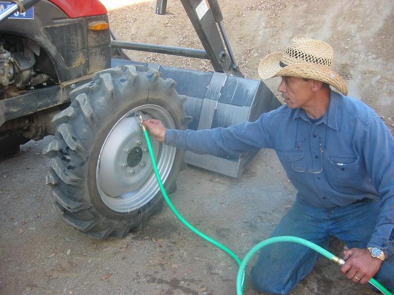

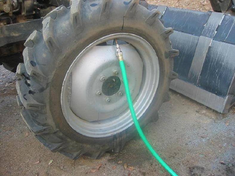

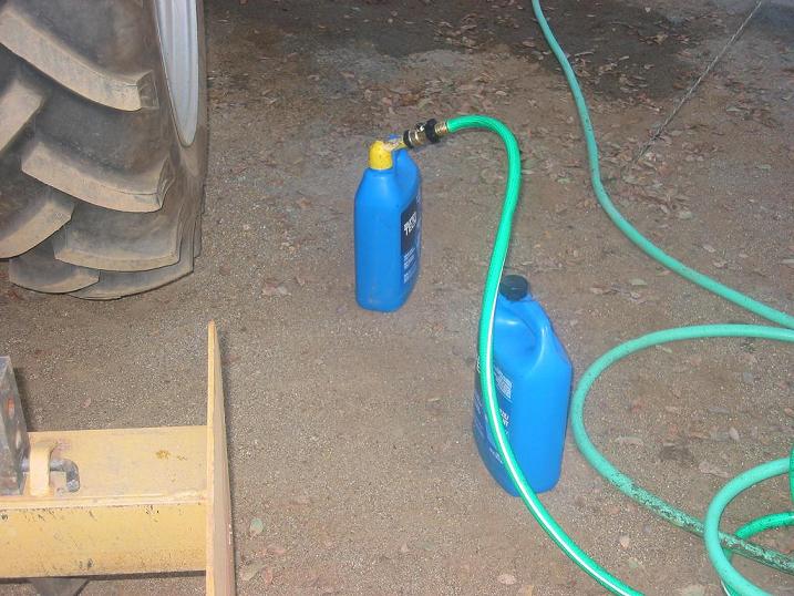

Well, I used the "Tractor Ballasting" article produced by the Department of Agricultural Journalism, University of Wisconsin-Madison. I added anti-freeze and water and tried to get the front/rear weight distribution as they recommended for 4WD tractors.
To get equal amounts in each tire, I measured by having the fill valve at the top of the rim and bleeding off the excess water. The trick is to keep the inflation pressure up somewhat while doing this so you know the inner tube is round. Then I made sure tire inflation is equal at about 16psi.
I did the same for the rears except kept the fill valve at axle height, since I wanted to get the weight distribution somewhat near the chart recommendations. By the way, the valves on the rear are on the inside of the wheels, making this about ten times harder to do than the fronts! I have 14psi in the rears.
Finally, I checked to see if the "footprint" and slippage tests were near the recommendations. I was pleasantly surprised to feel some minor difference in the ride and traction. Feels very stable. I may change the psi in the tires once I use them on the job to see if different pressures give better results.

A picture of bleeding off excess water for balance between tires.
