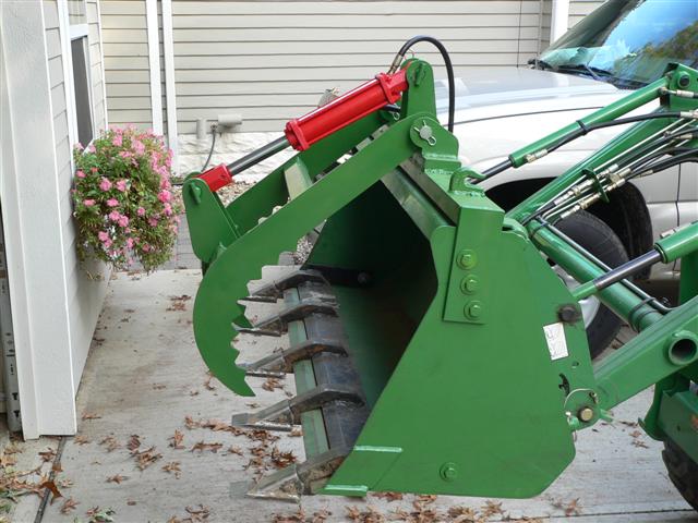

I recently completed a grapple setup on my JD 4110. I purchased the grapple from Andy Tatro. I fabricated a mount to attach it to my bucket. I bought a Fasse diverter valve that came with a momentary switch that I mounted to my loader joystick. Special thanks go to kennyd whose setup I basically copied and who answered a lot of my questions. /forums/images/graemlins/smile.gif Following are a series of pictures. Jason

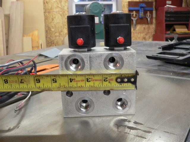

The Fasse valve I used can actually be ordered through Deere. It is part # SW700-1592. As I mentioned, it comes with a switch and instructions. It costs about $310.

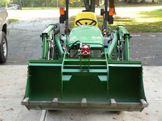

Here is the valve mounted to my loader mast.

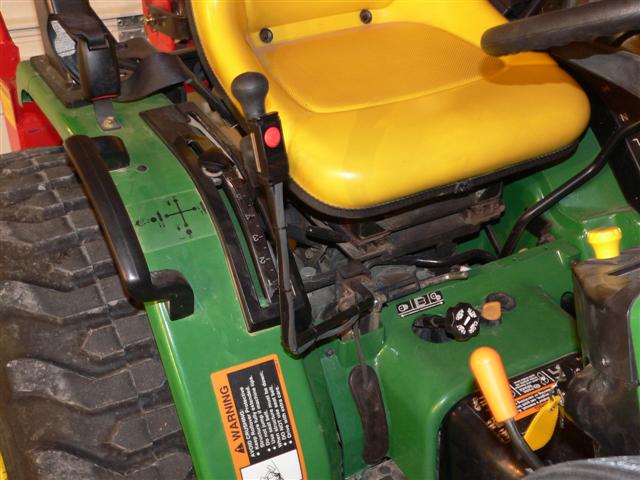

I mounted the switch on the joystick and zip tied the wires.

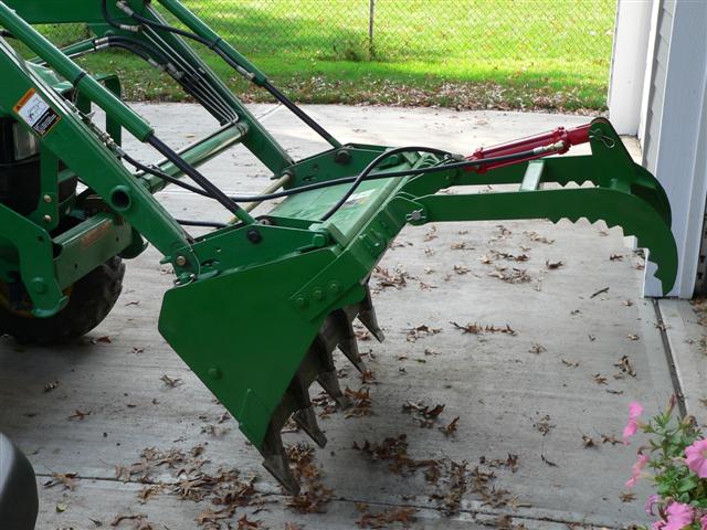

Here is a picture of the grapple extended.

Another grapple picture.

I had a lot of fun with this project. I've only used the grapple a little so far, but already I find it useful. BTY Fasse was a super company to deal with. I got technical advice with just a phone call and no wait. Their website appears to be under construction, but you can get some info here Fasse Valves

Great job Jason, I will be getting with you and Kenny in the spring when I get ready to that. First I want to get my power beyond set up with top n tilt and a valve for angling the rear blade. BTW just where does the fassevalve get its hydraulic flow from?
   / Another Diverter Valve/Grapple Setup
#11
I just ran hoses from the tilt and curl (bucket) into the valve. Then there are four ports coming out. The hydraulics work normally unless the switch is depressed, then the flow is diverted to the new circuit. When the switch is released, everything returns to normal. BTY- Thanks for the compliment. Jason
