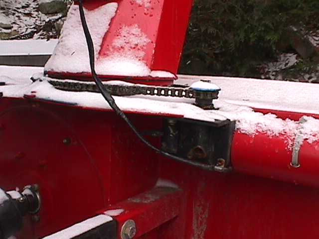

I have a 5' blower mounted on the 3PT of my Mit180D which I converted to electric .
Was lucky and found an electric wheelchair drive motor.
Being geared down for torque at low speed it was ideal.
I fitted a sprocket to the shaft and wrapped a matching chain around the snow shute with a screw to tension the chain.
Spead is just right and enough torque to break loose from ice.
Paid $50. for motor and $12. for a suiutable sproket.
You might consider the import electric winches sold on EBay for ATV,s at about $50 or so as they would provide correct speed and suitable torque.

Better late than never.
Wheelchair motor installation on snow blower shute.
The motor body (right) is covered with a 6" length of 4" PVC pipe (painted red) and held in place with tye-wrop.
Reason was to provide a 'rain hat' for the motor's protection.

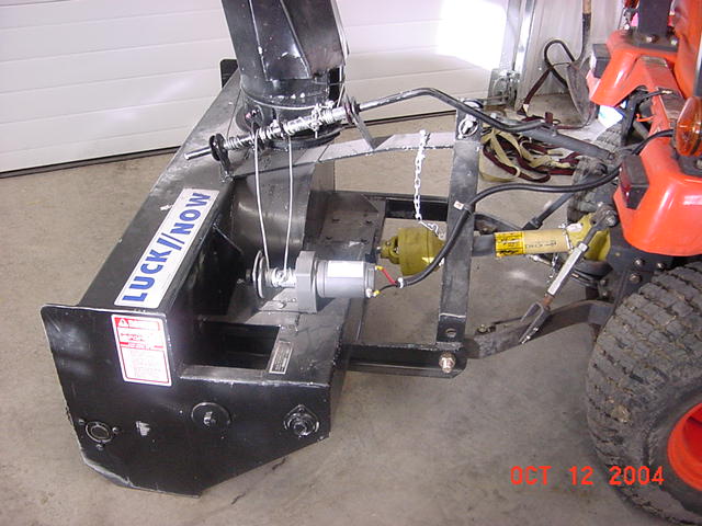

I mounted a cheap winch in conjunction with my manual chute crank. It works well and hasn't given me grief. It took a little trial and error but I'm happy with it. I like the idea of an actuator for the top of the chute.......it never ends

And this one

That is basically what I suggested in my earlier post, only I would have eliminated the manual crank and cabled directly from the shute to the winch making the system more direct and probably with a better response. Fore sure there would be less slop in the system.
In your installation I would place the winch approximately in the middle of the brand name stencil sticker on top of the blower body.
To help the cable wind evenly you could install 2 'roller fairleads', say, 3/8" bolts about 4-5" in front of the winch. They would be about 2 1/2" long and would have say 1 3/4" pieces of 1/2" pipe to act as rollers. The bolts would have nuts on both sides of the blower body to lock them firmly in the upright position.
Otherwise you were on my 'wavelength' using the ATV winch as power source.

Agreed Piloon, I did make things probably more complicated than needed, the only benefit I have here is that if the winch quits for whatever reason, I can put it to "freewheel" and operate it manually with the stock crank. My system does allow for more slack than I would prefer. Aux. hydraulics would be sweet, but I have no other use for them other than on my blower.
