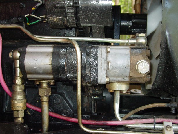

Ron,
It does have an engine driven pump, see attachment, with (2) sides / sets of impellers. One side (front/rt side in pic) that drives the power steering and the other side (back/left side) that powers the FEL. Not sure if there is a pump in the sump casing that drives the 3PH. I do know that the PTO does NOT have to be running to raise the 3 PH. At least, I do not do anything special such as engage the PTO to raise the 3 PH; typically leave the PTO disengaged. I just pull the lever. I will test when I top off the hydraulics – make sure the PTO is disengaged and raise the 3 PH.
From my research, it appears there is a large piston that provides the force the raise the 3PH. I have not found any mention of a traditional pump inside the sump. The parts diagram does not show a pump. I thought the piston was being supplied pressure from the engine pump – could have misunderstood.
I'm with you in that I believe its leaking into the gear case. The engine oil level looks good. As others have mentioned, I want to top off the hydraulics again and very closely monitor the levels. I need to drain off some of the tranny fluid though before I do anything – it’s about to overflow the fill cap - the reason I believe it’s leaking into the tranny.
Trying to avoid pulling the hydraulic case – looks like a pretty intense job. But, it’s looking more and more like I will have too.

Eddie,
I have the 2005 454 model. I am sure it has only the double hydraulic pumps that run off the engine. No other hyd. pumps. Like you said, front one runs the power streering and the rear pump runs the 3pt lift and on mine the ZL-40 FEL. The rear hyd. in/out pipes run into the lift box. Must be leak between cases. Please let us know what you find.
camman
