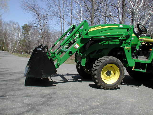

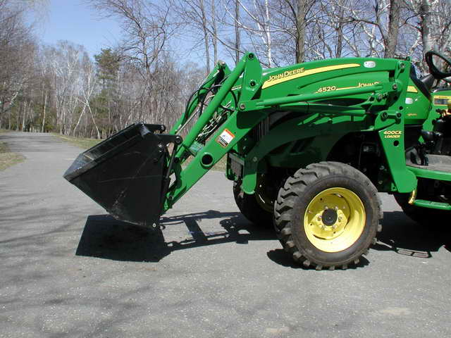

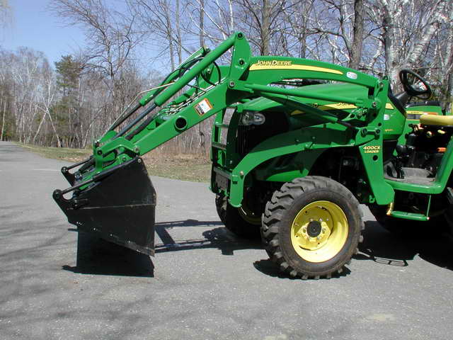

Actually, you gain dump angle as a CX raises up - the parallelogram rolls the bucket forward relative to the loader arms to keep it at the same angle relative to the ground. What you lose is curl (rollback).
I've attached 3 photos of my CX with the 4n1, you can see the angles at level, fully dumped and fully rolled back. Hope these are of some help.
I am re-roofing some sheds, so the self-levelling was of moderate importance as I use the loader to lift shingles and stuff up to where I'm working. But I agree with others that the increased capacity is the biggest reason to go with the CX.
Tom.

   / 400x vs 400CX ... Help! #8
400CX fully dumped
T.

   / 400x vs 400CX ... Help! #9
400CX fully rolled back.
T.
