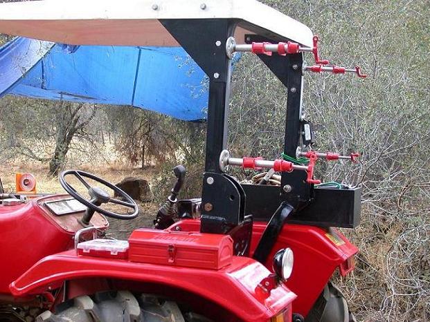

It was dealer mounted so I don't know anything about the joystick. I want to add a bucket mounted grapple such as I've seen on other posts where it is necessary to add an electronic switch, another cylinder and valve to run the grapple. If my memory serves me right, the joystick has a place for an elecrtic button...perhaps to add a function to it? Not sure about this so I will take pictures this weekend and post them.
My question is this: Can I use that joystick if it allowing me to switch to grapple use when I add another set of valves for the grapple? Anybody know? If it seems like I don't know what I'm talking about it's because I don't know diddly about it...but not too embarrased to ask. I'll post more when I get back with more pictures. Here's a (poor) picture of the joystick in the middle of the photo. Maybe some help to start?

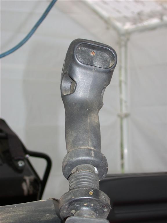

I got a photo of the joystick this weekend. You can see the the inserts covering one large spot on the front view and 2 smaller spots on the sides. Are these likely locations for the switch? Are there switches that will fit one of them?
