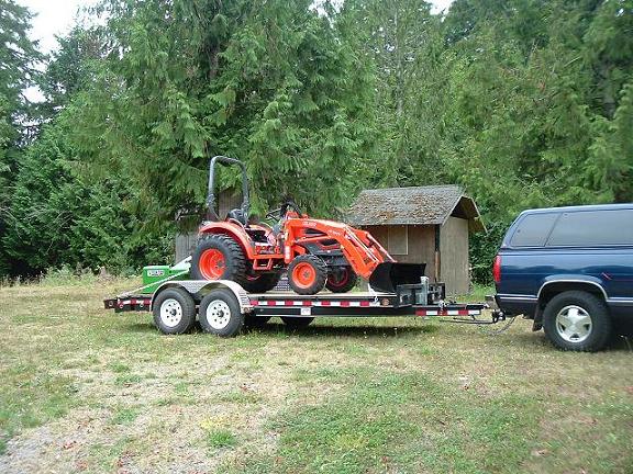

You'll need at least a full size half ton to tow the CK30 but you will be better off with a truck with somewhat higher ratings. A lot of this depends on whether you are buying a truck to haul the CK or if you are trying to check to see if what you have is adequate. I already owned my truck and had it set up to tow a travel trailer so I knew what my ratings were and had made a few upgrades. Buying now to tow the tractor regularly I would love a 4 door dodge diesel just for a nice extra margin.
I tow with a 98 chevy 1500 4x4 and 5.7 liter engine. 265 factory HP and 330 TQ. The tractor weighs 4500 with one implement and my trailer weighs 2500. Yep, 7000 lb trailer. I have weighed the actual load and get just under 6500 on the trailer axles and 6500 on the truck axles. I tow just fine and have no trouble keeping up with traffic and under control. 11 mpg towing.
I actually enjoy the tow and it is part of the process of a full day tractoring. I need to bring at least one five gallon jug of diesel to endure that I don't run out of fuel during a full day's work.
