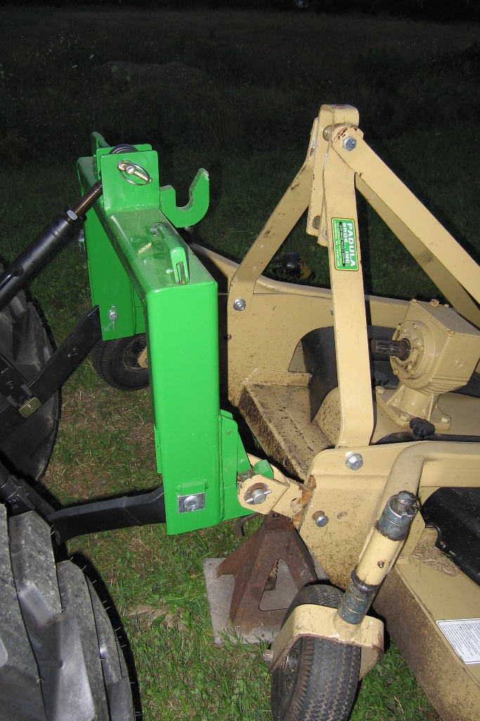

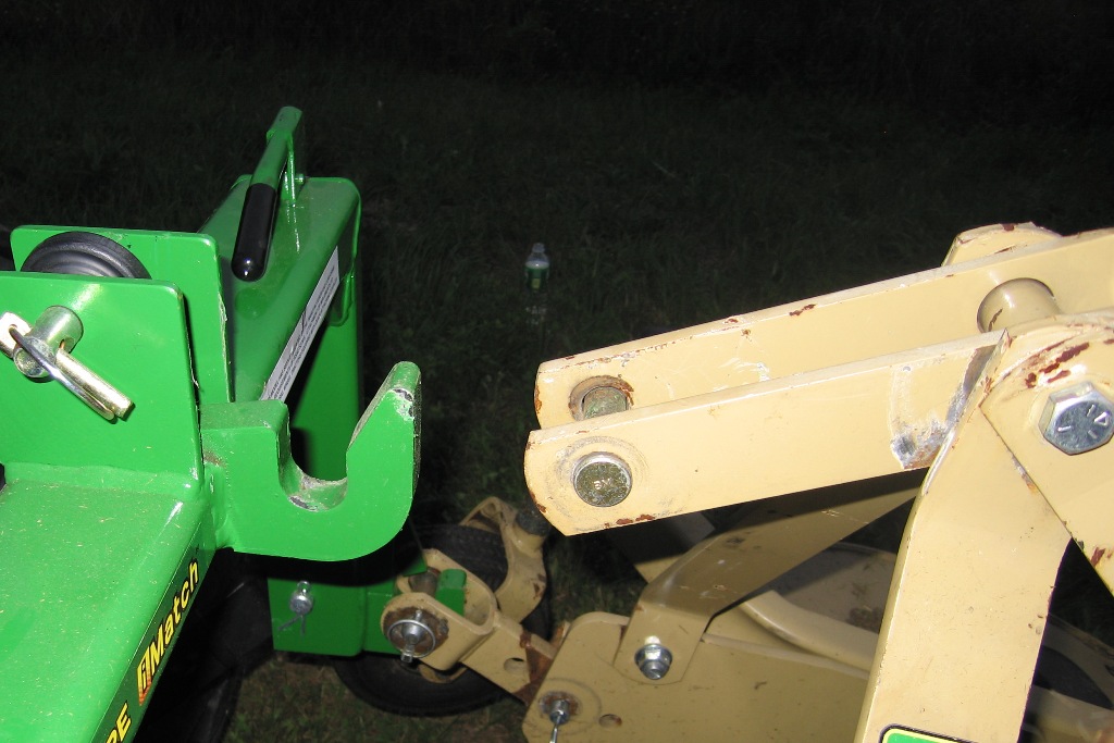

My tractor just arrived today along with my I-Match. I tried mating it up to my RFM. The lower links seem to match up fine but the upper link seems questionable. What prevents the upper link of the RFM from popping out of the upper hook of the I-Match? Am I missing something? Do I need a bushing kit for the lower and upper pins?
Does anyone have a picture of their I-Match connected to their RFM, especially a Landpride?

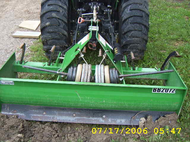

This one looks, unfortunately, too high for the imatch (not having had one/adjusted one).:(
JD/Frontier are now labelling what stuff is imatch compatible, so checking out the spacing to the toplink/lower arms on your weight box should give you some idea of spacing they are producing for the i match...
I don't know if the pic I attached is big enough to see, but spacing for the BB2072 ("imatch compatible") seems like space between lower arms is roughly equal to lower arm to upper i match link spacing (front bushing below where my toplink is attached is intended for the i match I believe).
Transporting large distances would be the only drawback I would think leaving the toplink off... gauge wheels on the 2572 look plenty rugged, for that matter.

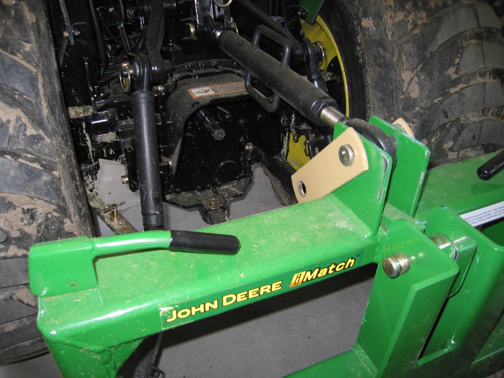

I purchased the Landpride Quick-Hitch Floating Top Link Assembly Kit, P/N 320-013A, for around $26. It seems to do the trick. You have to get off the tractor to pin the top link but you need to get off the tractor anyway to hook up the driveline so it's not a big deal. This is still a whole lot easier than doing it without the iMatch.
I will probably be adding a coat of green paint to the top link kit so it goes better with the iMatch. ;) I also need to get different lower bushings. The ones I have are meant for the top hook of the iMatch and seem to be smaller than the lower link bushings.
I also purchased the Front Roller Assembly (Anti-Scalping Roller), P/N 310-254S, for around $75. I installed it tonight and it seemed to help but I was still scalping in some places. I still need to grade my lawn in certain areas.
I will try to post some pictures of the setup this week.
   / Landpride FDR2572 & JD I-Match

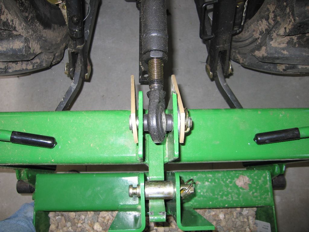

Here are few quick pictures of the Landpride Quick-Hitch Floating Top Link Assembly Kit, P/N 320-013A. It's a very simple solution. The kit includes (2) top link bars, (1) clevis pin, (1) flat washer, (1) hair pin cotter and (1) spacer bushing. Someone could easily make the bars if they chose to. Let me know if you would like the dimensions.
The attached pictures are of the top link bars in the stowed position. The one nice part is that they stay out of the way when they are not needed. I will post some pictures with the mower attached the next time I use it. I think these bars will work on my rotary cutter as well but I have yet to test it.
