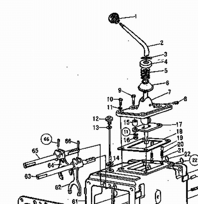

Or - you could have just pushed the shift finger down farther into the fork rails. Take a look at pg 35 in your parts manual. Insufficient depth of that finger on lever #2 (into fork #62) may have been what tore your rails up in the first place. Locate screw #8, it's hiding under cover #6. I know this book doesn't specifically cover shuttle shift models, but this particular diagram is representative of the problem you describe. Part #8 performs an identical function; it is a set screw that limits up/down travel of the lever #2 against spring #5. Alternatively, you can bore a new hole for pin #3. Before I had even a dozen hours on my KM454, I had to release that set screw - and shove the lever down to the limit of it's travel against the spring tension, then dog the set screw back down. Been just fine for the last 200 hours.
Good work curing the symptoms. But from what I read, you may still have missed the cause.
//greg//

Thanks guys, that sure cured the problem and made it shift better without that hesitant "grab" as before.
I checked to see if the depth was not sufficient and if that was the primary cause, and it wasn't the problem. Otherwise my repair would have popped out too, if the lever wasn't deep enough into the slot.
In Greg's attachment, the part he refers' to ... #62 has that slot on the top of it. That's where the engagement takes place between the 2. Imagine if the end of that slot, the vertical walls, had a 45° angle cut on them to the bottom of the slot. So the vertical walls on the end of the slot were missing. The side of the ball on the shifter lever was barely making contact with those angle walls and they had worn down to allow it to slip past.
From the photo in post #2, you can see where the lever was skidding sideways around those 45° walls. The manual does not show that slot with 45° walls on it, rather it is shown straight up and down. The 4x4 lever slot walls were not like the shuttle shift. It was like the manual shows, straight up and down. Funny thing is that the angle part looked like it was cast that way. I see now that in the photo, the walls don't look angled...you can't see it in that view very good, but those are on a 45°.
