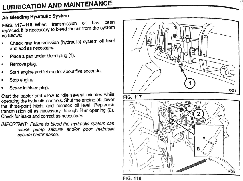

So I'm going to try it, the only question I have is about bleeding the system. The guide makes it sound pretty simple but not too clear on instructions.
I think I located the bleed screw, can anyone confirm?

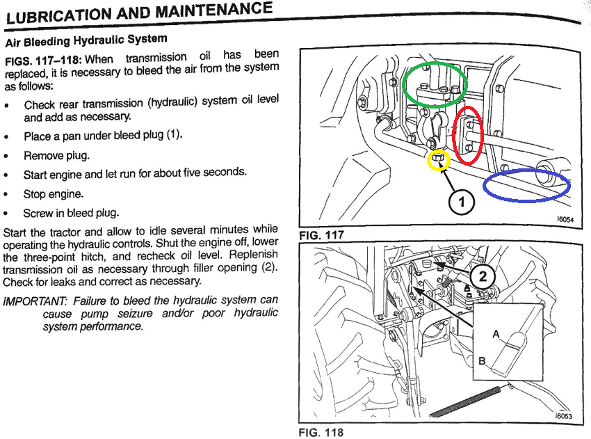

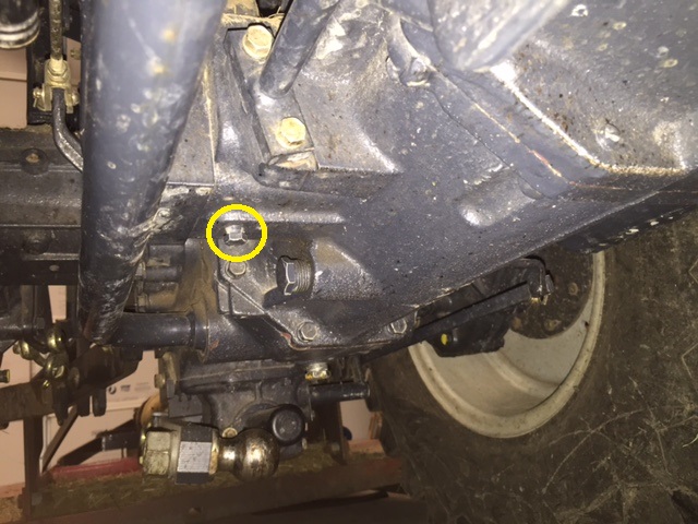

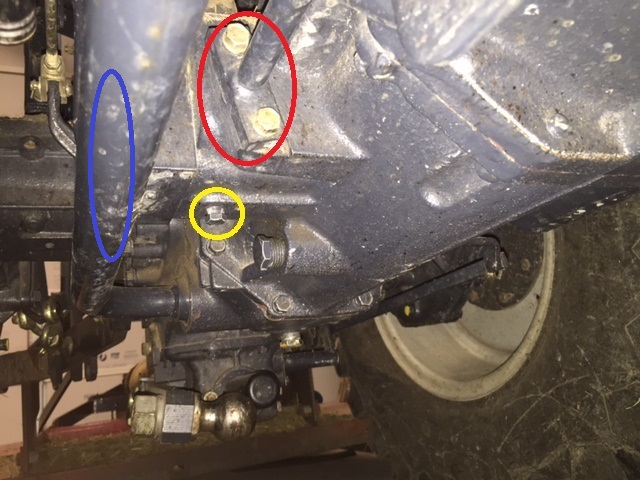

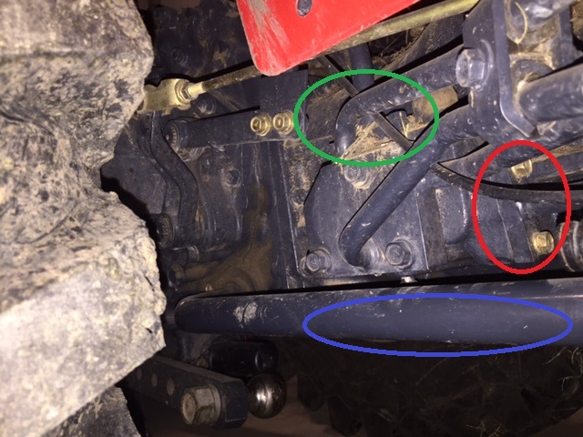

The diagram doesn't exactly match up, but some of the items do. I've circled them in matching colors...
