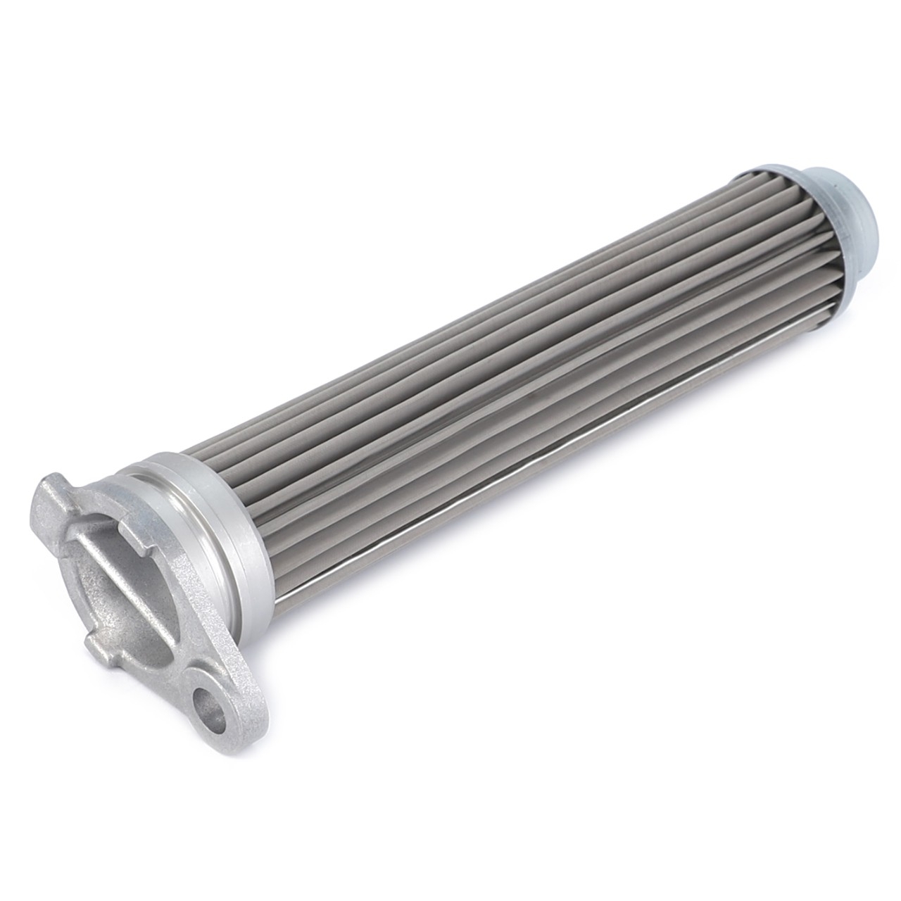

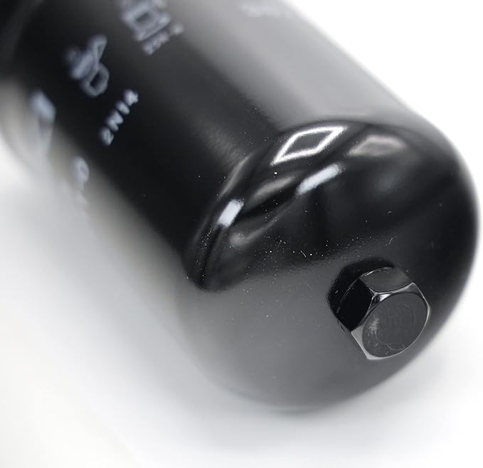

I recently purchased a 1740m HST cab model. In anticipation of performing fluid and filter changes I'm finding the manual and the on-line parts book somewhat confusing as to which filters I need.
If anyone has performed this maintenance I would really appreciate some help with the part numbers of the filters I will need.
I believe I need a # 7069738m91 for the hydraulics but there is mention of a second spin on filter for hydrostatic drive but I'm confused what that part number is. I realize there is a suction screen/filter but does anyone know if the hydrostatic version requires a second spin on?
Also, it appears the first hydraulic/transmission fluid & filter change isn't due until 250 hours. Can someone confirm as my last Massey, a 1532 HST, required this maintenance at 50 hrs as I recall.
