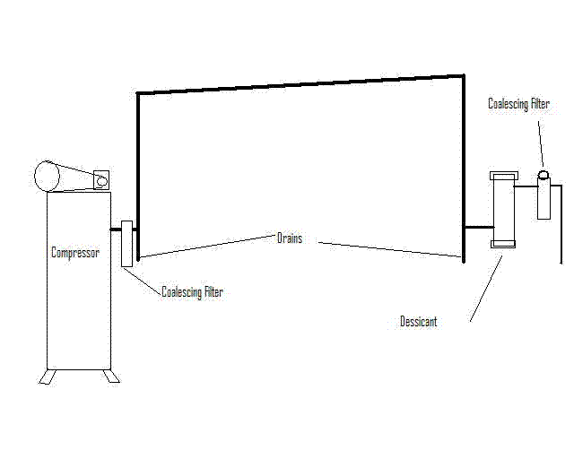

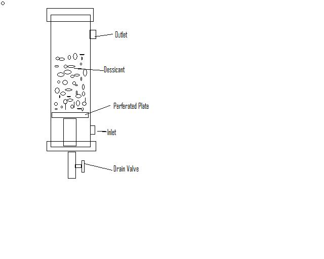

I use 2 coalescing filters and a dessicant filter on my system.One Coalescing filter is just after my compressor. Then comes my dessicant. Last thing is a coalescing filter with my regulator. My system is hooked up with black pipe and this helps alot. My dessicant is about 40' from the compressor, so the air has cooled quite a bit by the time it gets there. This helps the separation of water. All my lines are sloped and i get as much water out of my lines as i get out of the filters.
If you go with dessicants, you can build your own filter out of a large (6" dia.) threaded pipe and end caps. Get the good dessicant from a pneumatic supply, it changes colour when its wet, and its reuseable (dry in oven) .

What is a 'coalescing' filter?
A big problem w/ my setup is the water sep is way too close to the tank. I like your idea of angled pipe. Is there a drain trap in your system?
A coalescing type filter is a typical water separator. Its basically a membrane of different pore sizes depending on air volume and how "dry" you want your air. The water falls out of the air as it "squeezes" through the pores. That combines with the air expanding in the bowl creates the drying effect.
Having your filters on the end of a long run will help their efficiency alot due to the cooling of the air. I have drains on both ends of my line.
I wouldnt go with a refrigerated dryer unless you have to. My air is plenty dry for painting and sandblasting. Refrigerated driers work great, but they can be kinda spendy.
