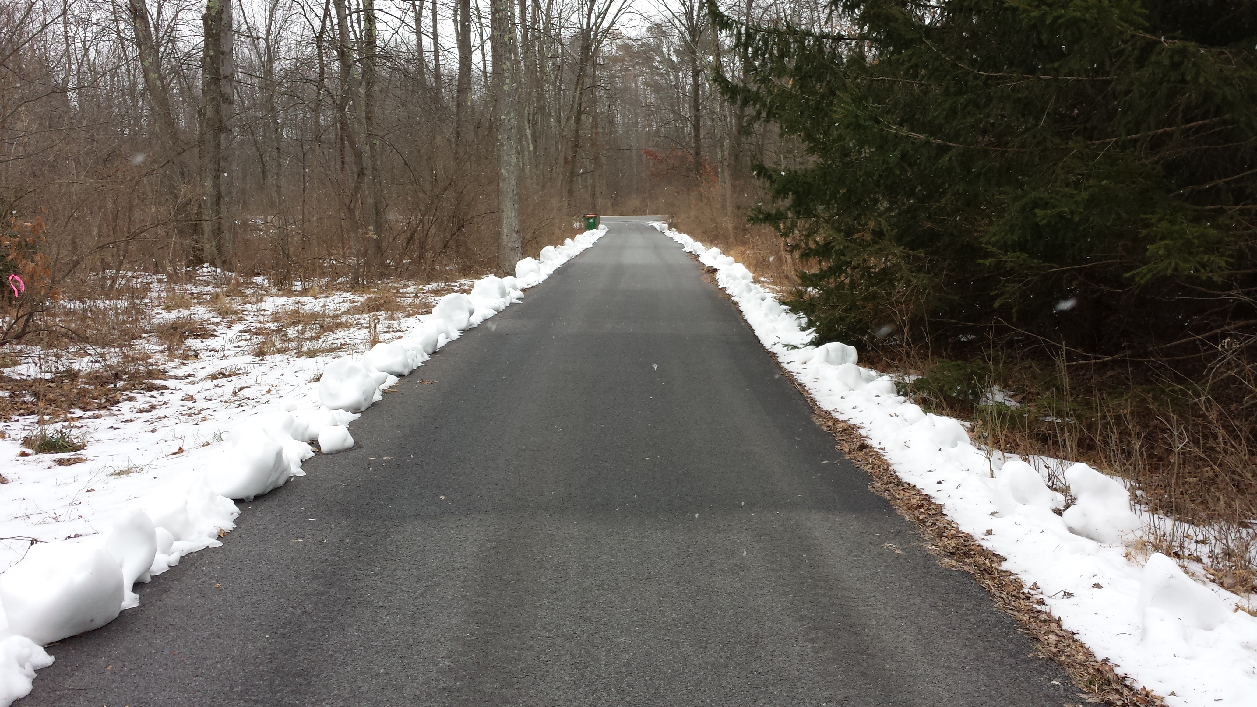

Ok, on a more serious note, my conclusion is that to melt snow/ice effectively, you need to get that chemical to every square micron of surface area. The town/state can get away with using "rock" salt, because the hundreds/thousands of vehicles driving over it crush and redistribute that salt. However, on a home driveway, very little of that happens. So the smaller the initial granule the better. I have been using an "Ice Melt" product which has a maximum size of about 1/8". Far, far better than the "rock salt" at our local store that is mostly 1/4" up to 1/2"(!!) dia. If I could find cost effective "table salt" I would use that.

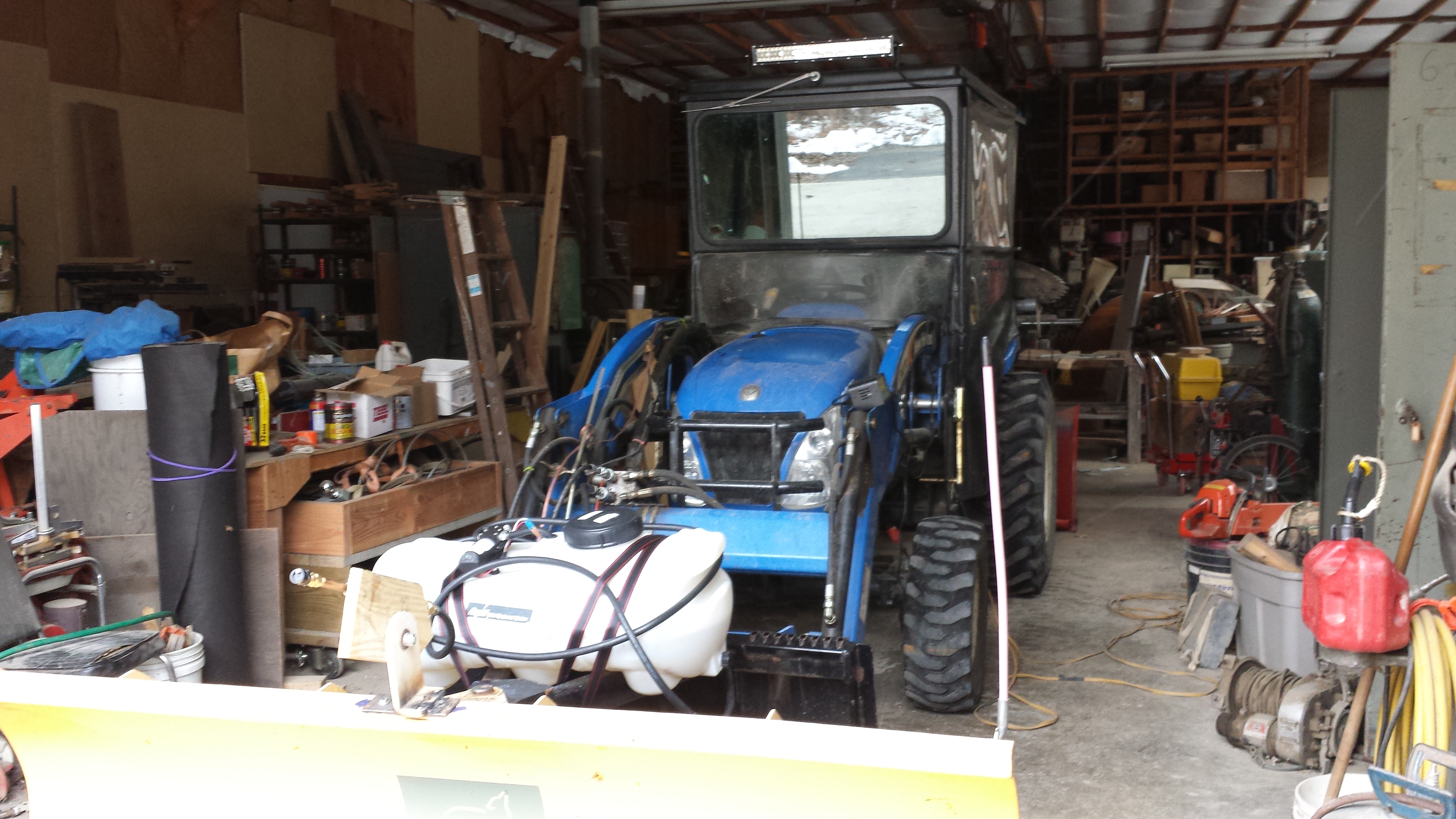

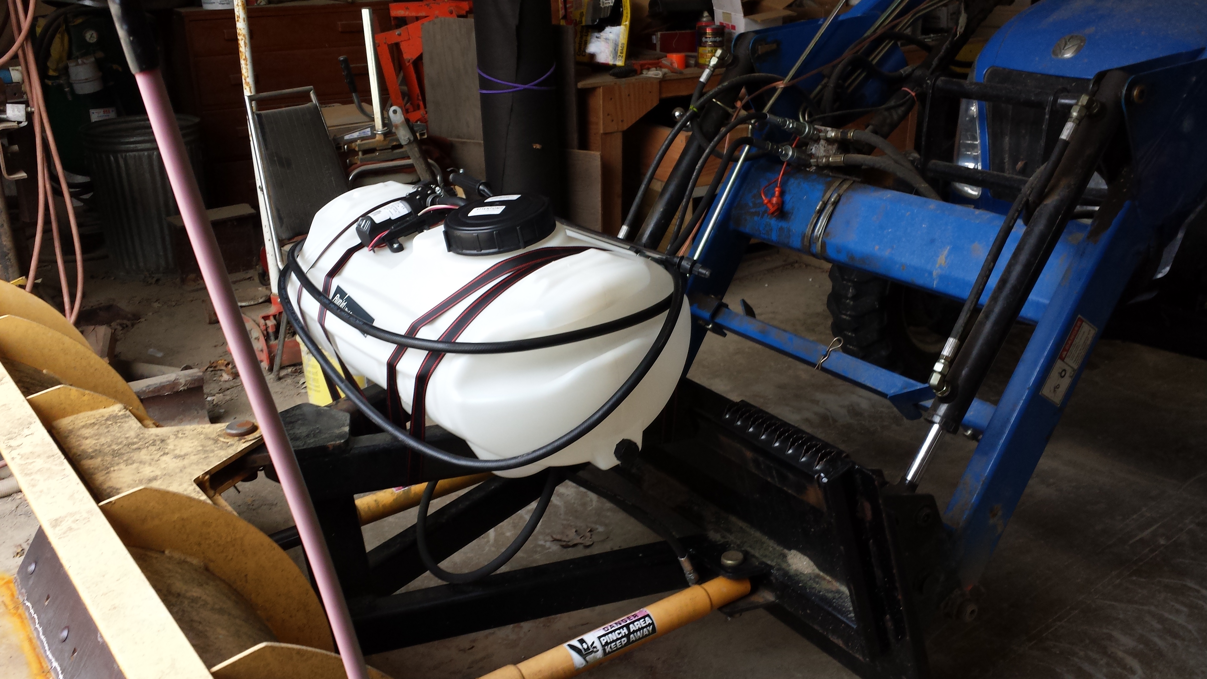

Based on the above, I can see that a liquid product could be very effective. I have found that even with granulated product, having it in place before the snow falls is very effective in after-storm clean up. While I hate Hate HATE the slushy roads we get from the town/state dishing out salt at the beginning of the storm I genuinely appreciate how quickly the roads clear when it's over.
