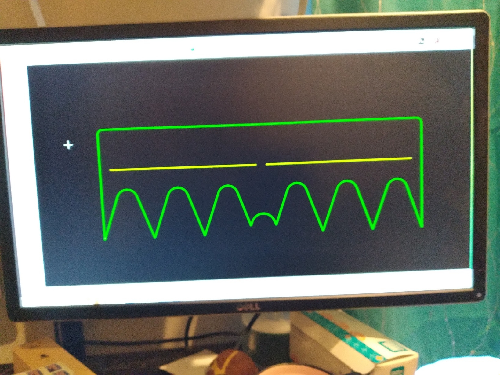

So, I used a friend's Rake, in my mind it sucked and was way too $$$$
I had some old leftover metal and went into cad and did some drawing

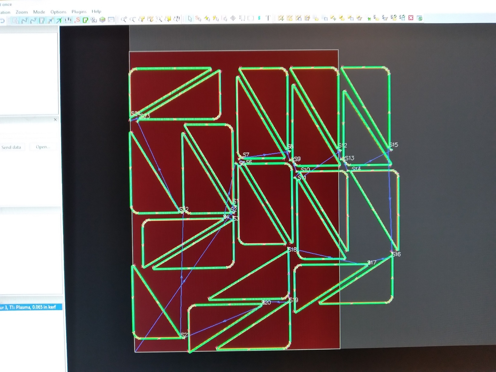

Put it into sheetcam

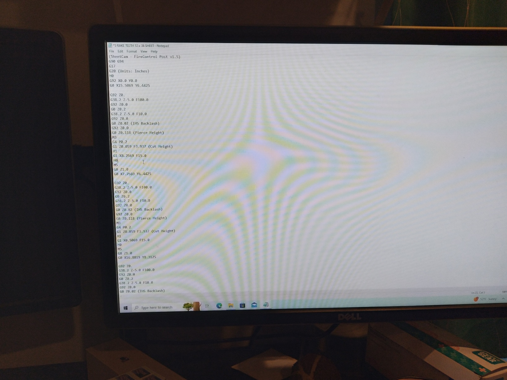

Generated my G code, added my G92 X0.0 Y0.0...

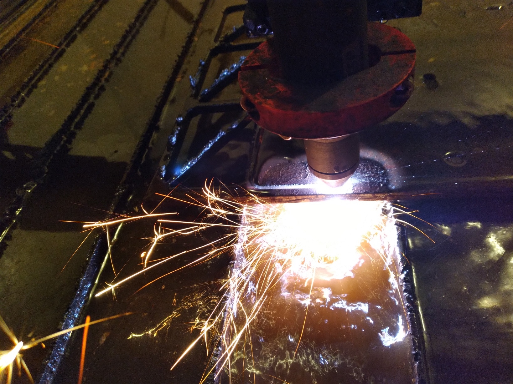

Next?....make sparks...

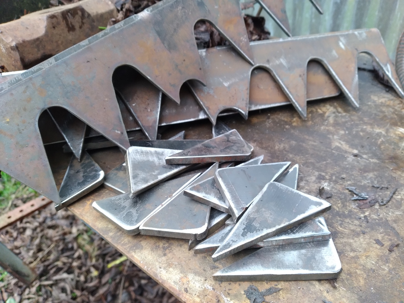

Well, ended up with these pieces,

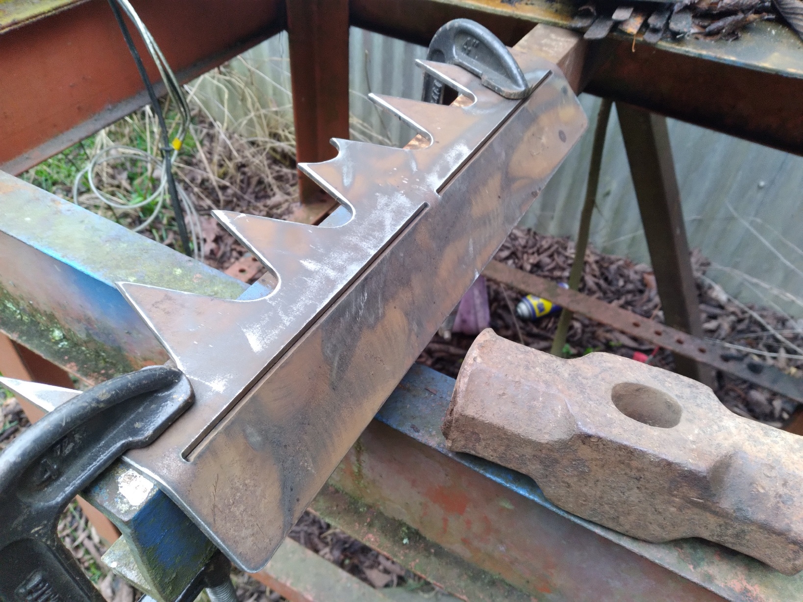

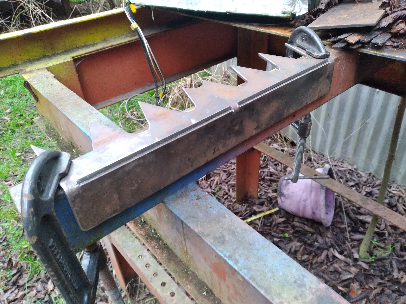

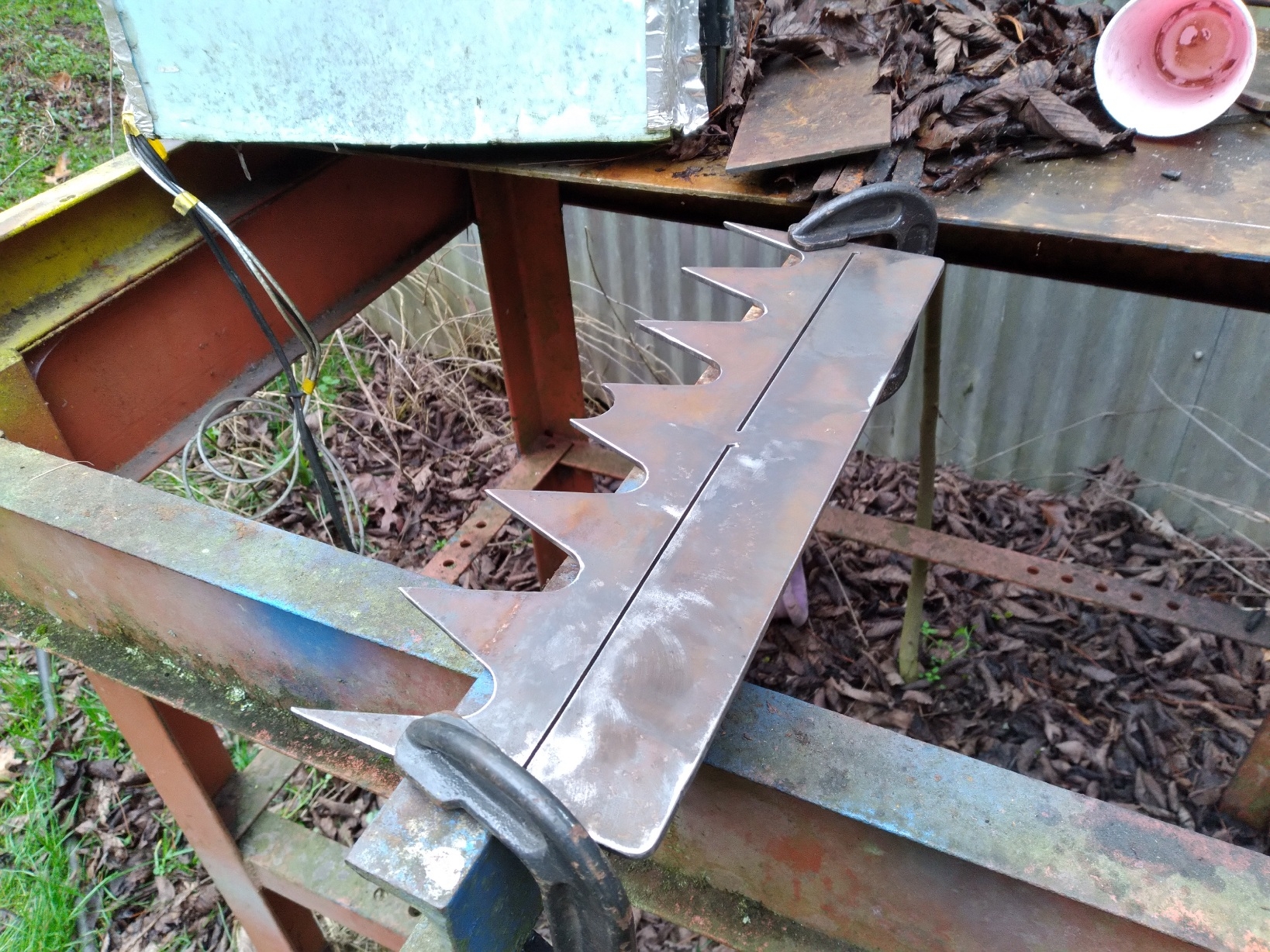

Had to bend them 90*

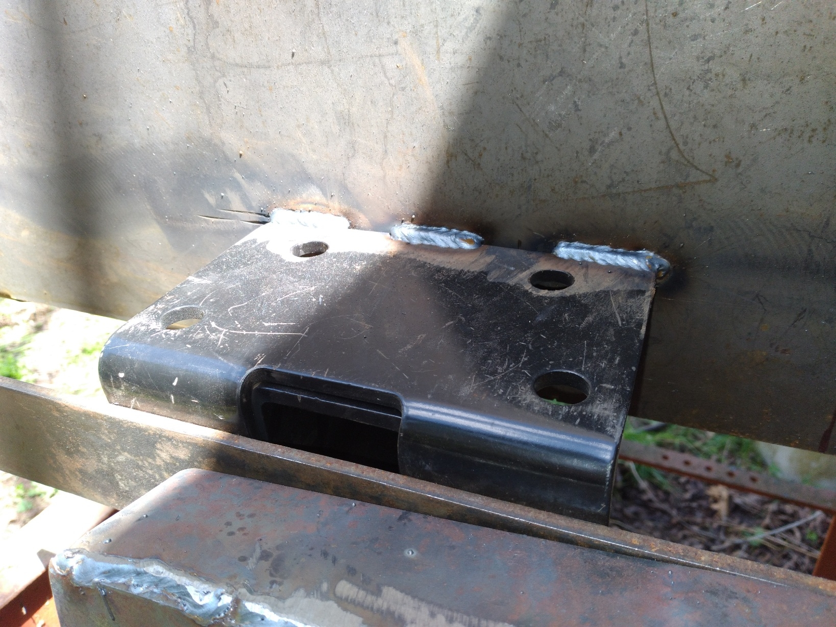

Dropped bucket (1st time)easy, test fit 1/4" QR back plate.
Gosh, it's amazing what 2 years does on your welding skills...
:oops:
They are ugly but good flow, they won't break doing this

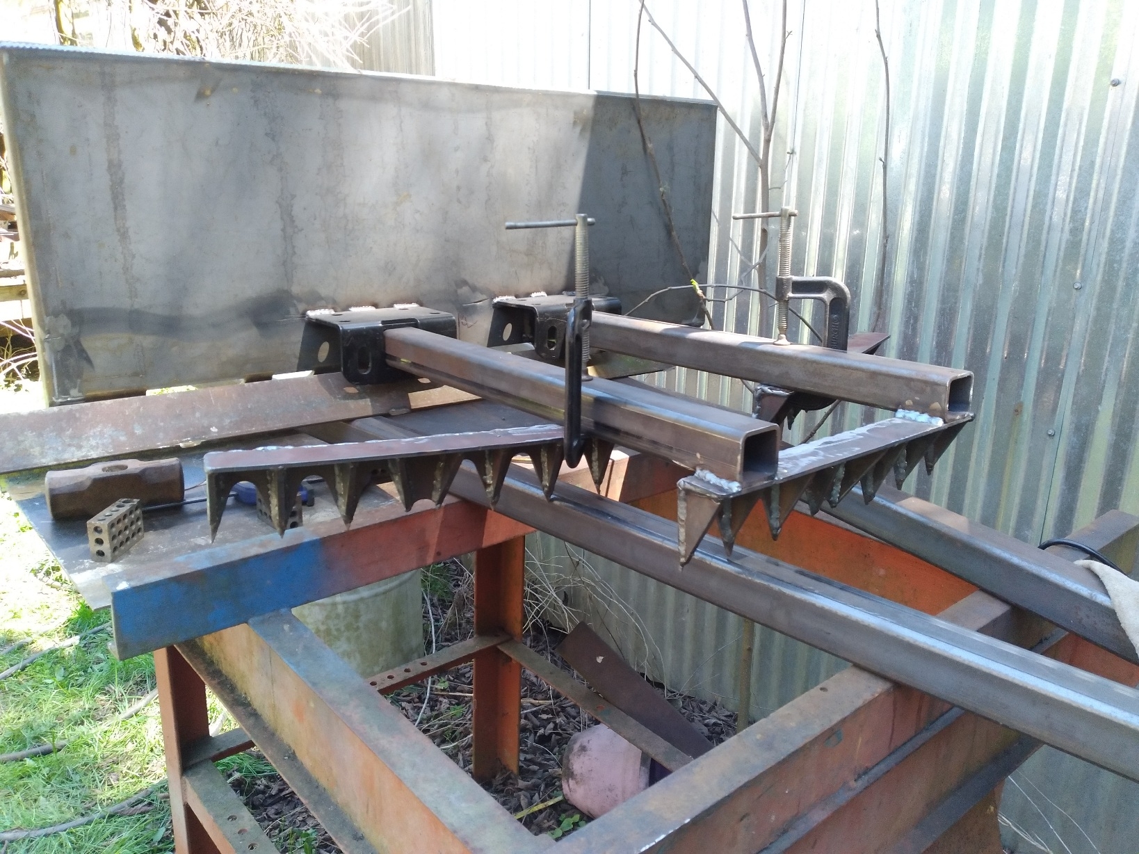

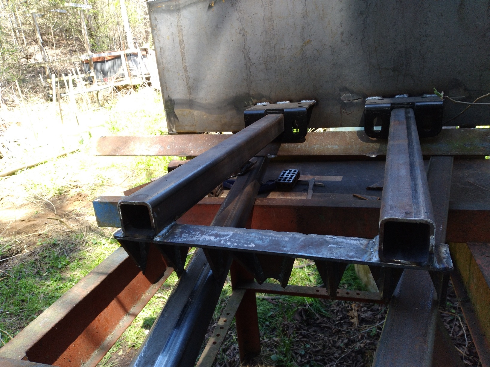

Got 99% done yesterday, still need to drill hole for pins.
Mounted the 2 receivers, this will allow me to remove the Rake and also I can use a 2-1/2 PC of tube to extend these 6 more feet.
I grinded off the angle I used to move chicken coop.
Main legs checking alignment
Front teeth mounted
Added the rear teeth
