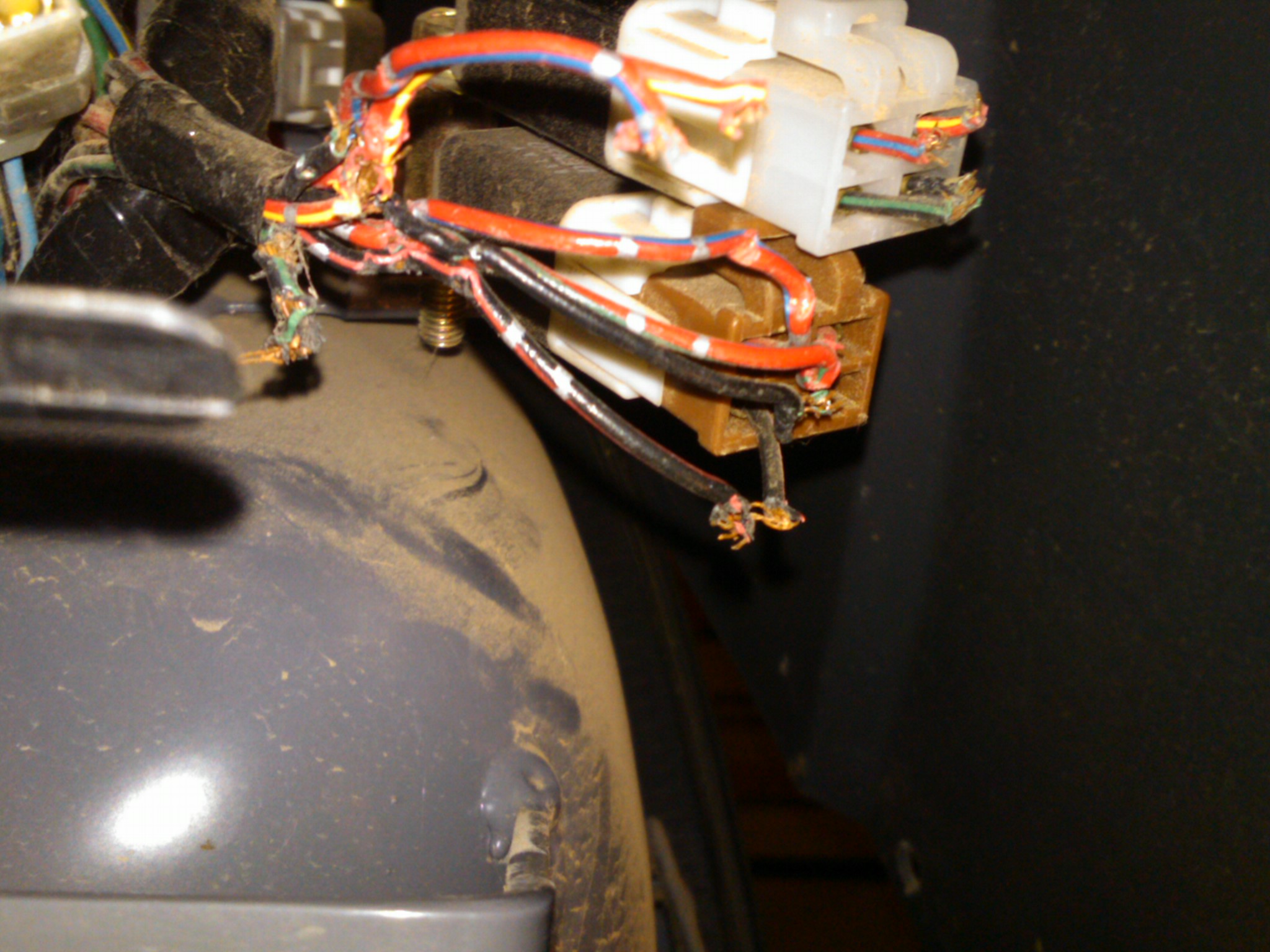

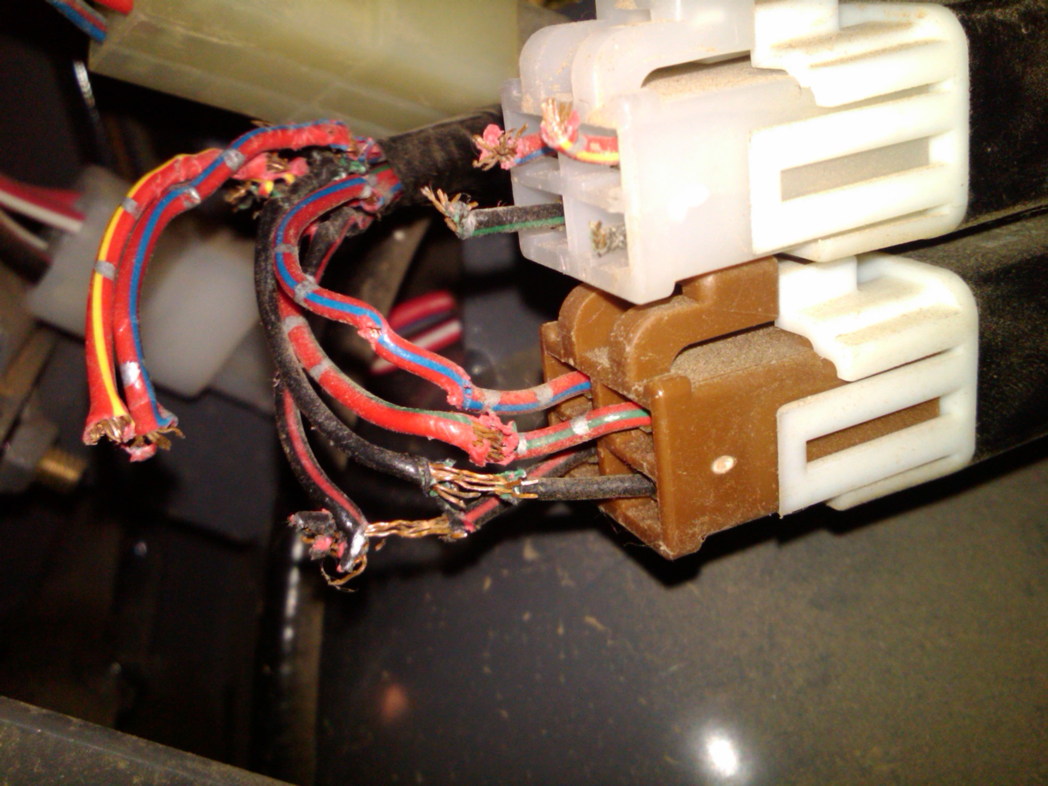

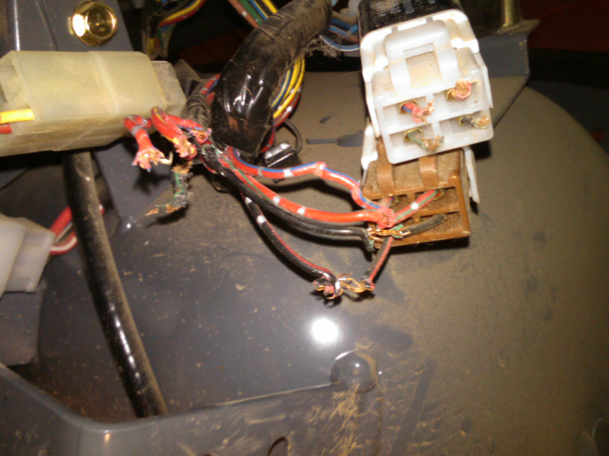

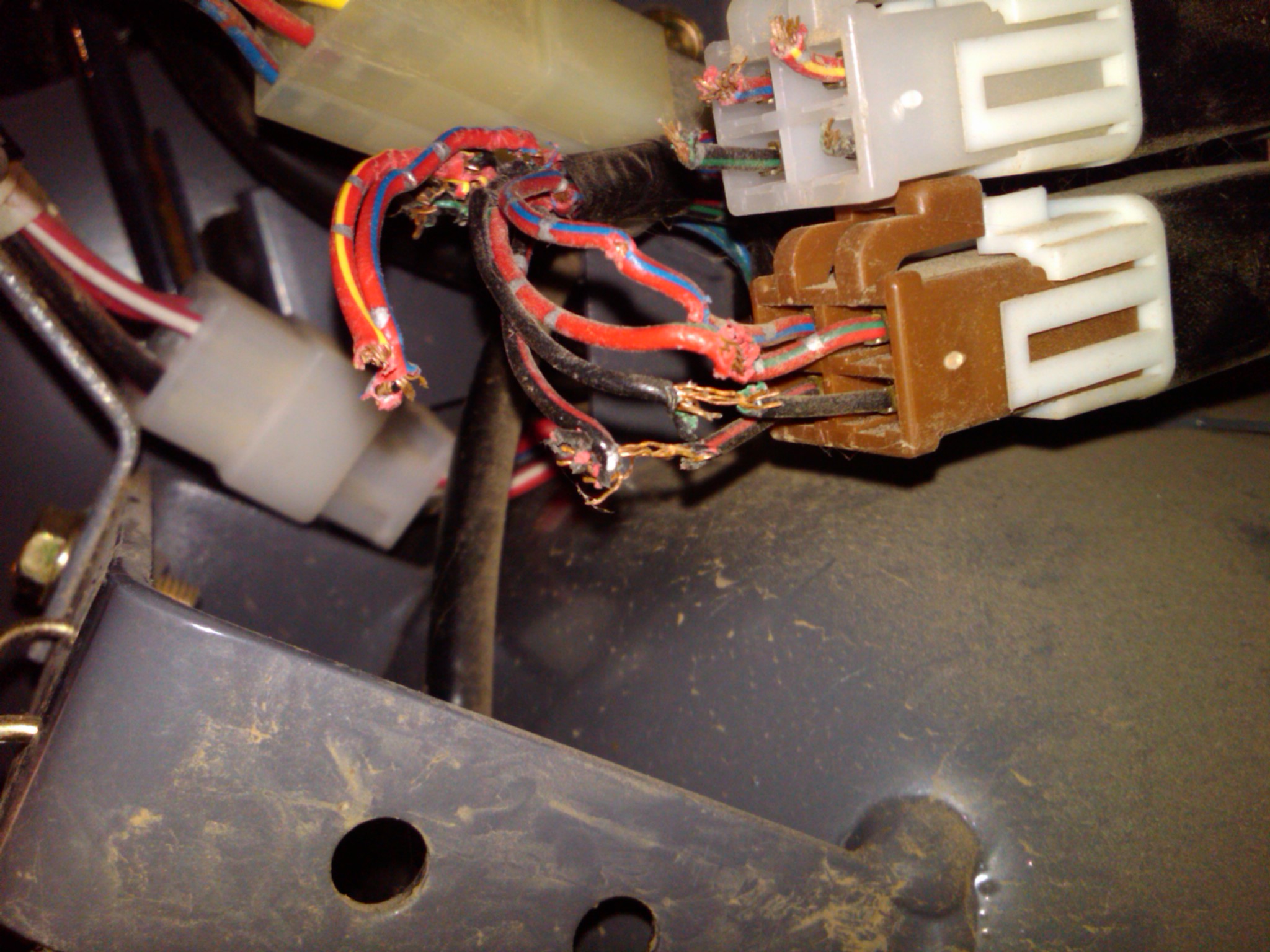

We get 7-8 inches of snow by the time I get home to start moving it, including a mile drive/plow to the 4-lane hwy to plow the median so the Mrs. can get across to get home. Just as the light subsides I pull out of the garage and go to hit the lights and... nothing. The turn signals give just enough light to work for an hour plus. Headlight fuse is blown and I trace down from the schematics that the relays are just not acting right by electrical test and grounds. I pull the dash (1533) and this is what the connectors at the headlamp relays look like; excuse the cell phone quality.
It's always something... The upper relay is missing about two inches of wire, the bottom four are almost severed. No where else are there signs of damage. Any suggestions for a fix? I don't think there's enough wire at the connector to solder some extensions on.

Looks like enough wire to me to solder back together. Might need an extra hand to hold the two wires together and another extra to do the soldering.
At least to get going again.
Some mouse poison around is in order. Usually there is a nest near or over the wires they chew.
Good luck.

Seriously, You may be able to get the metal portion of each conductor to come out of the molded plastic connector. That would give you a little more to solder to. I have remove the conductors from similar plastic connectors in the past and then been able to reinsert them without any problems.
Good luck!
   / Not Much to Explain... Mice #4
It's doable. Are those spades in that plug ?
You'll have to pull the plug and peek to see what retains the metal piece in the plastic.

I have made a lot of these kind of repairs in the body shop over the years. Crushed, and damaged wires, & connectors, are pretty common nowadays.
That type of connector came from the automotive industry. If your lucky, you can find ones to splice in there in an automobile salvage yard.
We replaced an occasional wiring harness in the body shop, and often had several damaged ones laying around that we would scavenge parts off of. Checking your local body shop for possible replacements that they may have laying around, is also a possibility.
Finally, if all else fails, you can solder the wires right to each other, and right to the relays, sensors, bulbs, etc. It is really quite easy, if you can solder, and have a steady hand.
Of course use shrink tube, and liquid electrical tape, where necessary.
