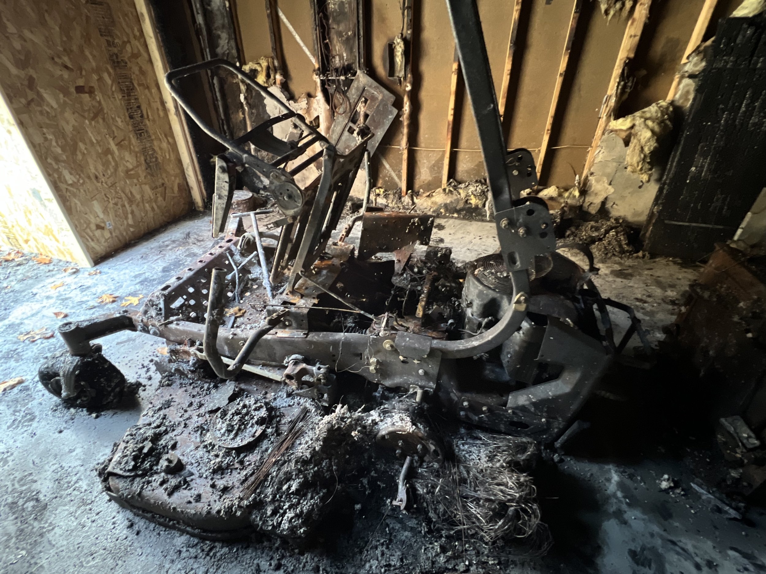

I find this alarming. My house just burned down a couple months ago. The investigator was very interested in the John Deere zero turn I had… here’s the photo of it after the fire.

From the provided photo it looks like the mower was the primary ignition source. I bet the fire investigator was interested.
