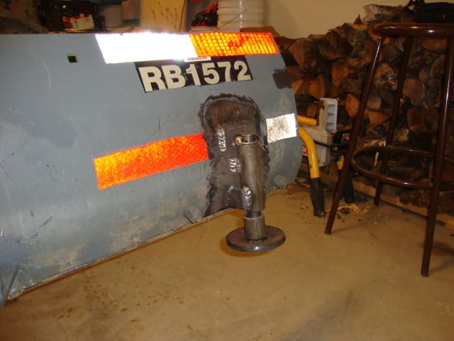

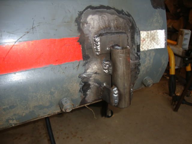

I spent part of the day adding skid shoes to my rear blade, snow can't be far off now.

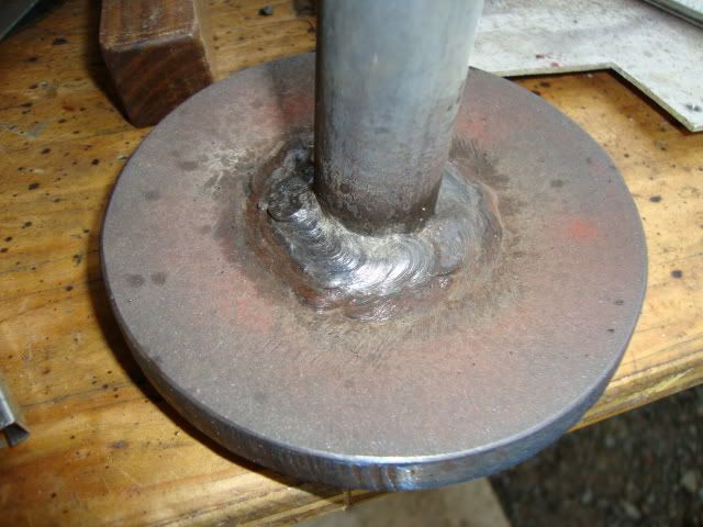

3/8 plates, dished 3/4 inch, I used 1/8 inch 7018 at 115 amps DCEP. It's the first time I've used the larger 7018 rods with this welder, I'm pretty happy with the way they worked.
The rest of the job was done with the Miller 180, my out-of-position welding still isn't that great with the stick, I have more confidence in my abilities with the MIG. Still getting a fair bit of spatter, but that may be the wire I'm using.

Before you know it your welding will be looking like laid dimes...nice beefy well done job. :)

I'm learning to control the puddle a bit better with practice, every so often there's a "light bulb moment".
Thanks Thomas, I think it'll hold up to the 3400 at least.

Nice work. How did you dish the plates? Hydraulic press?

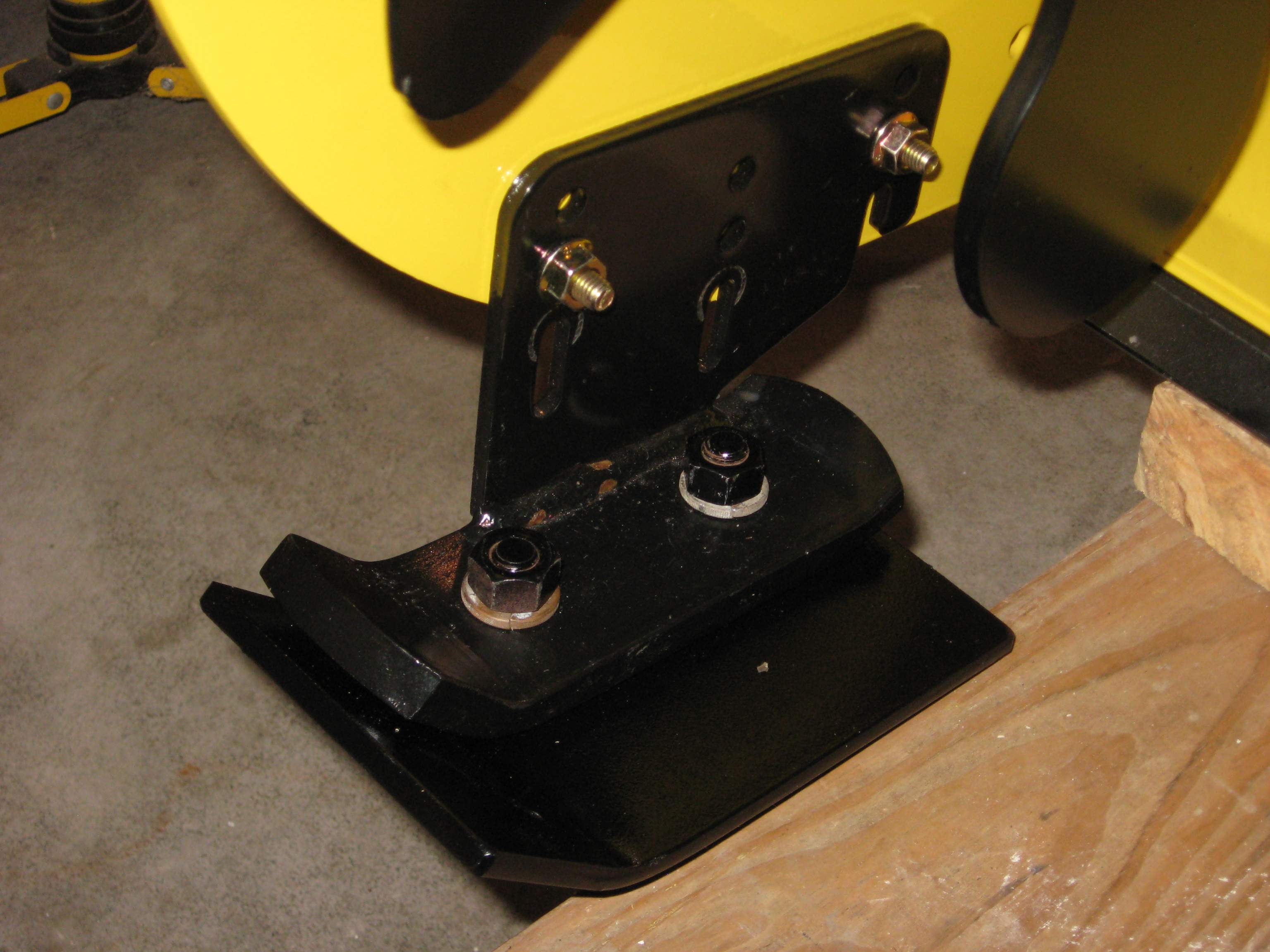

I just made some "overshoes" for my snow blower skids. The standard skids are a little narrow, 2 inches, so I bent some 4 inch wide plates and welded on some bolts to attach them to the original skids.
Hopefully she'll slide a little easier with the wider skids.

Good job! You won't have to worry about them wearing out any time soon. Next you will be building side plates for it. Wish I could weld that good.
Hydraulic press.. I have access to a 75 ton press at work. It took about 40 tons to get that much deflection, with the outer edge of the disc supported in a piece of pipe.
It's surprising how fast they DO wear out, I'll probably end up hard-facing them during the winter unless we don't get much snow.
I try to get as much practice as I can, I've learned quite a bit from the guys here. I hadn't stick welded in 25 years, picked up a used AC/DC a few months ago. I find the MIG is easier to use for doing verticals and overhead welds.
I built wider skids for my walk-behind blower a few years ago, it was fine in soft powder, but wanted to ride up on the snow in heavy wet stuff. A tractor blower should be heavy enough that you won't have that problem.

It's hard to say, a lot depends on the diameter of the disc and the size of the contact area. My pipe was about 4 inches in diameter or a bit less, and the contact area was 1.5 inches. It made a nice even curve for the most part. If the disc was heated it would be no problem at all to cup it provided you got it to the press quickly enough.
