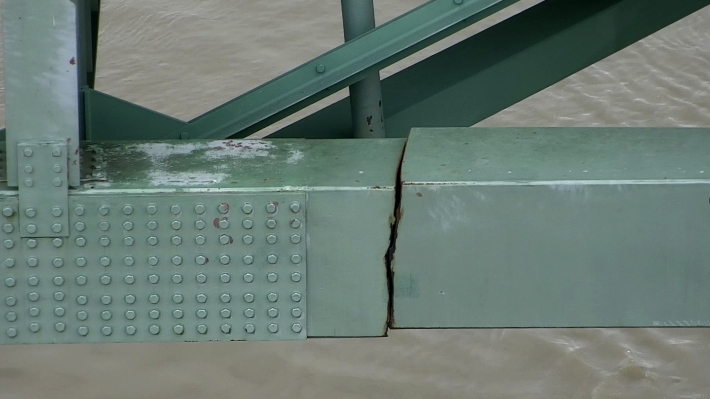

Who to blame? Probably whoever was supposed to inspect it on a regular basis, or did not inspect it in a thorough manner and missed the impending signs of failure.
Probably a combination of corrosion and metal fatigue.
At least they caught it before it collapsed and killed people.

I can't tell from the photo just where this memeber is located,,, just the same, does not look like it rusted away to me.
   / Who Broke The Bridge? #5
Right Arlyn - looks more like some type of stress fracture. The bridge is simply pulling apart. What type of construction method relies on rivets and not welds. I wonder - is this bridge old enough that welding was not available when it was constructed.

Bridge was built late 60’s.
gets inspected every two years.
This is a major headache to trucking. The other bridge here on the TN side leads to a restricted truck route. There is a low overpass (13’ 6”) on the section of I55 right after you cross going southbound. Trucks higher than that are going to have to cross at Cauruthersville MO

I google it to see its a suspension bridge. Diagnosing the stress on that beam, is above my pay grade.. :LOL:
It seems the rivets held just fine......now, about that weak spot in the beam.....
