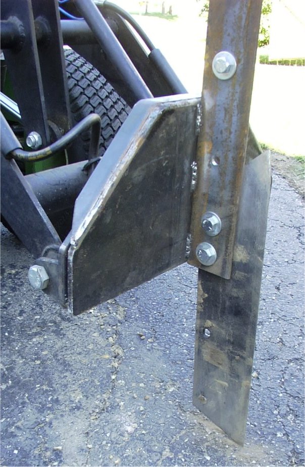

I was at TSC the other day and saw these plow shares for about $8.00. I bought one and bolted it to an angle iron that I had previously welded onto a quick attach plate for experimentation. Total cost was under $10.00(if you don't count the $100.00 quick attach plate /w3tcompact/icons/laugh.gif ) and it bolts on and off so I can still use the quick attach plate for experiments.
Also notice that there is a bolt hole in the bottom of the plow share that I will try to use to attach a cable/pipe layer to in the future.

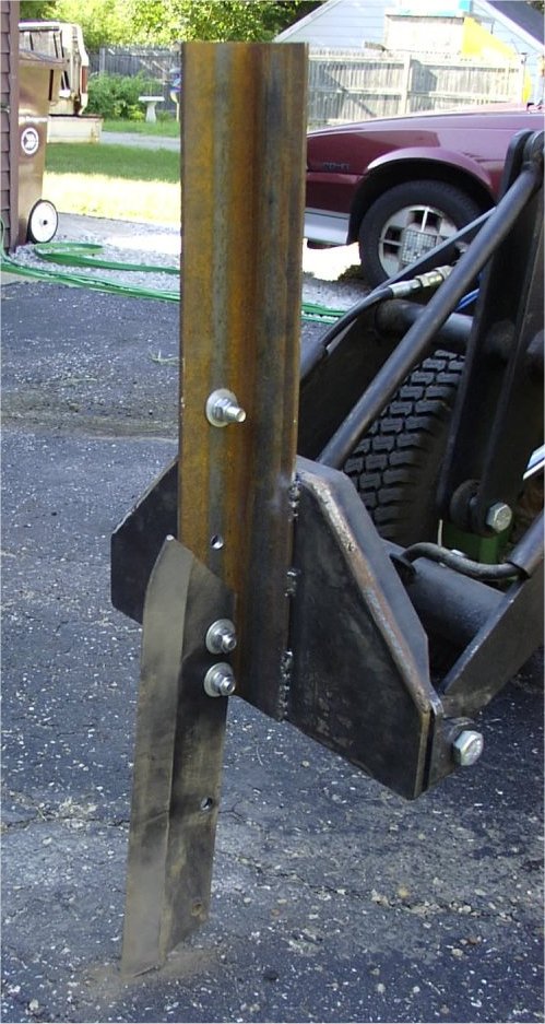

How well does it work? Well, I originally only wanted to slice about 3-4 inches to edge the infield at the little league park. I took it out and tried it in the back yard and it worked so great that I set it down as deep as I could and was able to slice a full 10 inches with no problem. It was really nice to have the slicer facing forwards. I could draw a line in the sod and follow it with great precision.

Looks great, no reason why you couldn't also use a shovel type to make it wider and pull the dirt up for a narrow trench.

Great idea ! When you get the cable/irrigation pipe puller design down, sign me up ! I was wondering...don't you think there's got to be a lot of old, rusting trenchers out there that you could pull (or torch off) the pieces you need and then weld your quick attach plate to them? Might be easier then creating the whole unit (but maybe not as fun or gratifying to someone as talented as you !)

<font color=blue>So...how much do we owe you if we use the exact same design but only SLIGHTLY different ????</font color=blue>
All power trac owners on TBN get royalties from everything that I and anyone else think of in the form of invaluable fun /w3tcompact/icons/tongue.gif
As for the cable/flex pipe layer, I might go back and look for a longer plow share, since this one cuts in so nicely, I think it will handle it with no problem. Multiple passes at greater depths is no problem with the unit out in front. I tried it and went over the same slice three times with no problem. Very accurate. I measured and this on will get it down 10 inches. The only reason I bought this particular plow share was because it was the cheapest /w3tcompact/icons/laugh.gif. They had others all the way up to $15.00 /w3tcompact/icons/shocked.gif (hey, I'm frugal). I'll take a one to two inch diameter pipe and bend it in a 90 degree bend, not too tight, and put some bracing on it. Then I'll attach it with bolts, so that it is removable. I should be able to feed the cable down the pipe as I go if I make a reel stand and attach it to the top of that angle iron that I left sticking up for automatic feed.
As for operation, I first tried it with the edge slanting back from top to bottom, thinking that it would slice down into the ground. It tended to bunch the sod up a little, but not much. I then changed the angle with the joystick so that the bottom of the edge was out in front of the top by about an inch and it worked even better, with hardly any sod tear.
When I finally decide to make the cable layer, I think I'll make one pass with just the blade, then go back and lay the cable. That way, I'll have less resistance and I will solve any troubles that might pop up if I run into roots or rocks before I have a spool of cable or pipe to deal with.

I'll look into those as well. Probably have to weld or bolt it to a piece of 2 inch by 1/4 inch flat steel and bolt it to that angle iron that is welded to the quick attach plate.
I thought about drilling multiple bolt holes for different depths, but then I rembered that I have hydraulic lift arms that could vary the depth up to 54 inches depending on how big I build the implement /w3tcompact/icons/shocked.gif

<font color=blue>CONGRATULATION on your invention </font color=blue>
Thanks. My soil is very easy digging, so I don't know how it will fair in hard stuff. We'll see in a few weeks when I help remodel the T-Ball diamond at my kids' little league.
