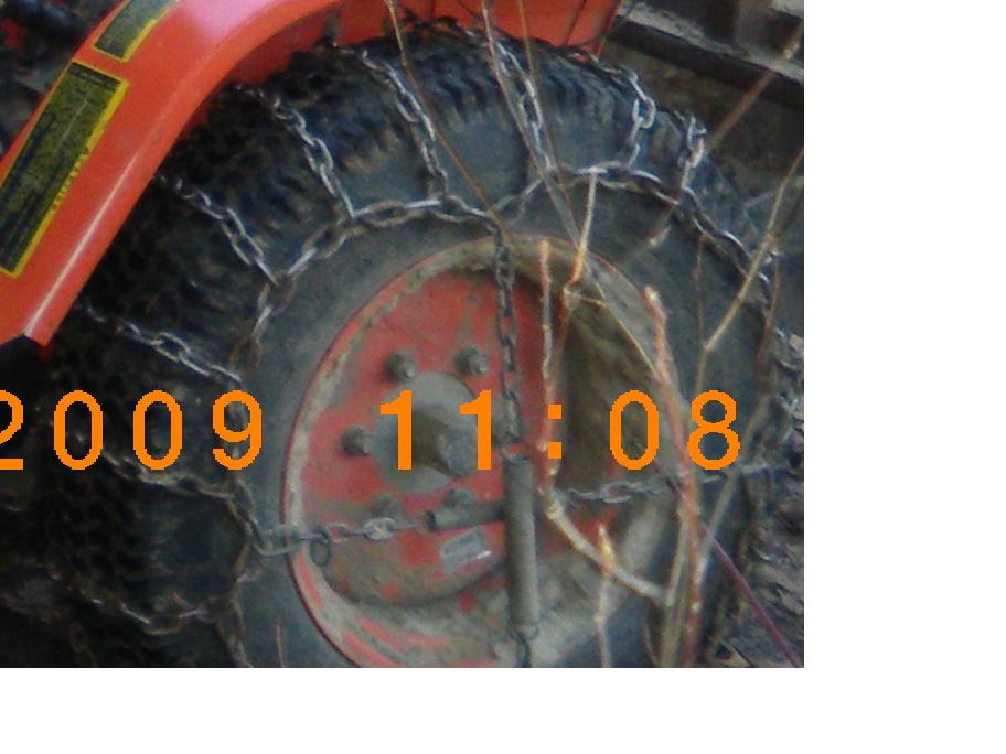

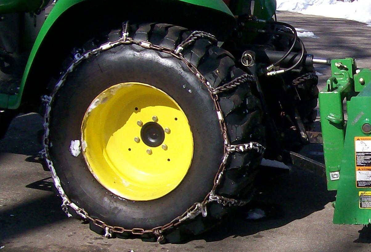

What I did:
First decided I didn't want the side chains down on the sidewalls, but instead up in the scallop of the R_4 bars. So I measured that distance with a tape measure.
Second, I measured the distance from one side to the other with a tape measure.
I bought 6/0 side chain and 9/0 cross chain, the chain hooks, an inside side-chain hook, and two adjustable latches.
I bought from a local truck supplier, as this chain size is used on the large county trucks and the local supplier had chain and chain parts in stock.
Here is a pic of the chains I made (put together). As you can see, they are 5 link.
