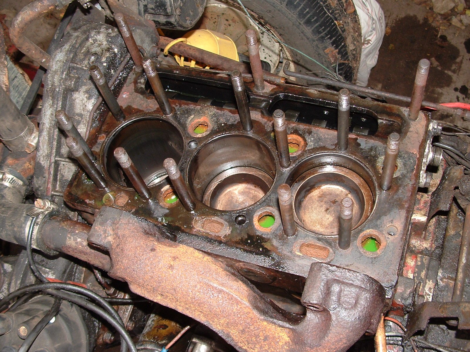

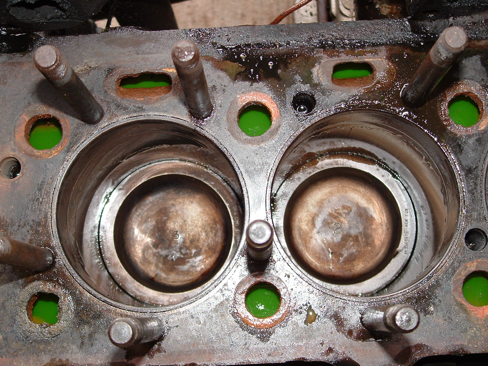

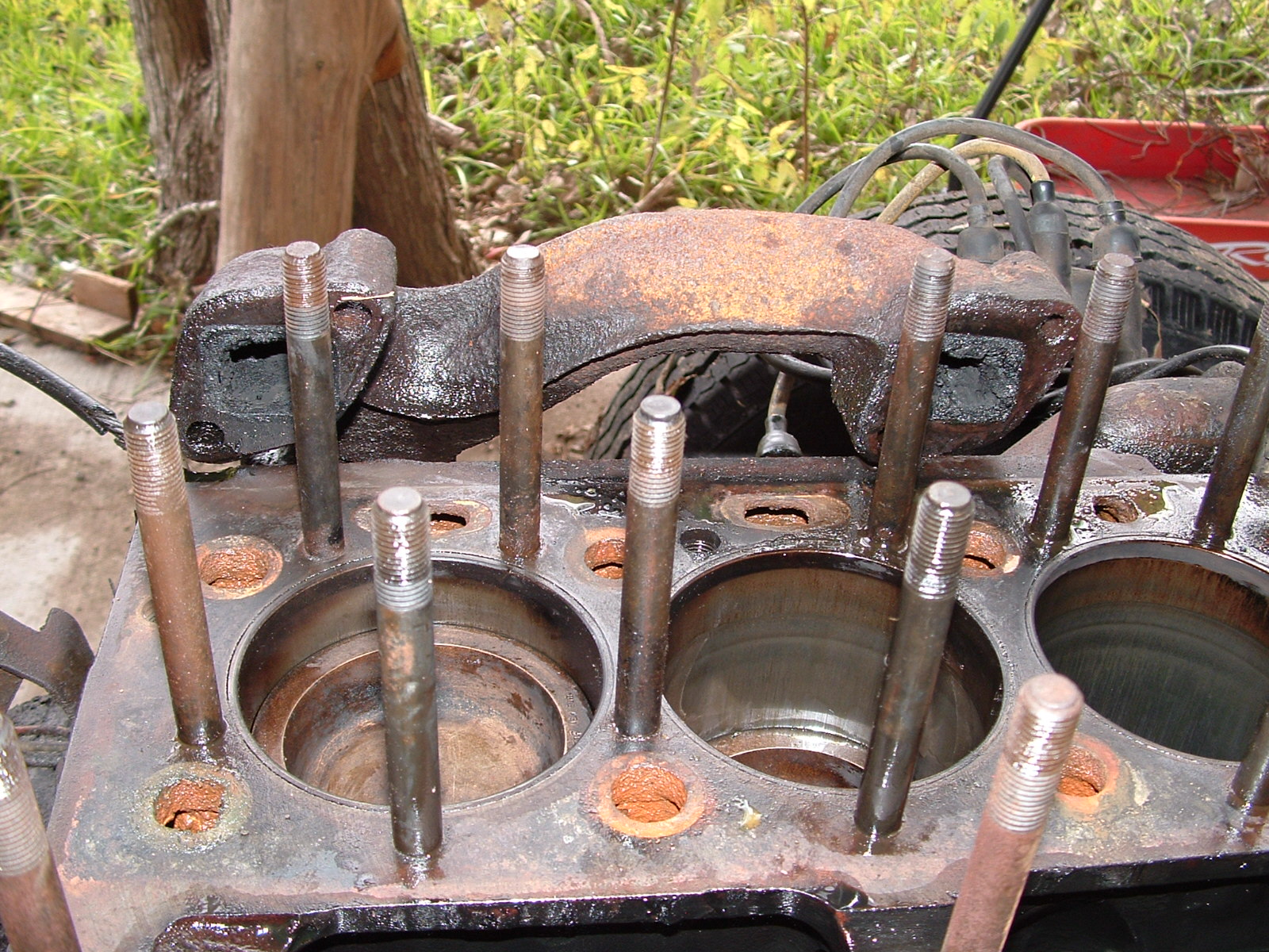

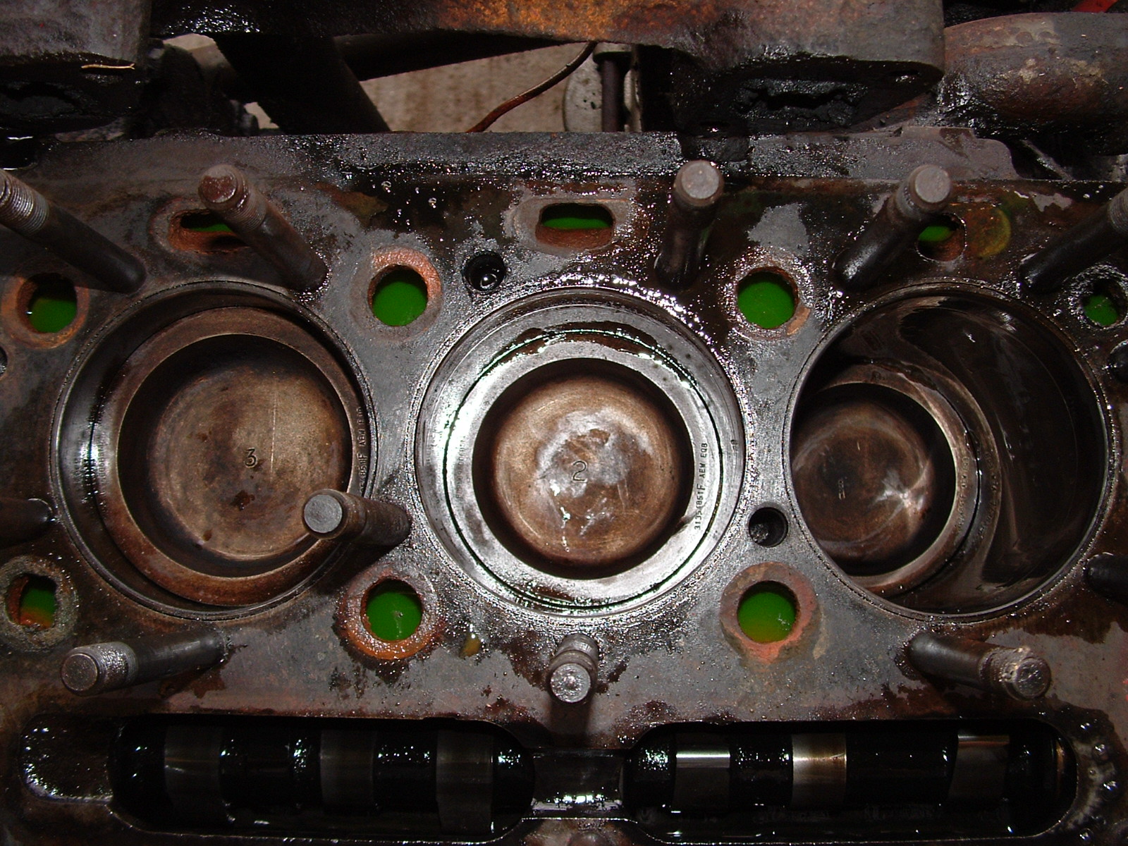

Power washed the motor yesterday. Started it this morning (after having to clean out the carb) and saw that the head gasket is blown. It is blowing compression out on the rear cylinder, along with oil. I also saw about a 1 1/2 inch crack in the head, not near any edges but on the exaust side of the head. The motor is due for a rebuild anyway, which I will be starting on soon. Im sure I will find alot more issues while Im in the motor. While looking through all three spark plug holes, I could see oil pooled on top of all three pistons lol. Im not sure that its ever been rebuilt, will there be signs of it if it has? The motor ia an AG3-152. I see piston and sleeve kits for around 500.00. Anything I should look for or pay special attention to? Thanks
   / 1971 Massey Ferguson 135
#9
Well, I was wrong again. The head gasket looks good, in fact it looks new. I see a mark on the center piston from hitting the valve, but the valves look good. Im guessing a previous owner had the head off to do a valve job. The exhaust manifold is so plugged up from burnt oil, Im sure the flow is really restricted, and I think what I was seeing was exaust blowby and oil leaking on the rear exaust port. It looks like the exhaust manifold opening is about as big around as a nickle lol. The piston tops however look really clean, as does the exhaust ports on the head. Shouldnt they be pretty crusted as well? I took some pics, can you tell by looking if this is a sign of bad rings? Is it possible that the restricted exaust can cause too much crank case pressue, forcing oil past the rings? Also I noticed a little side to side to side slop in the pistons, and can see a little of the top ring. How much movement should be in the pistons if everything was "normal"? Thanks again!
