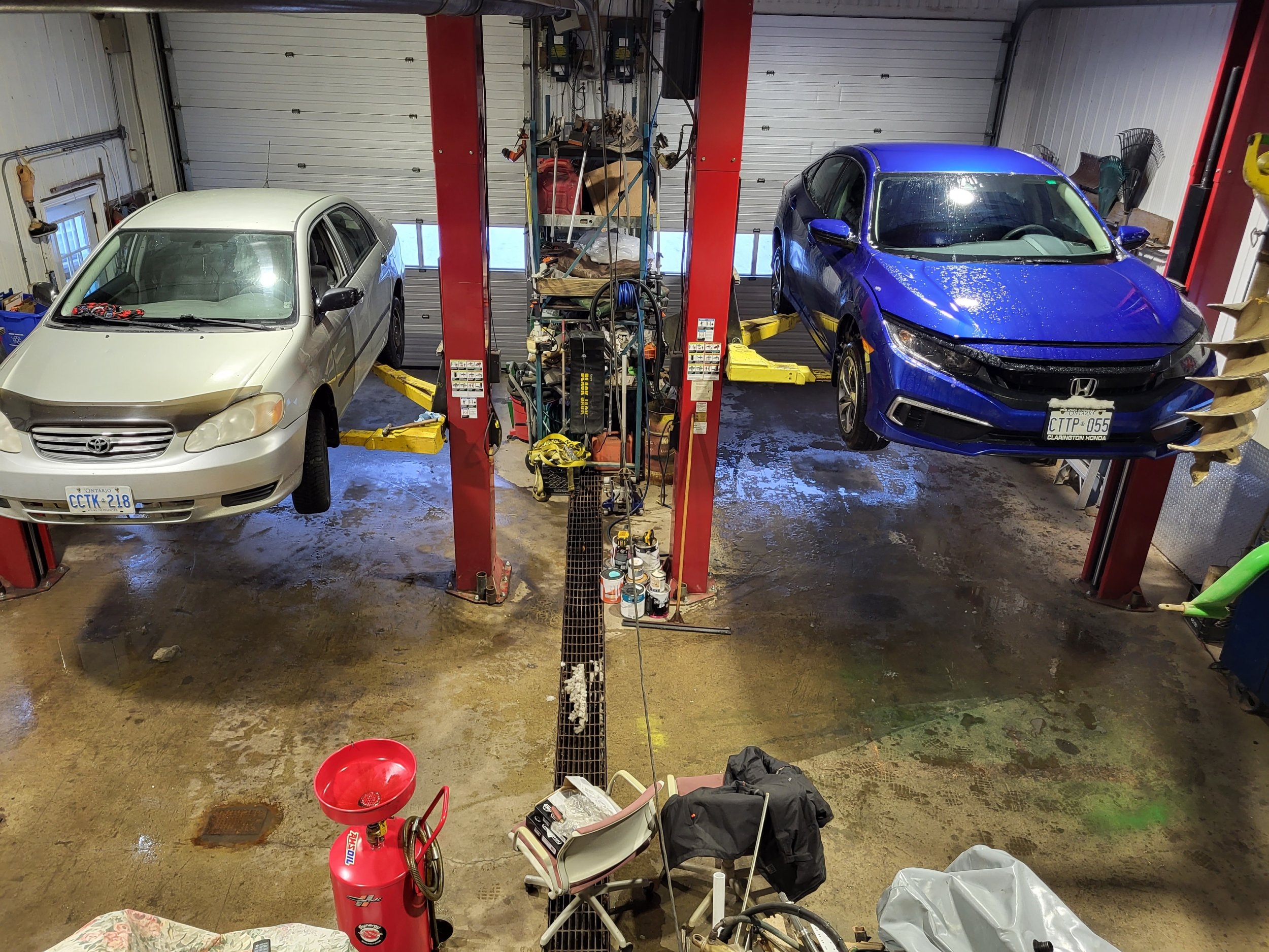

My 3-bay shop/garage is 40 x 26, built in 2012, with a 10k lb. 2-post lift and boy am I glad I got a 2-post. Too many things you cannot do on a 4-post. Door issue is an inconvenience only solved by a commercial lift with posts farther apart.
You have a dream shop - my only regret is I didn't make mine larger. But I did break the bank when I built mine (myself - commercial GC & EC for 40 years among other things).
In early '80's I restored old tractors for fun. In 2017 I moved to restoring old non-911 semi-rare Porsches - have 3, sold another: 914, 924 Turbo (sold), 944 S, 928 5-spd.
GN
Door hitting post is solved with an asymmetric lift. My personal choice is the Challenger Versametric 10K. Made in Louisville, KY.

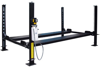

This would be the lift I would purchase. To change a tire very
easy to jack up one side at a time and no trouble to open a door
and don't have to mess with placing a padded arm to life vehicle
willy

Lifting a vehicle on a drive on hoist is not as easy as you might think due to placement issues. And you will need to jack up 2 wheels at once (2 jacks) if you are going to rotate tires. You can do it but much easier on a 2 post lift.
