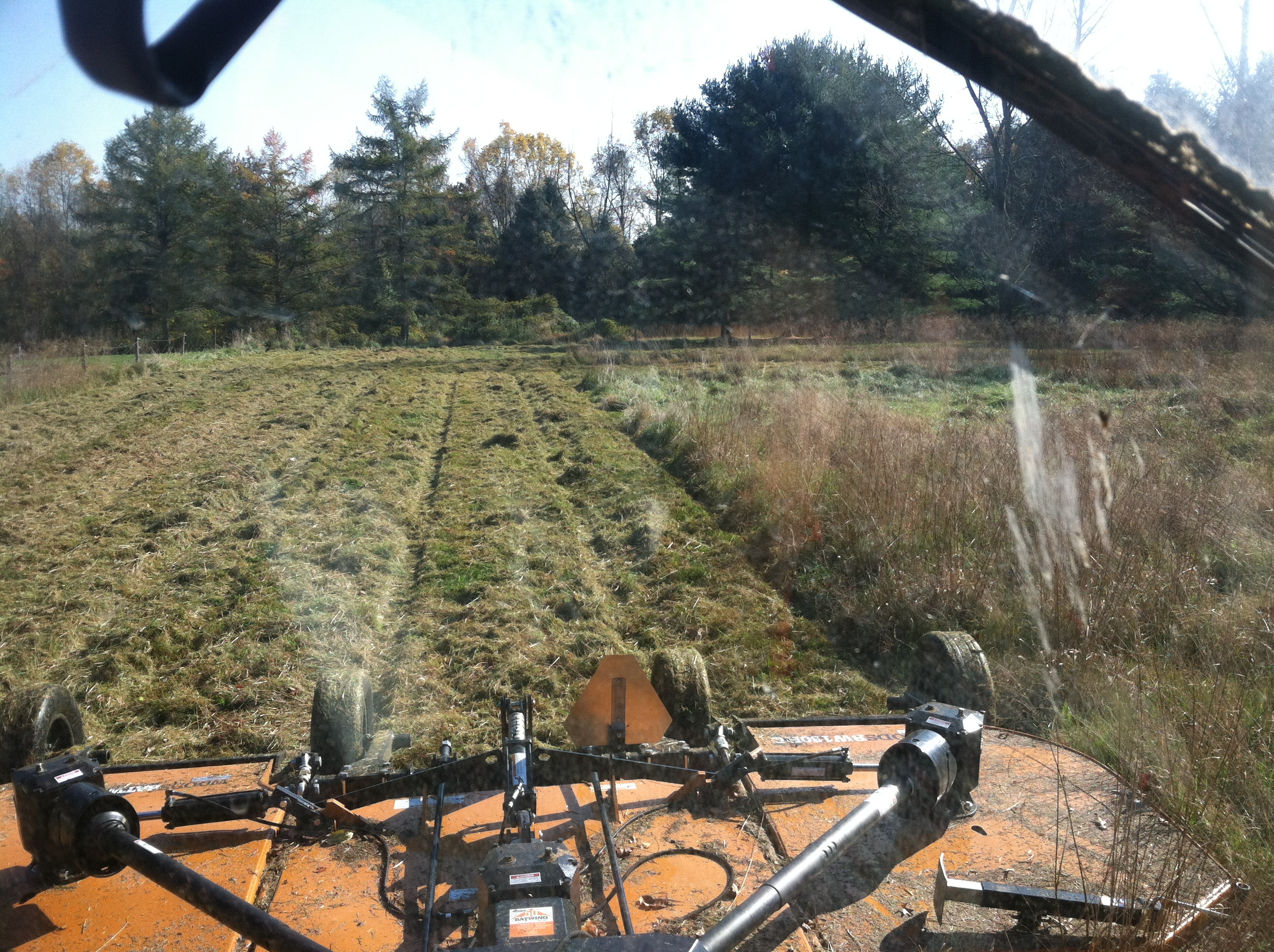

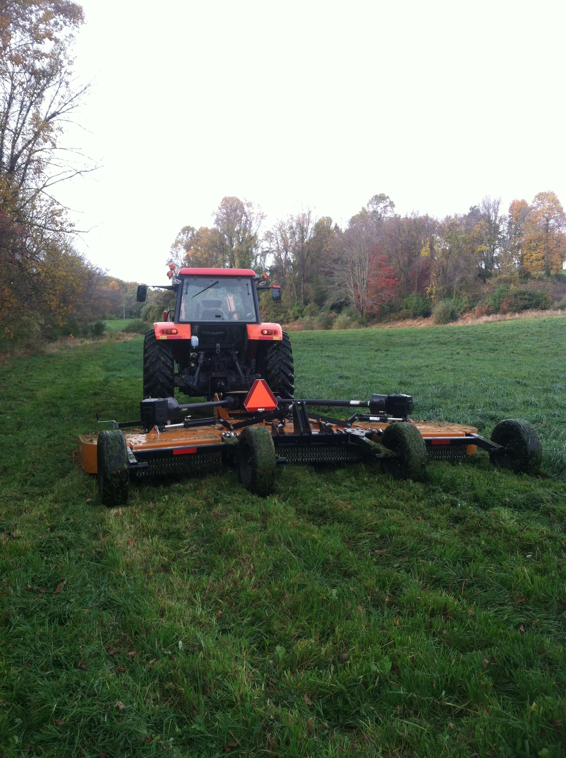

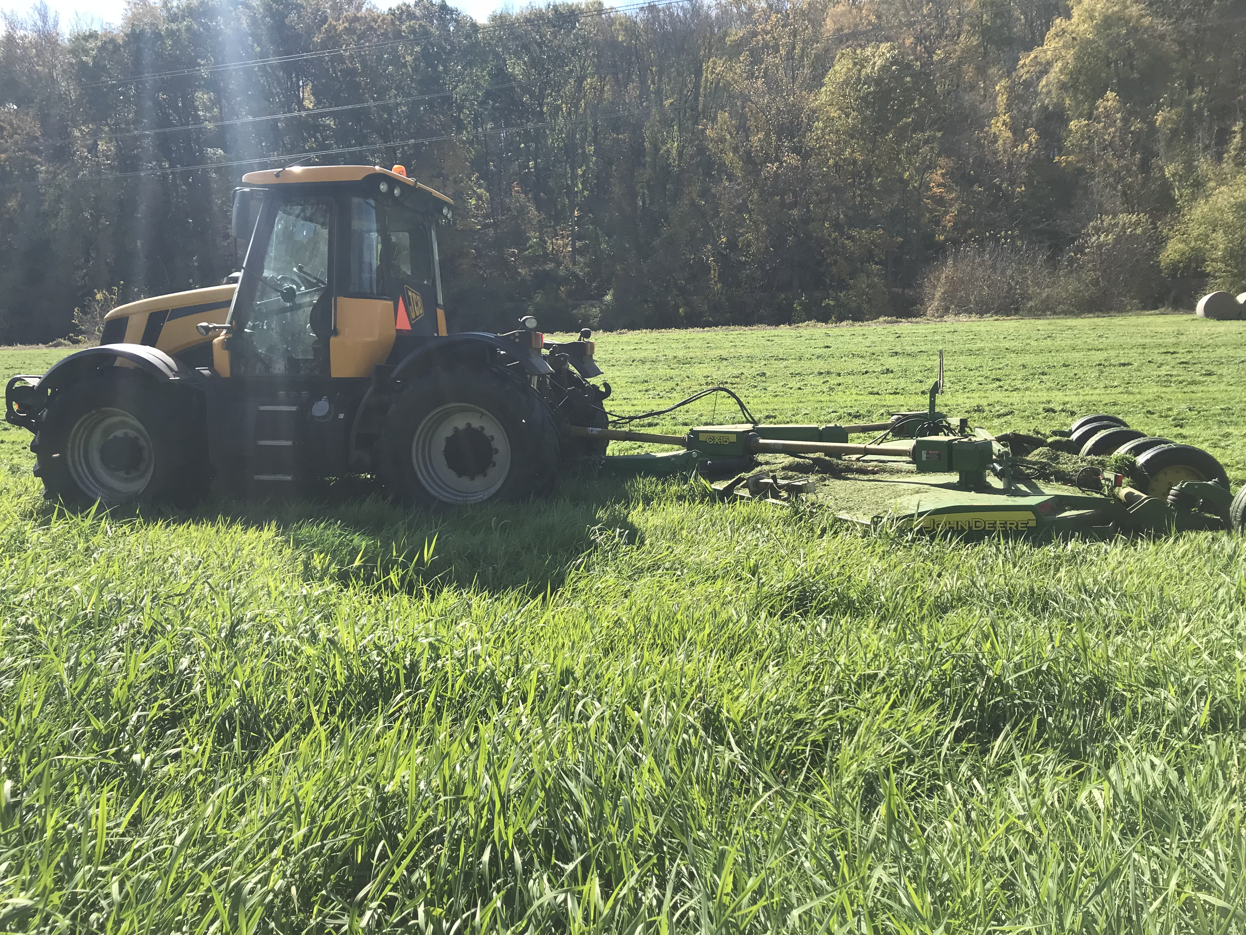

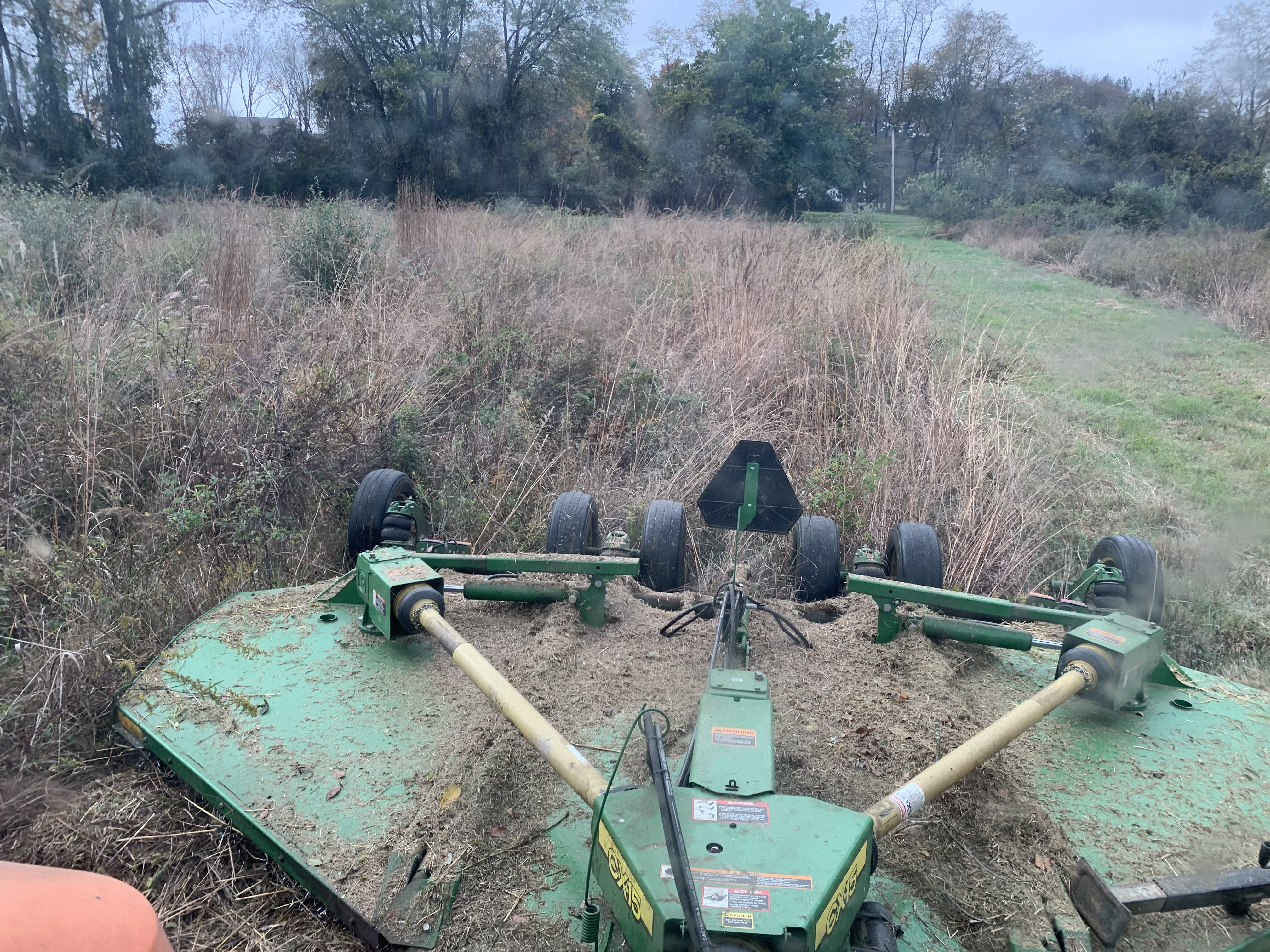

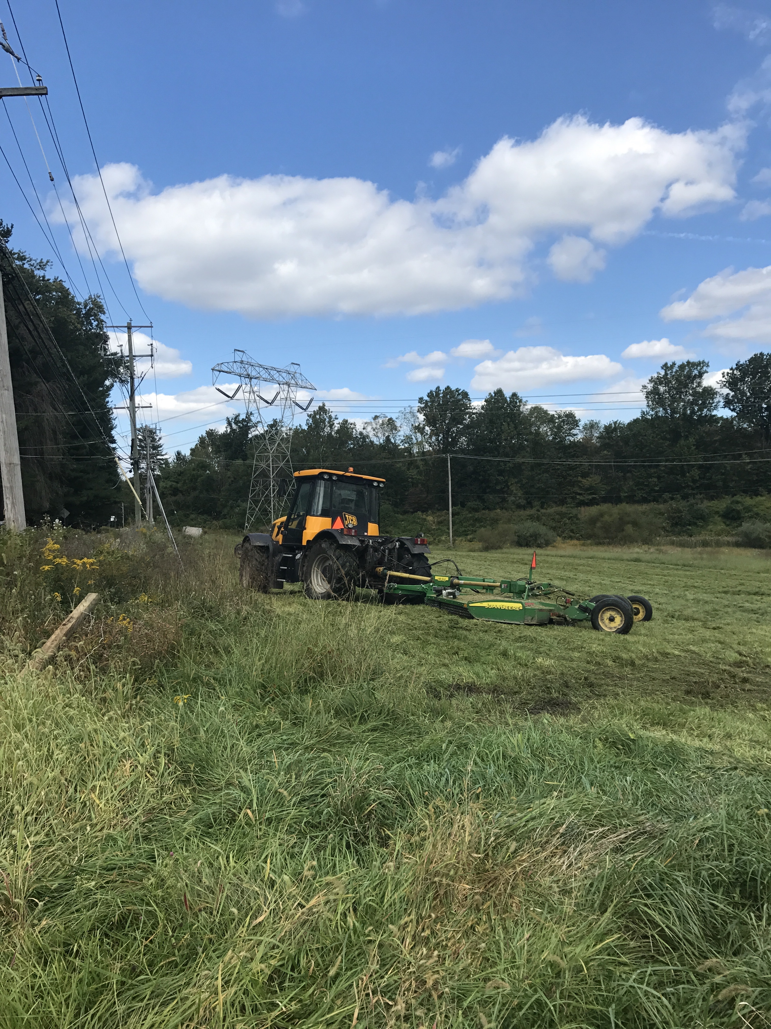

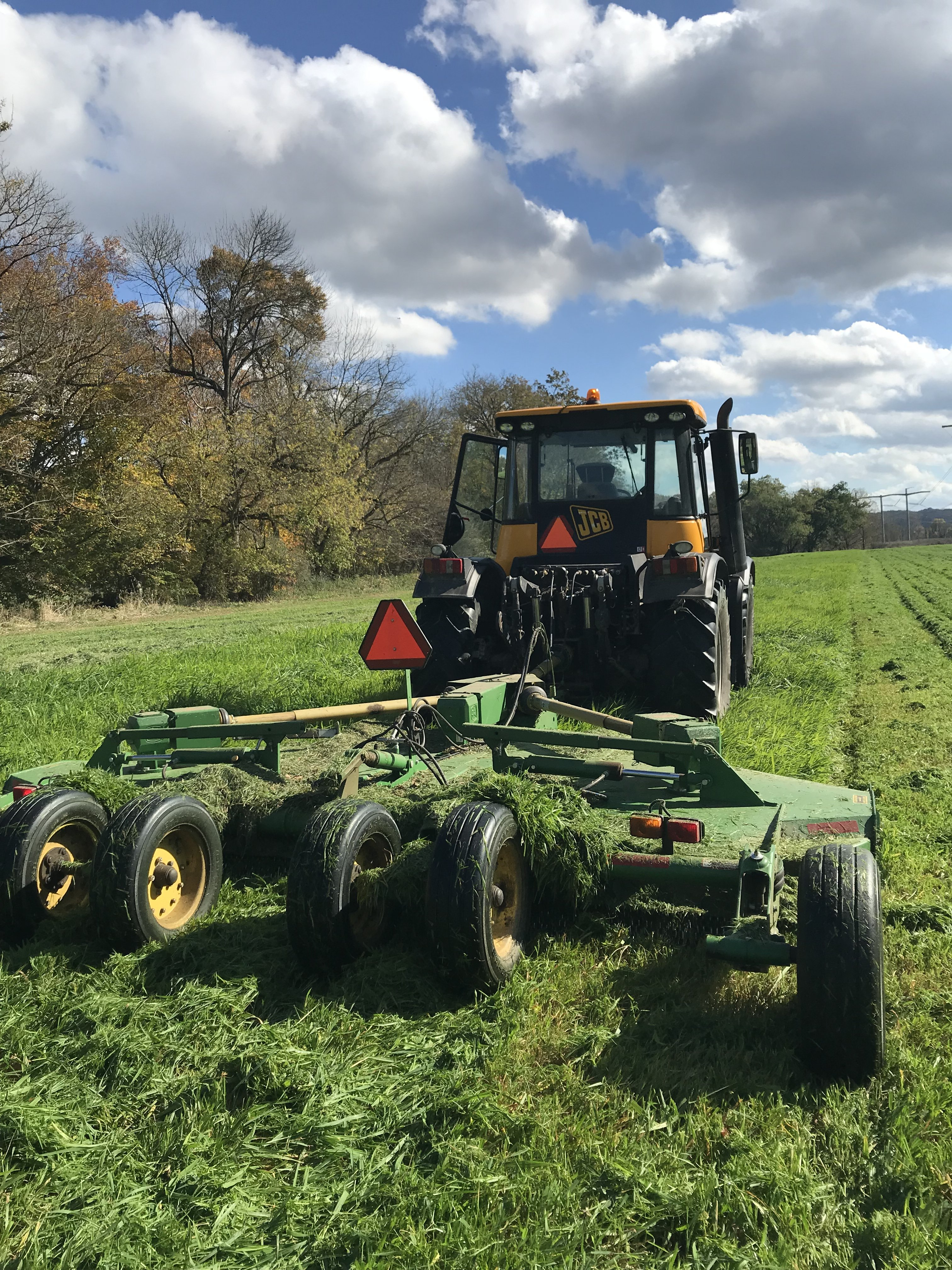

I have used John Deere CX series rotary cutters for decades behind my Kubotas and JCBs.
I am a commercial field cutting contractor and farmer, so what would I know, but I am pleased with them.
Its easy to beat Woods. Just take a single deck woods into some rough junk and see what the deck looks like. I hear they may finally have a double deck design, but the others had it 15 years ago.....
Bush hog is a very good brand.

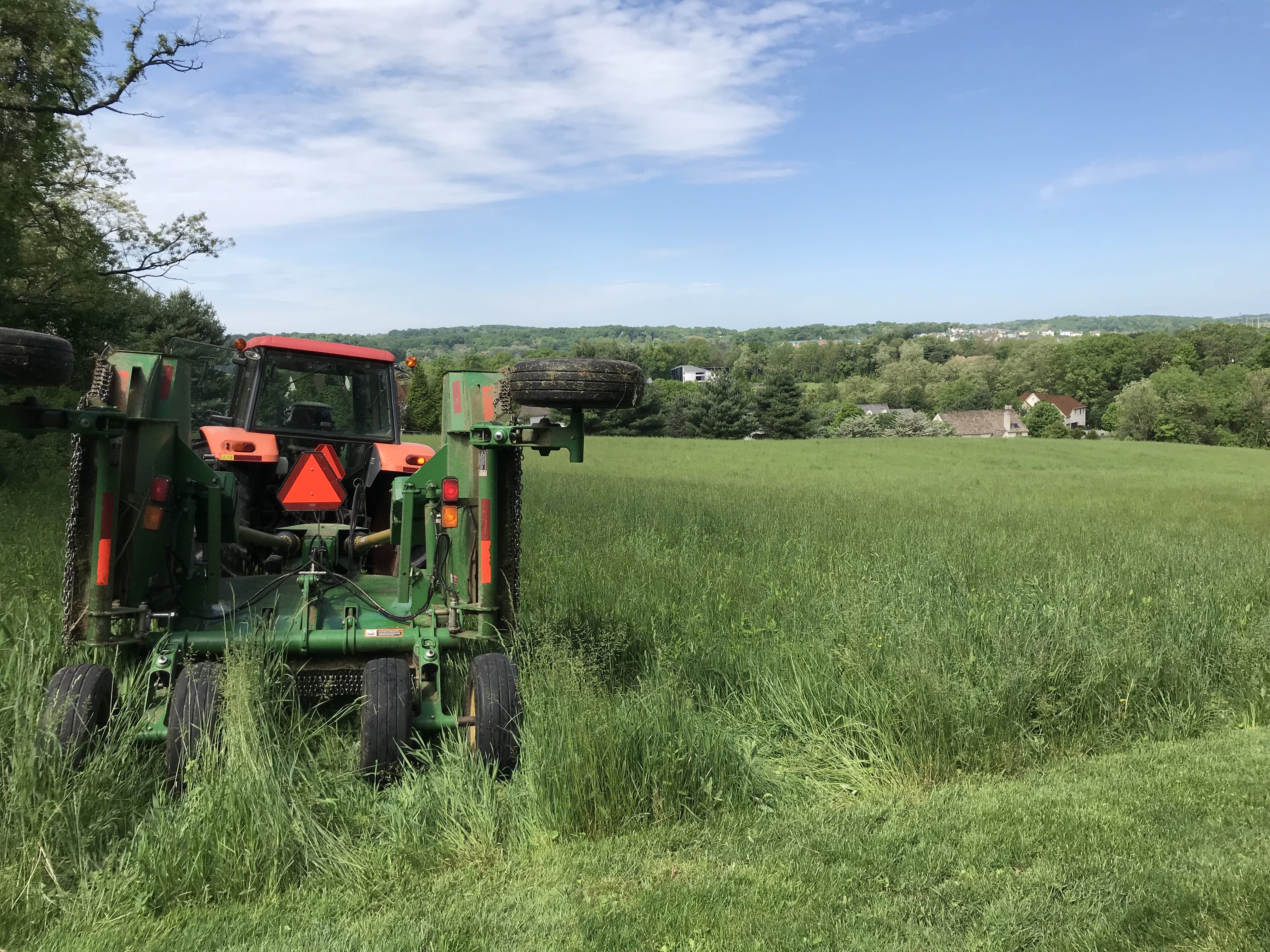

Just to show you I have experience with Woods, here’s one of my Kubotas about 8 years ago with my Woods mower. The deck did not hold up. It began rusting on the top from rock hits in 2 years.
My Deere’s have no rust, because of the dual deck design after 10 years of hard commercial use.
