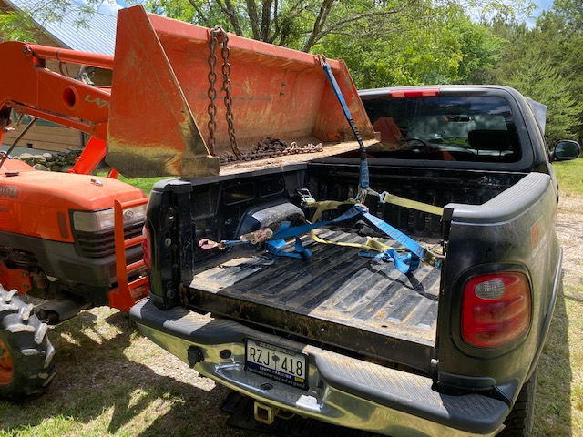

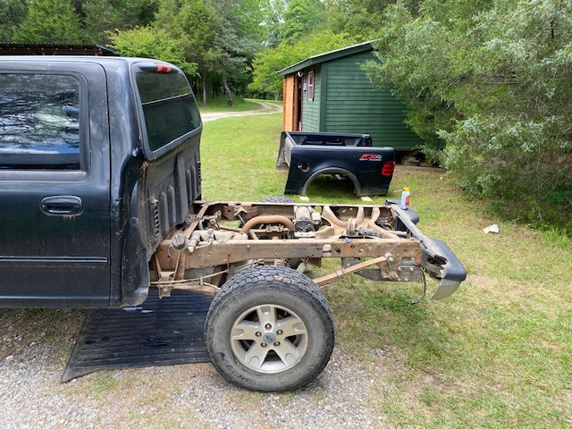

I got off work at noon today and headed down to the cabin. Got the bed off the truck in well under an hour. If the bed bolts are not rusted/frozen it is simple. One bolt was a little tough but PB Blaster loosened it up in no time. Used the FEL to lift it off the truck. With a tractor the size of mine and me being the only hand I would not recommend this approach for a nice looking daily driver. As is, my bed is already beat up and scratched up so it was no big deal.
I am glad I took this approach because getting the skid plate off and loosening the tank straps was much easier working from above and made getting PB Blaster on the bolts easier.
Getting the fuel lines off was still a miserable experience. They have little plastic clips (not the kind that there is a tool for) and the connection was under the cab in the frame rail. Could barely get my hands in there. Couldn't see. That alone probably took 30 minutes. I probably could have loosened the tank straps and made some more room which is what I should have done. I just couldn't tell how much play the lines had in them.

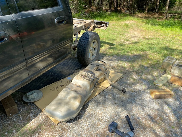

After that I just put cribbing under the tank and loosened the tank straps. The tank was about 1/3 full and plenty heavy but manageable with the cribbing. I just slid one piece of cribbing out at a time alternating ends until it was on the ground.
At this point the bed is off and tank all the way out. The whole thing, including clean up and getting the gas out of the tank (no small feat) took less than 3 hours. I don't think that was all that bad single handed.
Glad I took the bed off. That part was easy and made access to most everything much easier than working entirely under the truck. I'm too old for that.
Will buy the whole pump/sending unit and come down next weekend to put it all back together.
