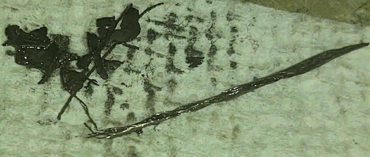

Since early last year, I have noticed a decrease in speed and power. Having no other point of reference other than my memory, I just figured I wasn't remembering properly. By September of last year, it got to the point that I really felt something was wrong. I spoke with the service manager at the local dealer, who recommended a full fluid/filter change - which I DIY'ed using their parts.
As I drained the hydraulic fluid, I found some gnarly metal filings and shavings stuck to the magnet - some that were over an inch long and looked like wires or drill bits:
The managers response (after discussing with his technicians) was that this was "normal" and nothing to be concerned about.
I replaced all the fluids with OEM, and found no difference in the performance. As time went on, it became more apparent that something was afoul. In January, I contacted the dealer again about service.

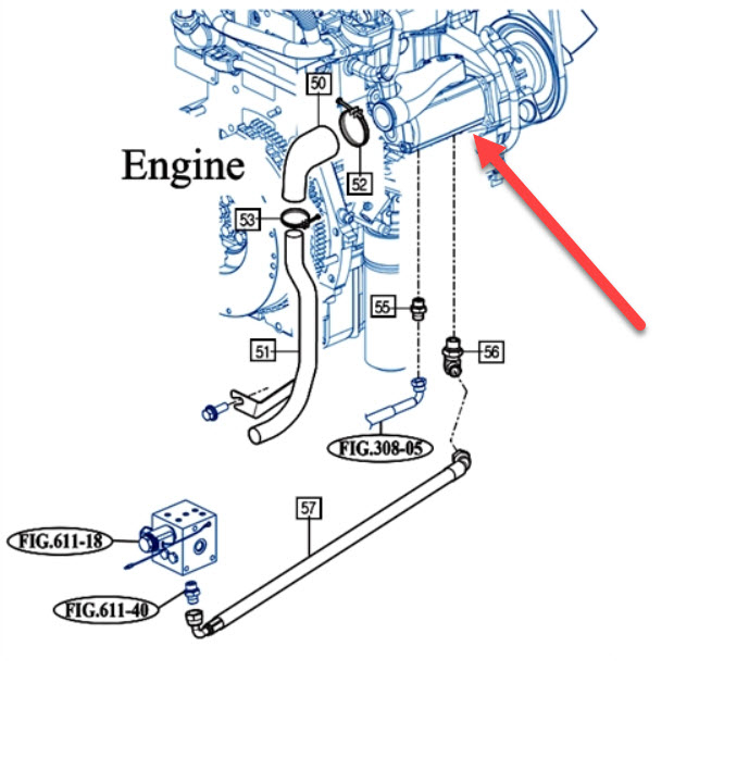

Yes, I saw that - $814 for the part. I just wonder where that part is located (is it internal?). I have a neighbor who has his own garage - and he's done tractor work. He's going to research what's involved, but feels pretty confident that it's internal, and would require "splitting" the tractor to get to it. He said he's done that several times and it's not a big deal. However, he said his biggest reluctance is getting the cab off. I sure hope it's not that involved. He said the dealer will quote a very high labor cost if it's internal.

Its on the right side of the engine, not internal. Had you previously done an oil and filter change before.

As far as the location of the pump, that's what I've found on the Mahindra parts site as well:
For a HST, the pump is integral to the power train. No pump, no power. The pump is covered by warranty because it's "all parts contained therein" of the transmission. Further, don't accept only a pump replacement. Be sure to get the system flushed, and the rest of the HST inspected if not completely torn down for cleaning. Pump failure is a catastrophic failure because the pump forces debris through out the system. There are all sorts of places for debris to settle and hide. Any metal debris in the system is sure to cause another failure shortly. Usually after the 90 day service warranty.
Are you certain about it being internal? That would really complicate a DIY repair if warranty isn't covered. What concerns me most is that the metal filings I found are spread throughout the system, leaving a timebomb waiting to go off.
