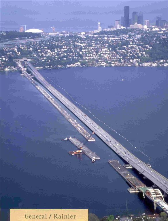

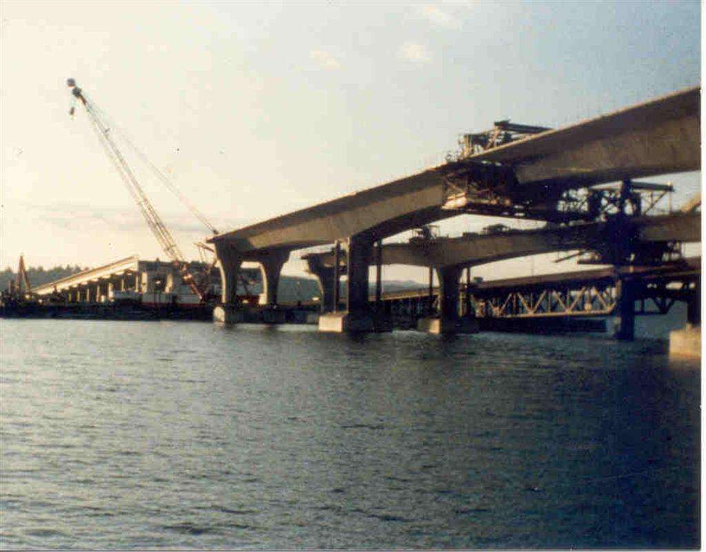

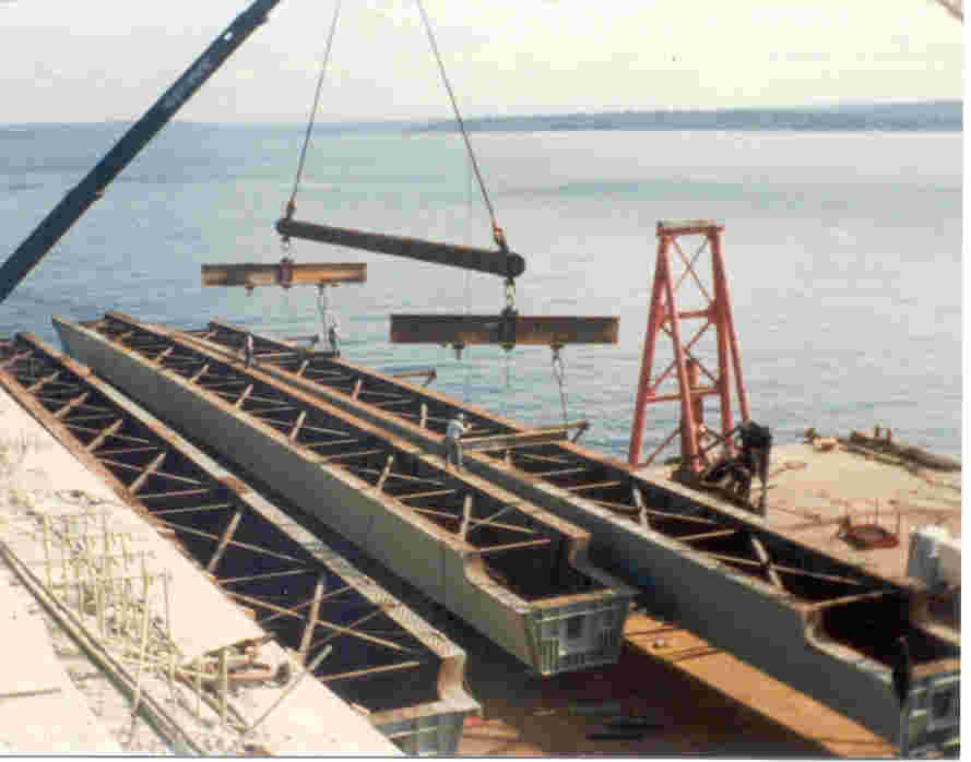

That guys name is Roy Williams. We were foremen on this I-90 floating bridge in Lake Washington together.

That bridge looks like "fun" to work on :)
