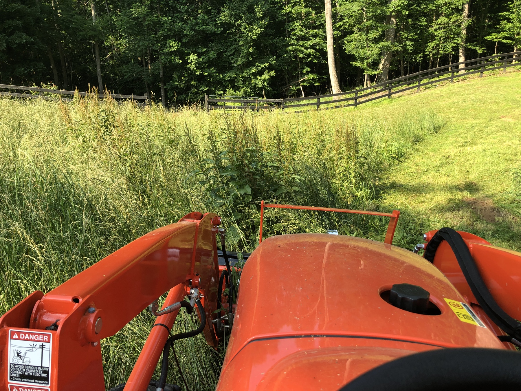

I mowed this with a L2501 and 5ft bush hog. It did great.

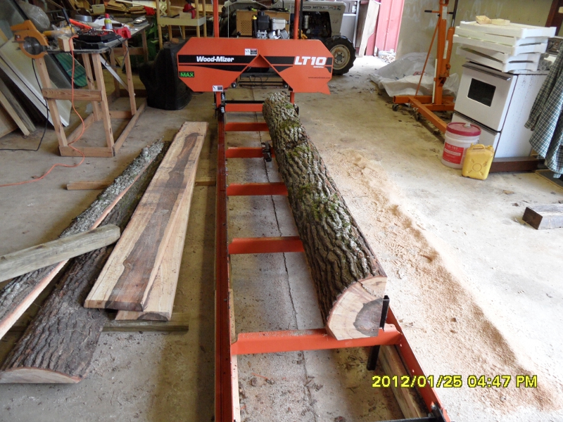

I've a Woodmizer LT10. I've a B7610. I've LOTS of trees that are about 18 inches. And many much larger.
I could drag a 10 foot log to the mill, and get it on the 3 pt to roll it on the mill.
But that was it's limits.
So I went up to an M4700, lifts a ton on the FEL, 2 tons on the 3pt. And the B7610 gets things through my gates :)
