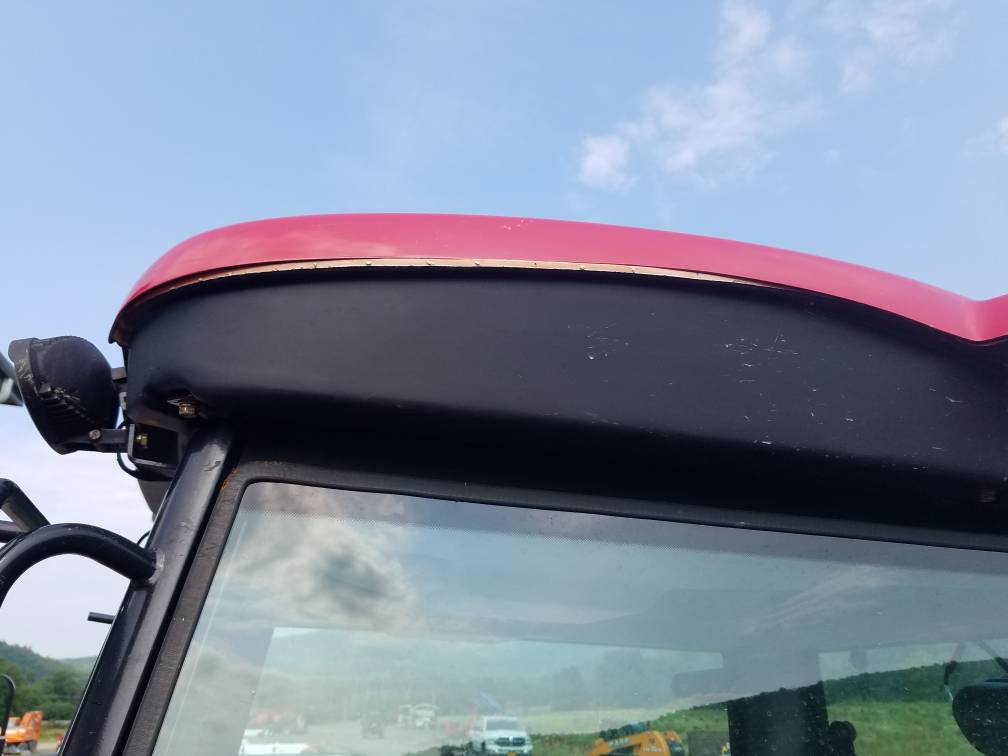

Any one have any idea how mahindra attaches there roofs onto the cabs, it looks like the previous owner caught the roof on a branch or something I'm assuming, I don't see any fasteners to try and reattach it, almost like it is glued or formed togethor, It will push back togethor but just keeps separating, I thought about trying to rivet it but not sure how well the plastic would hold togethor,, sorry for bad pic 20180705_093035.jpeg
   / 2538 roof pushed up #2
Maybe some Gorilla glue plus pop rivets or self tapping screws? Ken Sweet
   / 2538 roof pushed up #3
If you can get it open enough, maybe a can of spray foam can get it's nozzle in there. Then press it back into place and clamp the edges with pony clamps until it sets up. That's probably similar to how it was bonded at the factory.
