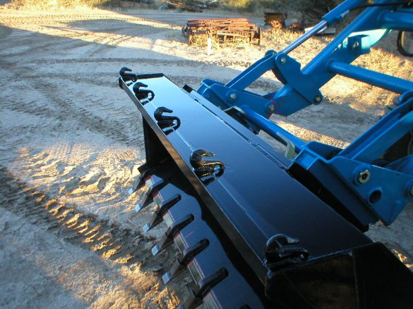

Cut the angle 59 & 1/2" long and stitch weld to the top lip of your bucket. If you want it a bit stronger, use 3/8" thick 2x2 angle. The attached picture is what I did with one of my buckets.
