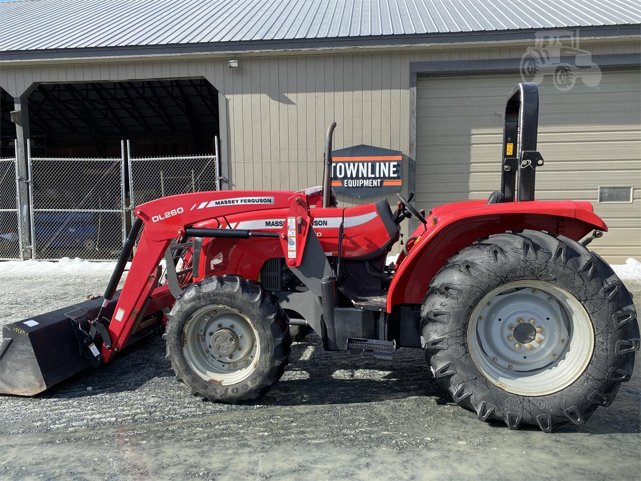

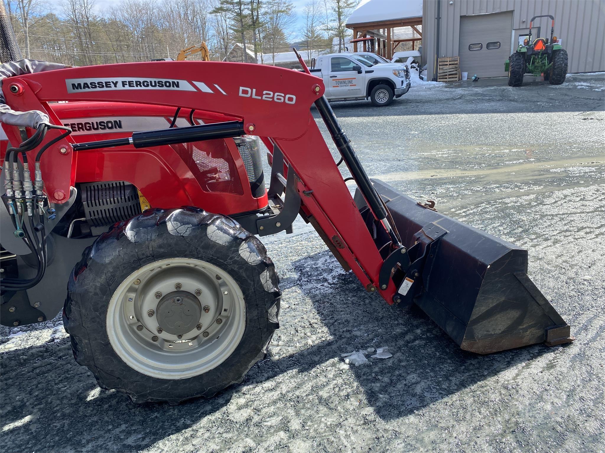

found a massey 2650 HD for sale locally that caught my eye. with the DL260 loader. I only have 3 acres (1 acre is currently being cleared), a few hundred feet of private driveway that needs constant snow removal and and constant regrading. I do constant ground grading work and heavy loader work. usually im needing to move 200 gallon pots full of soil/media that weigh 1800-2000lbs using pallet forks. really i should be looking for an offroad forklift but that wouldnt be useful to me anywhere else here. i dont need the tractor for typical heavy duty ag stuff (ie, hay or farming) so im scared im just getting into way too much tractor than i need. at the same time i dont want to spend the money to get a tool and buy something too small that i cant use for hard tasks.

these are going to be 20ft hoop houses. i plan to make "High Tunnels" which i should be able to get the tractor in and out of on either side. i wont be able to drive up close to the edges due to height but i plan to make some form of 3 point pallet lift so i can detach the loader for more interior greenhouse clearance. i also run large 200 gallon pots outside not in a greenhouse as well. if i plan to move up to 300 gallon pots those can weigh in at 2600lbs. i should also note, nothing is paved. right now its just loam, and we get a good 2-4 weeks during snow thaw that turns maine into a mud bowl. this in particular is heavy work time during mud season as things thaw i have to gear up for my outdoor crops.

Massey Ferguson 2650 HD Weight
Shipping:5,578 lbs
2530 kg (2WD ROPS)
6,305 lbs
2859 kg (4WD ROPS)
6,592 lbs
2990 kg (2WD cab)
7,319 lbs
3319 kg (4WD cab)
2WD ROPS Operating:6,365 lbs
2887 kg
Massey Ferguson DL250 Loader
Lift to 1.5m (at pin):3,304 lbs
1498 kg
Massey Ferguson DL 260 Loader
Lift to 1.5m (at pin):4,085 lbs
1852 kg
   / 3 acres, greenhouses & heavy loader work + snow removal, Am I going too Big, Kubota M5-111?
Thanks! I saw that tractor data already. I didn't find the 4wd operating weight but if I use the 2wd rops weight difference between operating and shipping it's 787lbs difference. Add that to 4wd and it's 7092 but that's just a guess. Also i cant find the weight of the DL260 loader which I'm suremis at least 1k lbs? So that's an 8100lb tractor? I imagine even a 10k gvwr trailer would be on the fringes
i think after careful consideration im gonna have to find a smaller tractor. if this thing weighs in at 8100lbs i wont be able to tow it to a shop for maintenance work with my 2016 tundra. its got a tow rating to 10,100lbs. too close to gamble.
