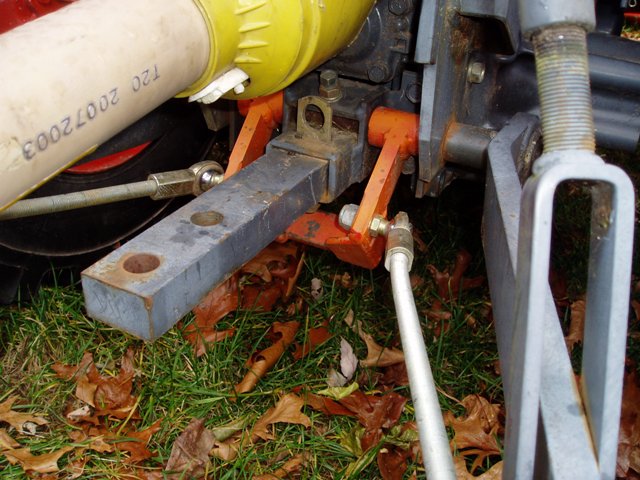

Here's a picture of the linkage that I built for my Kubota B7500. It is modeled after the setup that IH had on some of the older 3 points. We had a 686 row crop IH with a similar setup.

Thanks for the picture Mendonsy. Interesting. smoker

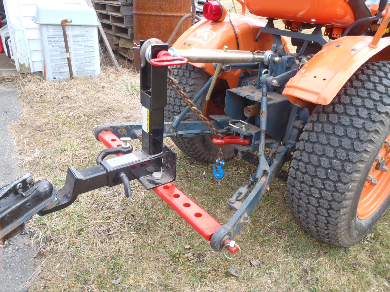

Chain the 3pt tow bar to your drawbar at max height you want it. That will allow the 3pt to drop down so you can slide the ball into the hitch when hooking up put pull up against the chain length to prevent it from climbing.
That's how I do it:

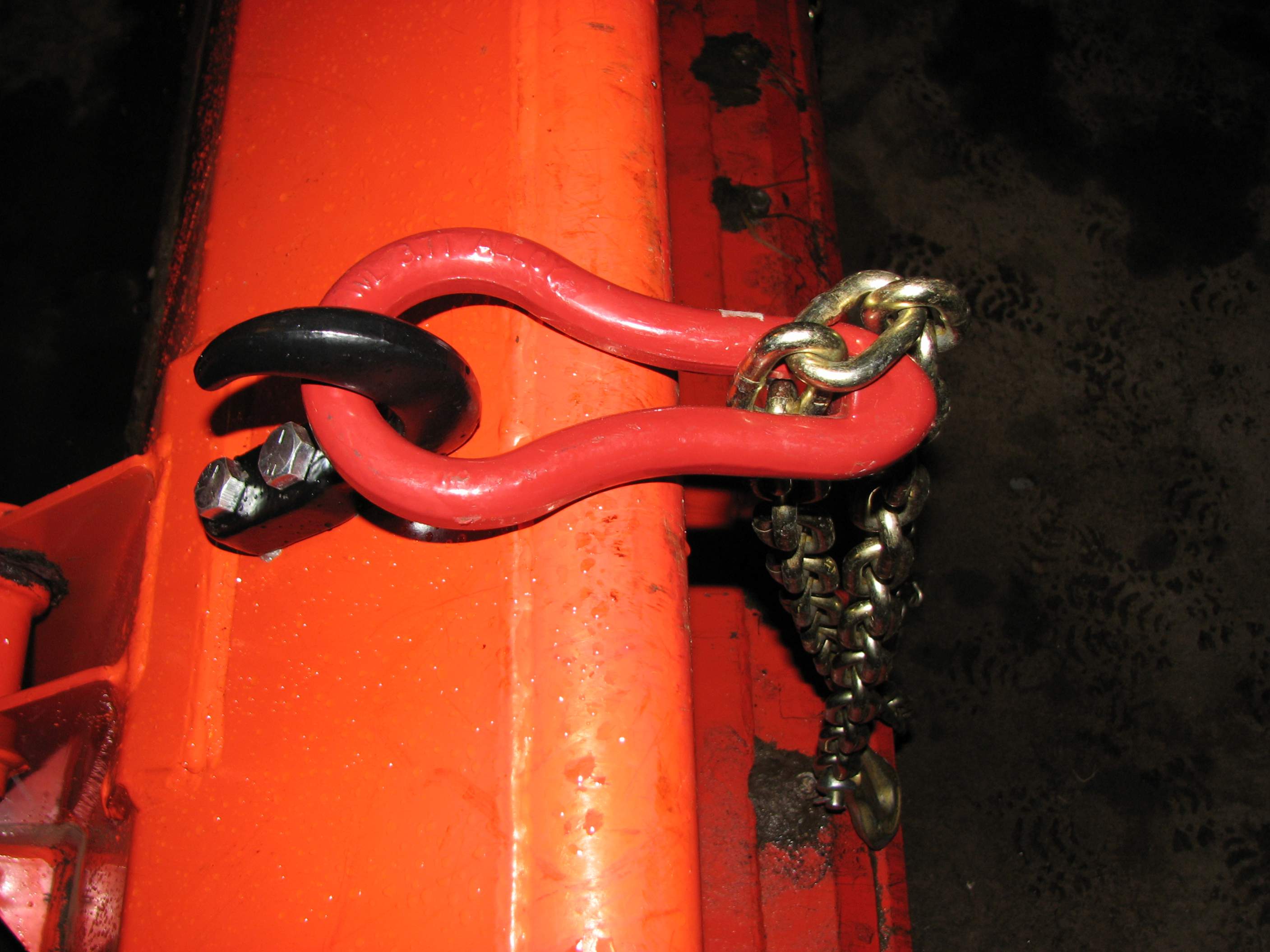

That is perfect! What do they call the device that is attached to your tow bar? I like that idea instead of relying on the grab hook. Thank you for the picture, I appreciate it. smoker
