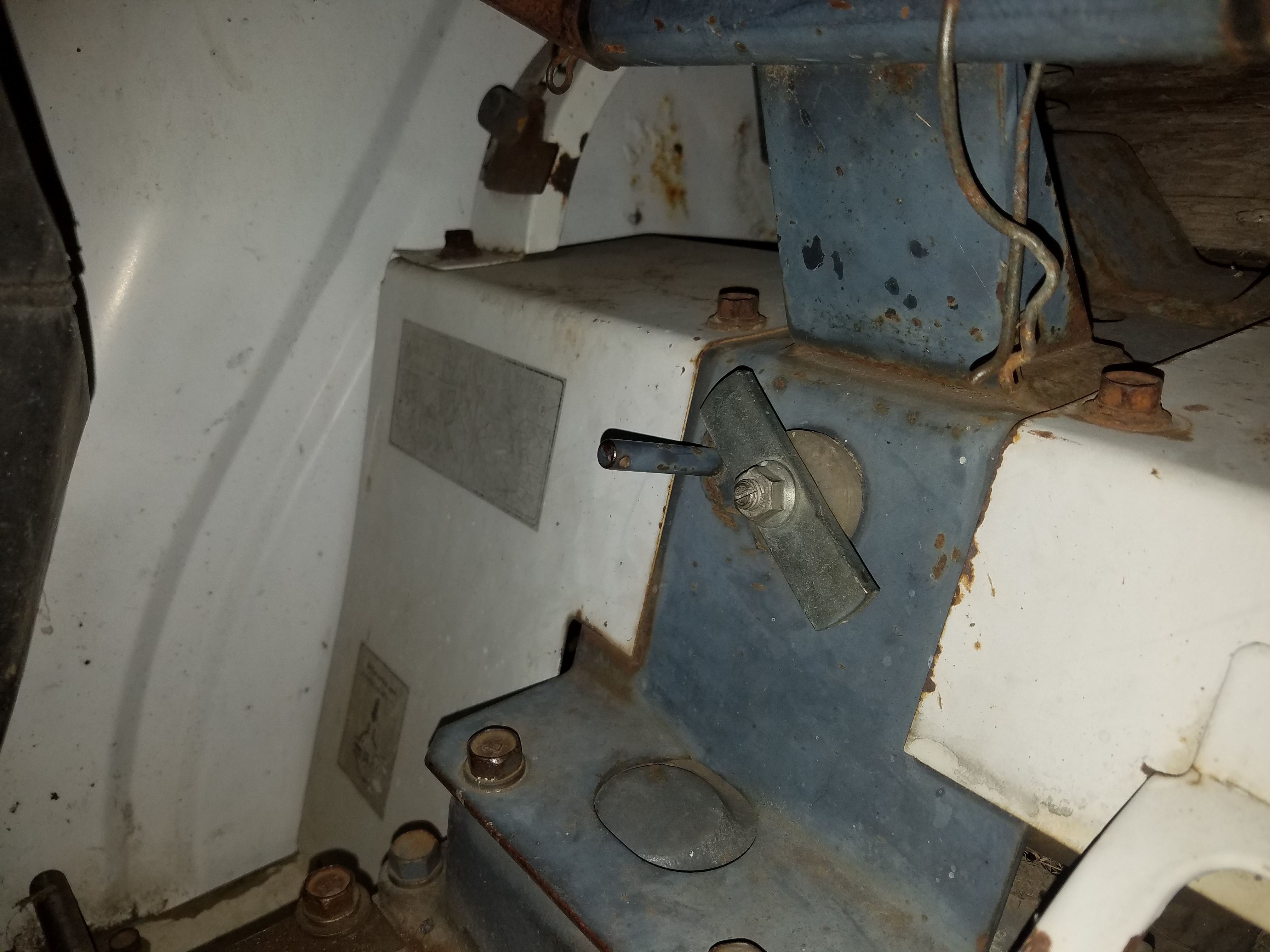

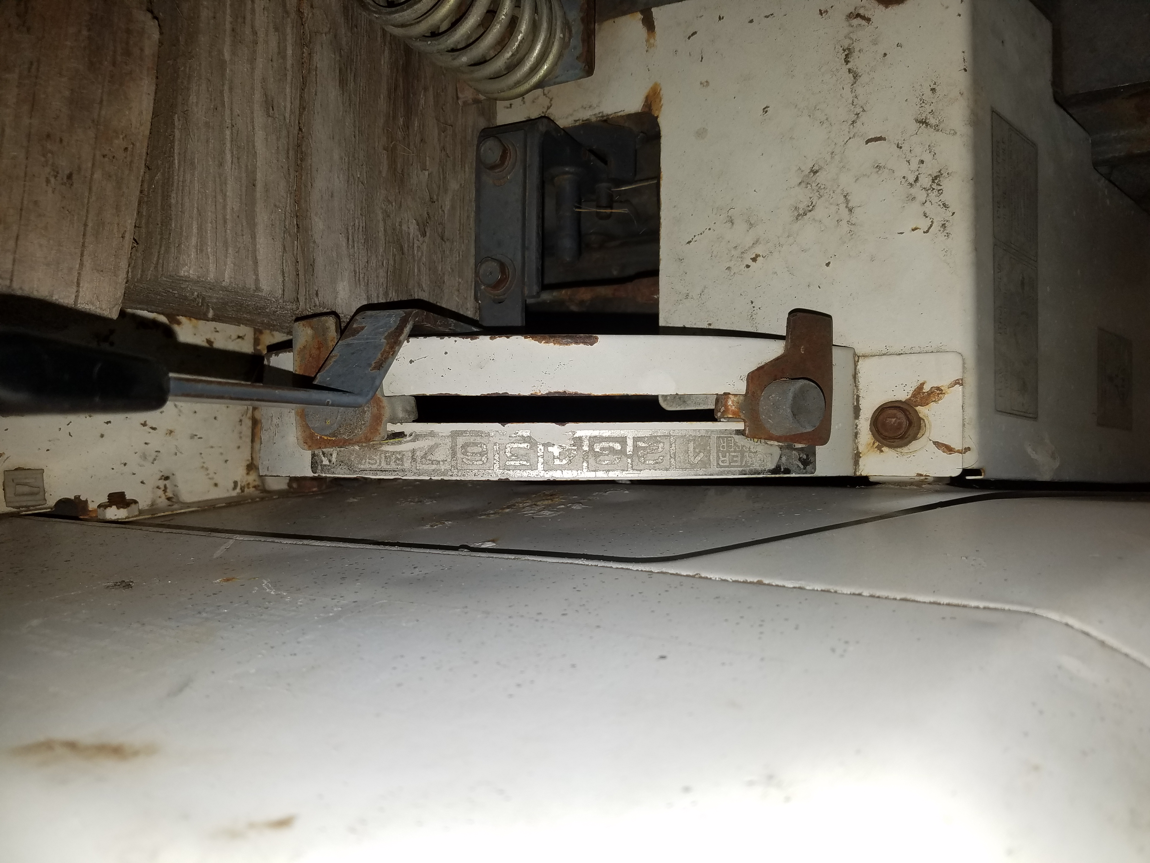

This is the flow control knob, that doesn't move.
Not sure why this one is sideways, but this is the lever to raise or lower the 3 point.

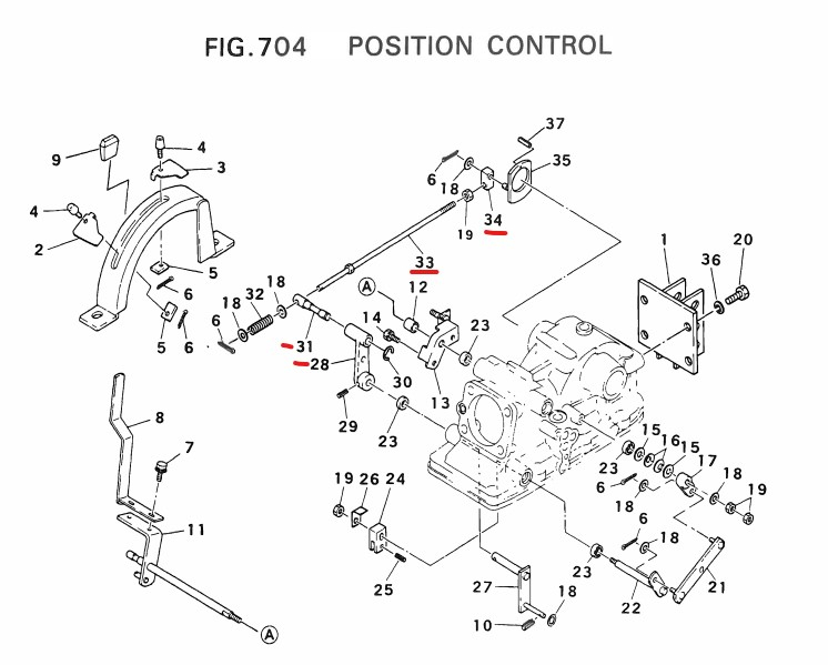

I recently got a post hole digger, so I had to have the height control working better.
Turns out the feedback rod from the 3pt (#34) to the hydraulics (#28) was locked up, causing it to not work properly.
In the image, pin 31 was frozen in lever 28. Rod 33 was pretty bent. I took the lever off and got the pin free (and snapped #28 in half while doing it :mad:. A friend was able to weld the cast iron back together).
Now that it's back together, the 3pt arms raise slowly following the lever, just like they're supposed to. I think I also got more height out of it too*.
* I just replaced the lift arms with shorter ones to get more height to pick up the post hole digger. I don't think I actually needed them, since the arms almost touch the fenders now o_O
