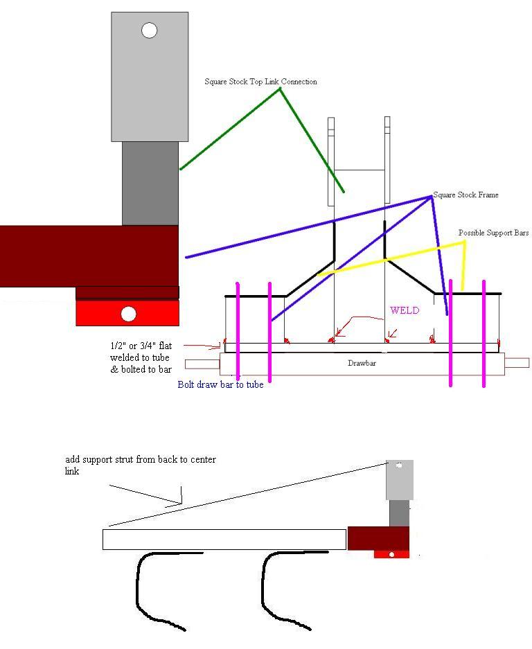

Here's an image of some suggestions to you idea.
Instead of welding the tube to the draw bar, weld some flat w/ holes so that you can bolt the draw bar on. The center link can be welded to the flat also and your side gusset supports can be bolted/welded to the side tube. Also, I suggest a support from the back to the front, as show on the image I uploaded. You can choose one single suppor inline w/ the center link or put a V shape. It does two things, when you put downward pressure on the center link, it pushes the back down (instead of stressing your center link post welds). Plus, it holds up the back end when you transport...depending on the strength of the main frame.
I hope the 'edits' are clear enough. /forums/images/graemlins/crazy.gif You can easily use grade five bolts to secure the 3pt draw bar to the frame.... if you are worried about breaking things off, it's a way to replace it.
Welds.... I suggest using 6011. It has deep penetrating arc. It's not pretty, but it holds. If you get really good, you can make a 6011 look like 6013 /forums/images/graemlins/cool.gif. Remember to bevel edges to give more area for the weld to penetrate and choose the correct sized rod.
Well, have fun. (And there is no such thing as OVER building..... /forums/images/graemlins/grin.gif /forums/images/graemlins/wink.gif /forums/images/graemlins/tongue.gif)

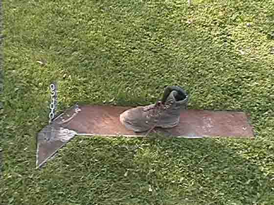

I wouldn't weld to the drawbar either...Why make a good bar into a single use item? Today,I made a pipe puller to pull behind an Oliver 1850.Just welded some Cat. 3 lower link pins to the inside corner of some 4" X 3/8" angle I had laying around.Burned them down with 6011 and a top coat of 7014 to hide the uglies.Got dark before I thought of taking pictures...but I do have one of the start...
