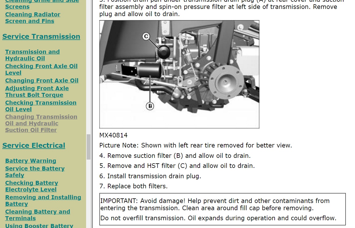

Had a massive hydraulic fluid dump last week. Started the tractor to move snow in 5 degree temps. Did a few odds and ends waiting for the tractor to warm up. When I came back to it, it was dumping the last of the hydraulic on the ground. Leak was a blown-out gasket at the high pressure hydraulic filter base. So I installed a new filter, filled it up with Hy-Gard (not Lo-Vis Hy-Gard). Got several hours out of it and a few days later had the same thing happen at about 10 degrees. Fortunately it blew as soon as I started it so it saved a bunch of money in lost oil. Thinking I need to put Lo-Vis in it next fall but I sure hate to buy 22 quarts of John-Deere liquid gold twice a year. Anybody else have a problem like this? OEM filter, tightened to base contact +1 turn.

Is this the transmission HST filter LVA16054 rather than the suction filter LVA14703 ??
Maybe building pressure somehow in the HST transmission?
I need to ask, is there a chance the transmission has been over filled? That might lead to high pressure problem?

I have not learned or read that this is a "high pressure" filter. I would re-phrase that to pressurized filter based on the fact that oil was spewing out. At what pressure it operates, I don't know. It's possibly/probably some type of slip-stream off of the discharge circuit.
Yes, the LVA16054
Entirely possible............based on the oil spewing out.
No. And I doubt that overfilling could cause high pressure because I think it's basically a sump.
All good points. I do intend to talk to the service manager next week and get a John Deere opinion.

I was trying to interpret what was said in the operator's manual.
