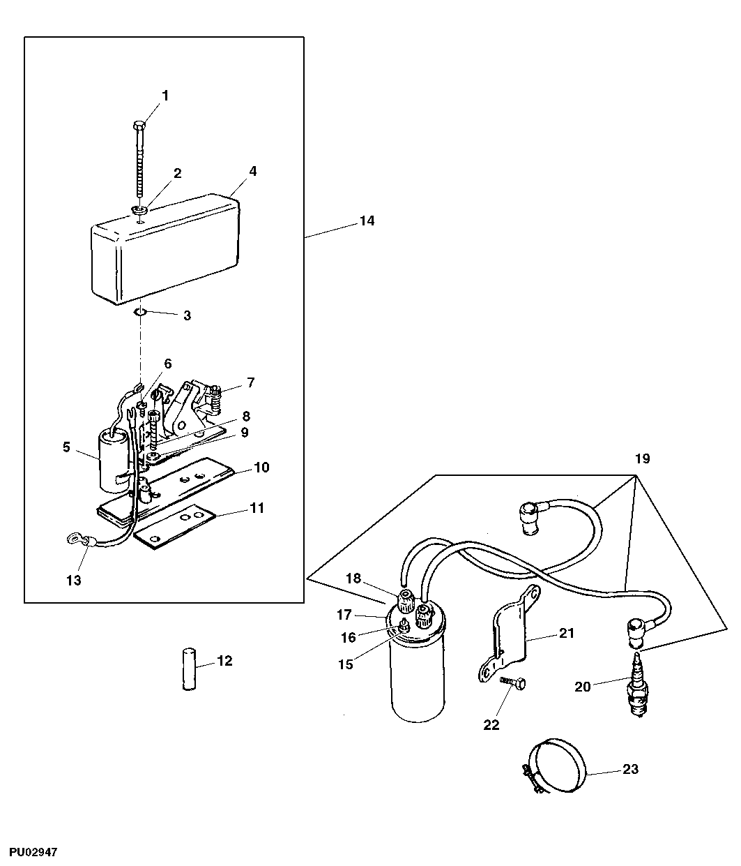

Found the click/kulunk sound at a small black box attached with the starter solenoid under the battery plate area. Looks like a fuse link or something. Sounds like a bi-metal switch inside it. only about I inch long with two wires attached, one going to the starting solenoid. I removed it and jumped the two wires and the wires got really hot immediately so I stopped.

I think it was a circuit breaker opening and then closing.
Is this the part?

I don't think so, this was a small flat item about 1/4 inch thin, 3/4 inch tall, 1.5 inch long, with two leads where two wires connected. One of the wires came from starter solenoid, not sure where the other came from - both red. Bolted on with one of the starter solenoid bolts. Dealer did confirm it was a circuit breaker though.

BTW Item 1 in that parts drawing shows to be a circuit breaker and it's like $300.
It's wild with what looks like a large capacitor and a set of points inside.
