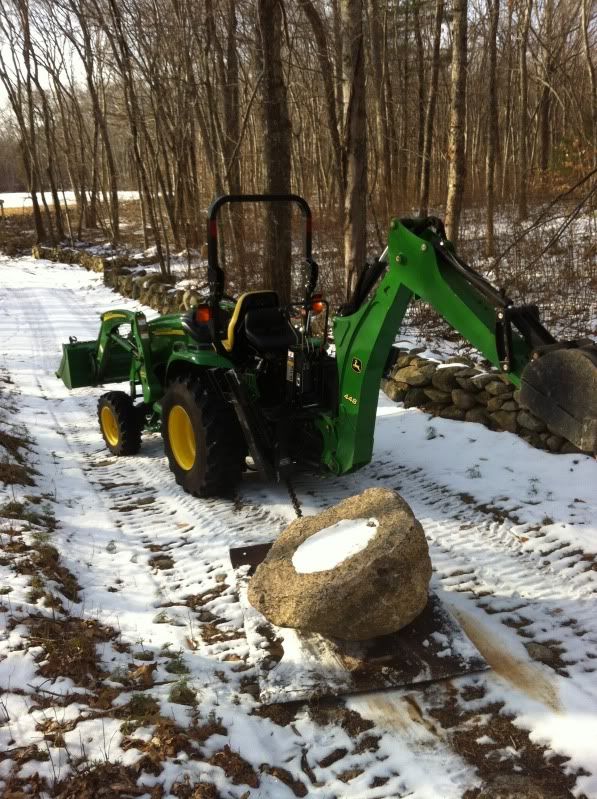

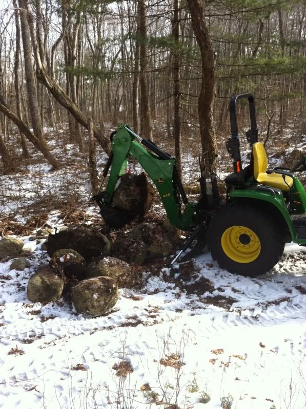

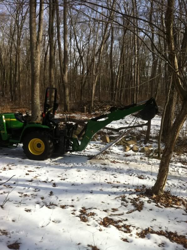

Well I started on the 400 ft rock wall I need to build. I got this old rock sled to help with the big stuff.
Sadly the rocks are too much for the allis so out came the Deere
A handy way to back the sled into position
I had thought of getting a thumb for the hoe. I'm glad I never did. This hoe is very strong. A thumb would limit what I could lift in some ways. Soda can on rock in bucket for size. It has no trouble with stuff this size.

Nice. I have a 3320 with a 447. It is a good hoe, but I could use the power of the 448 at times.
   / 3320 and the 448 hard at work
It is a heavy bugger. I use the outriggers to help assist when hooking it up. Still just a 2 min job. Takes longer to pin the 3pt back on.

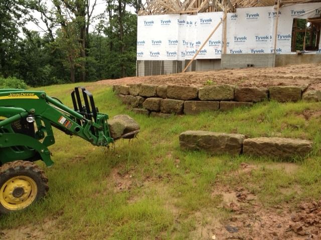

well for it's size, it can lift whatever I tackle, any more I would worry about tractor stability so it is sized perfect imho. pretty much the same for the loader 300cx. It will handle whatever I can throw at it, any more and I would probably break something or tip.
