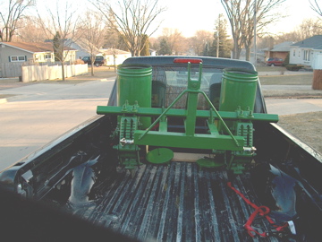

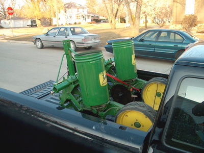

after a long drive home with the new planter.
