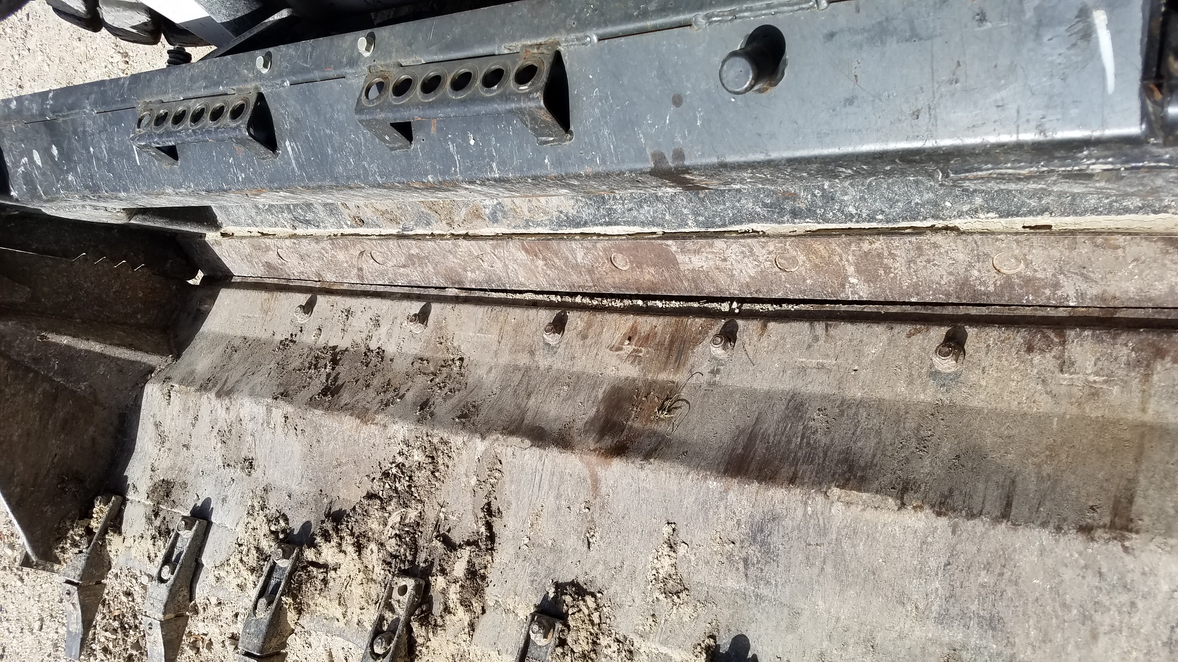

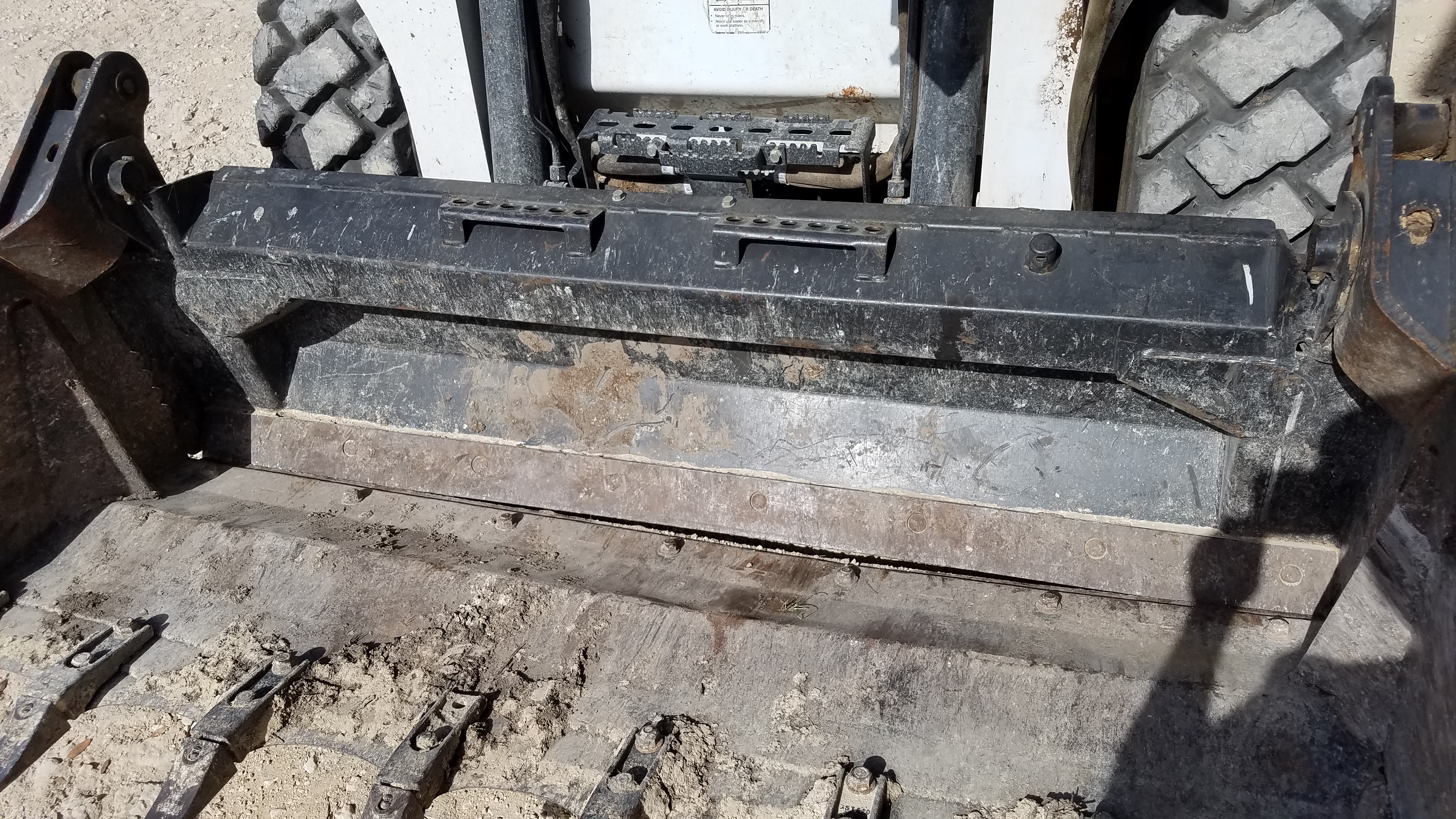

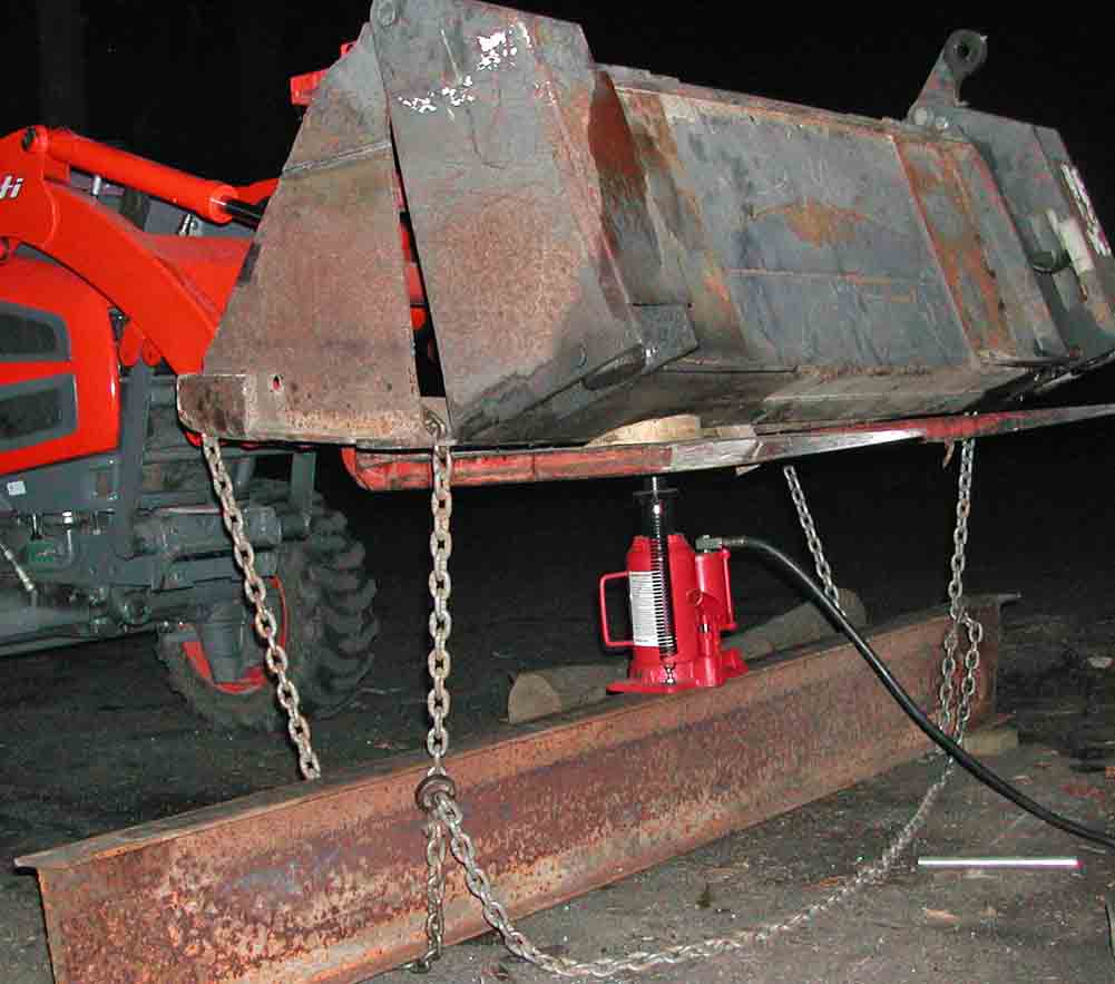

Any ideas on how I can straighten this bucket on a 4n1 or is it trash? It is bowed in the middle.
Thanks in advance.

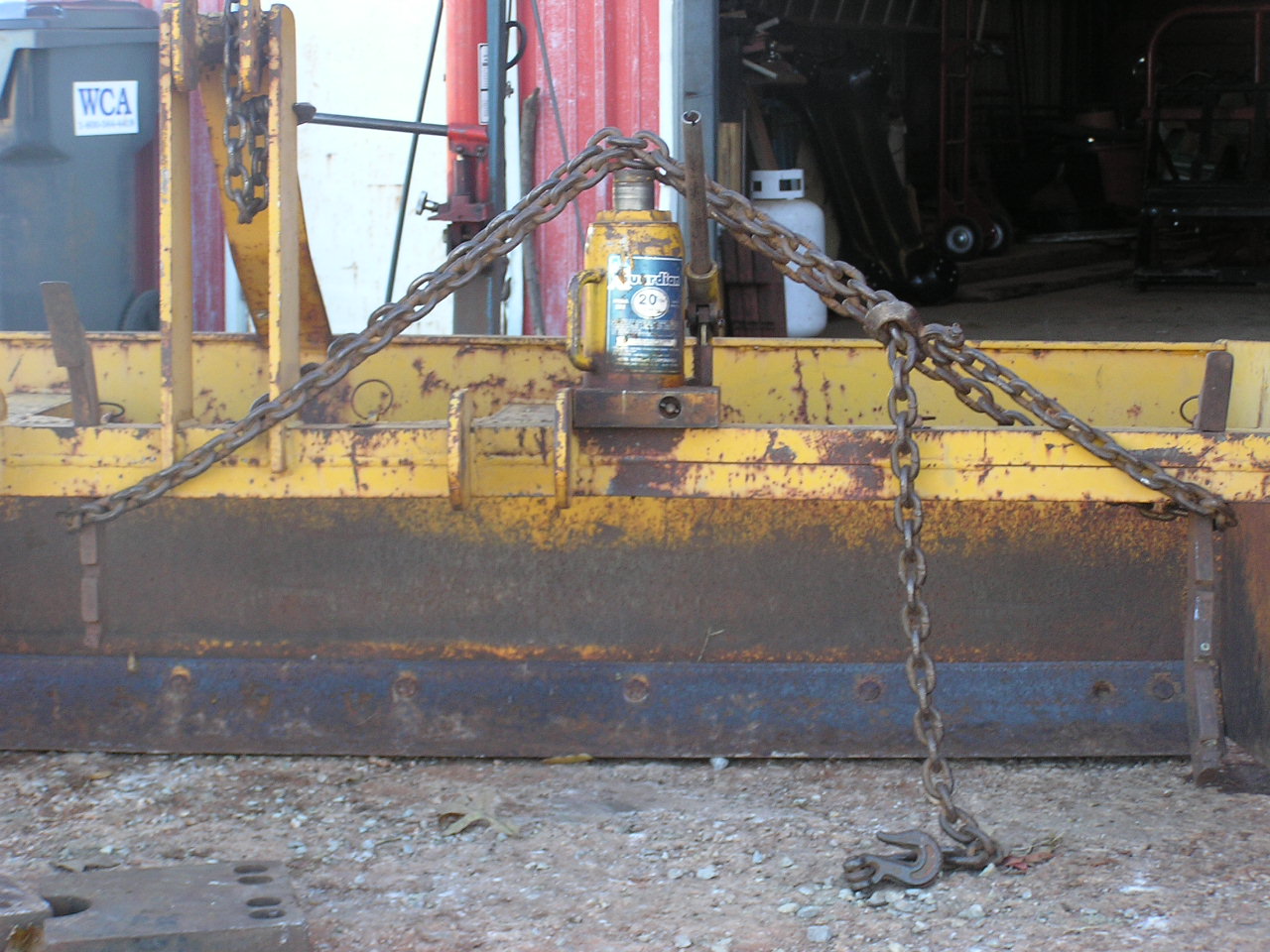

Put a bottle jack under the low spot. Hook a chain at the top edge of one side of the bucket, run it under the jack and hook to the top edge of the other side.
Go slightly past straight, as it will spring back.
Or turn the bucket upside down and rig it like this:
   / 4 n 1 bucket repair #3

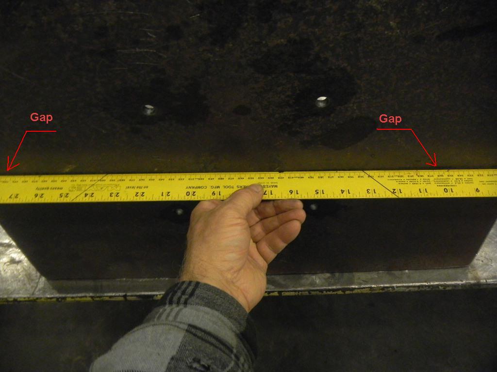

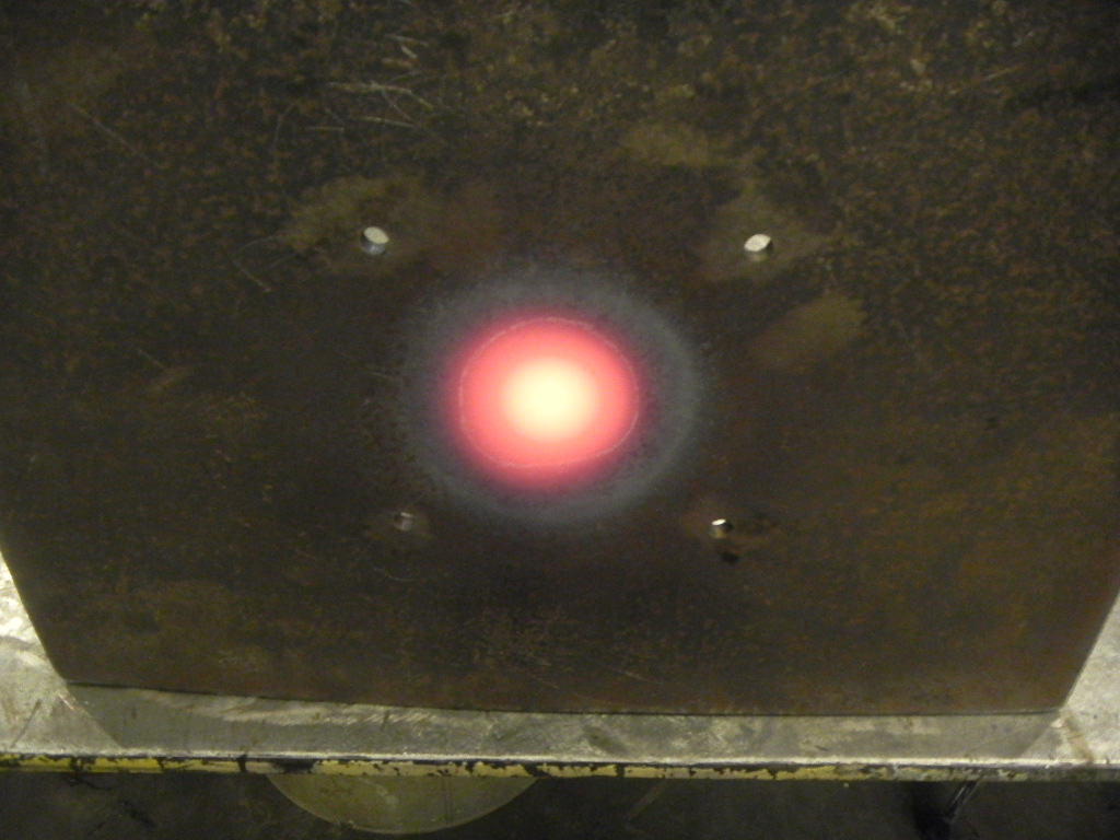

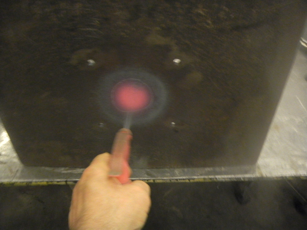

If you have a rose bud, and oxygen & acetylene torch you could try to heat shrink it. I would go with Xfaxman suggestion of the bottle jack and chain first! Sometimes buckets are so reinforced. Only force will fix them.

Guys, thanks for that advice. I didn't think of the bottle jack. I looked at my portapower but it's not strong enough.
I'll update when I have time to work on it.

I bent the middle of my 83" Cat bucket.. I was pissed... but a friend of mine used his Cat 330 excavator to push it back to straight by flipping the bucket over on 4x4s and pusshing down in the middle with his bucket. Worked great ant took about 1 minute.
   / 4 n 1 bucket repair #8
330 size excavator! I bet it bent it back.:laughing:
Iirc my 4 in1 had a cutting edge on the back of the (moving) "clam". It looks like your's does also (the bolts in your pic). I'd remove that before you try to bend it back. It may have an arc to it and bend the clam back as far as you can then try to bolt the c/e back on with the arc reversed.

If the bottle jack and chain doesn't work. Wrap a heavy chain all the way around the middle of the bucket with the bucket closed. Once the chain is on slowly open the clam shell. As the clam shell swings open it will bend the clam shell back into position. Use a long 4x4 along the top and bottom of the bucket back to spread the load and not bend the bucket back. Cut a section of steel pipe and place it over the front cutting edge so it won't cut the chain.
I easily bent the front clam shell back into position on my CAT backhoe using this method.
If you heat it up you will lose any tempering.
