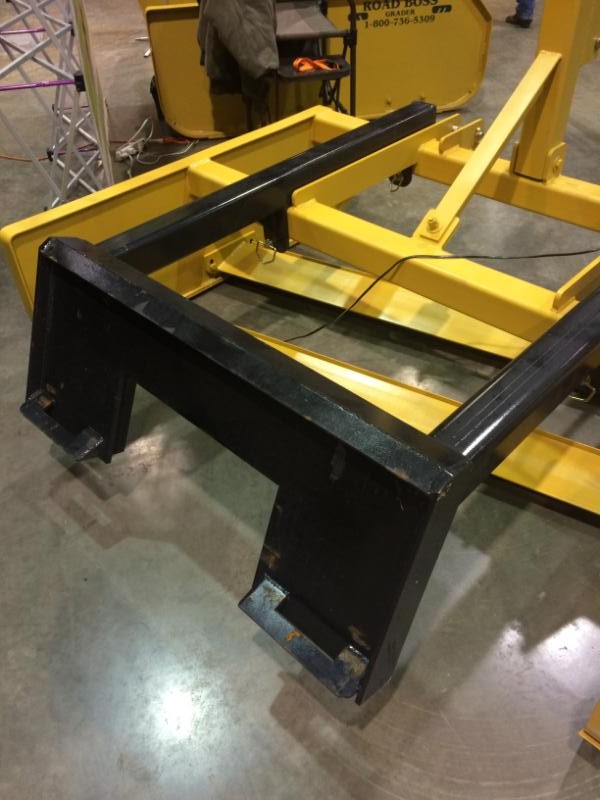

Faxman,-----------------------------------
How would a toolcat do at road maintenance?
------------------------------------------------------ Am just curious.
It would be fantastic with a land plane like this front or rear mount: Skid-Steer Attachment :: Road Boss Grader
I have used a 6' landscape rake on our gravel driveway, worked good. :thumbsup:
