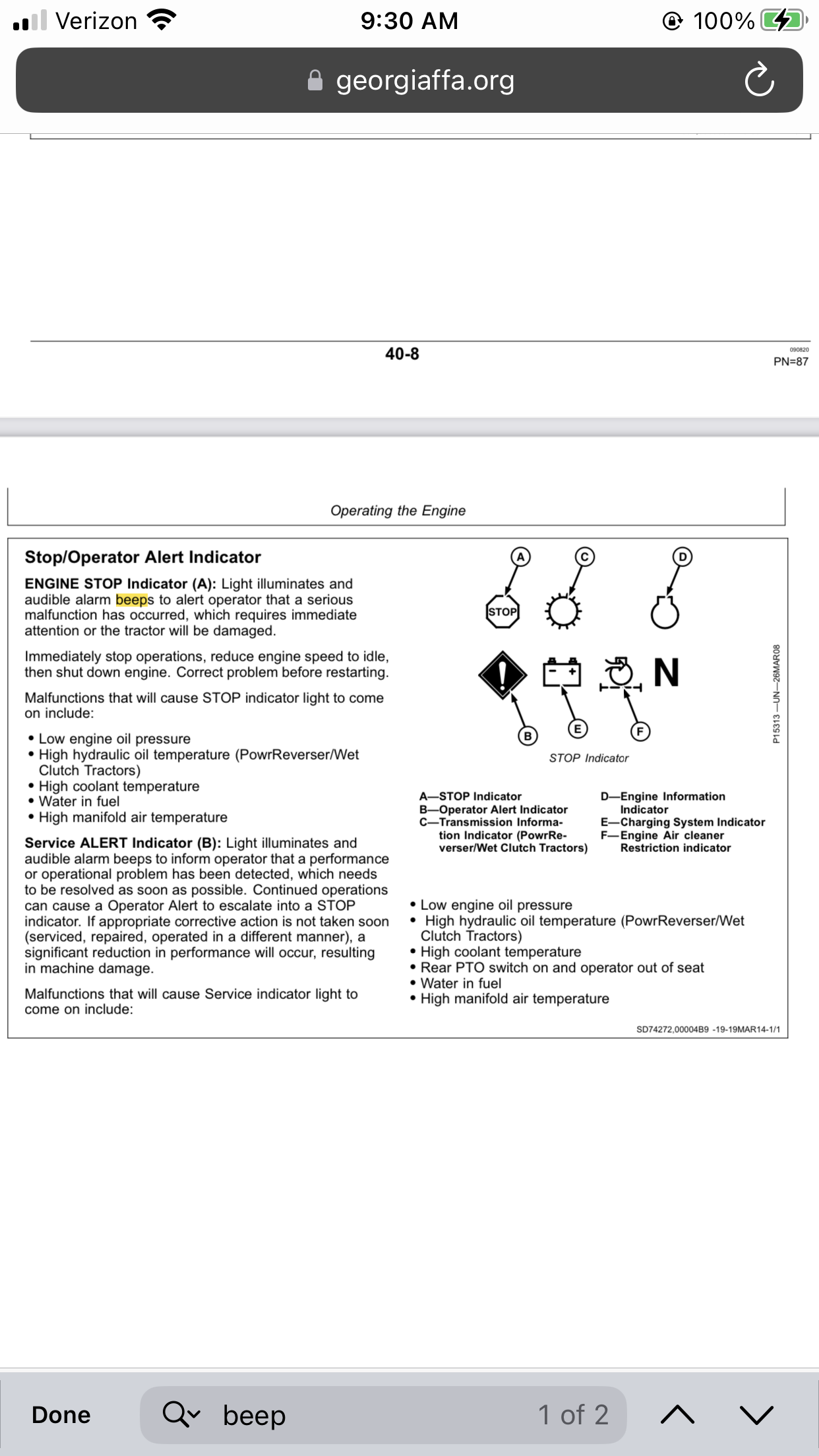

I turned on my 5055e(new in 2015, had its annual last fall, now at 727 hrs.) this morning and let it idle a few minutes while gathering tools, then I heard 5 beeps. No lights were on to indicate anything wrong. I used the tractor a few minutes, then called my local Deere, they had no idea what caused the beeps and said if no lights were on they had no idea what to tell me and if the tractor was runninng fine, just use it. Does anyone know what the beeps mean?

This is just based on a google search; I have no personal knowledge.
Are you sure that all of your warning lights are operational (bulbs all light up)?

Do all bulbs light up? Believe so. Will followup on the alert indicator diagram & explanations you sent. Thanks.
