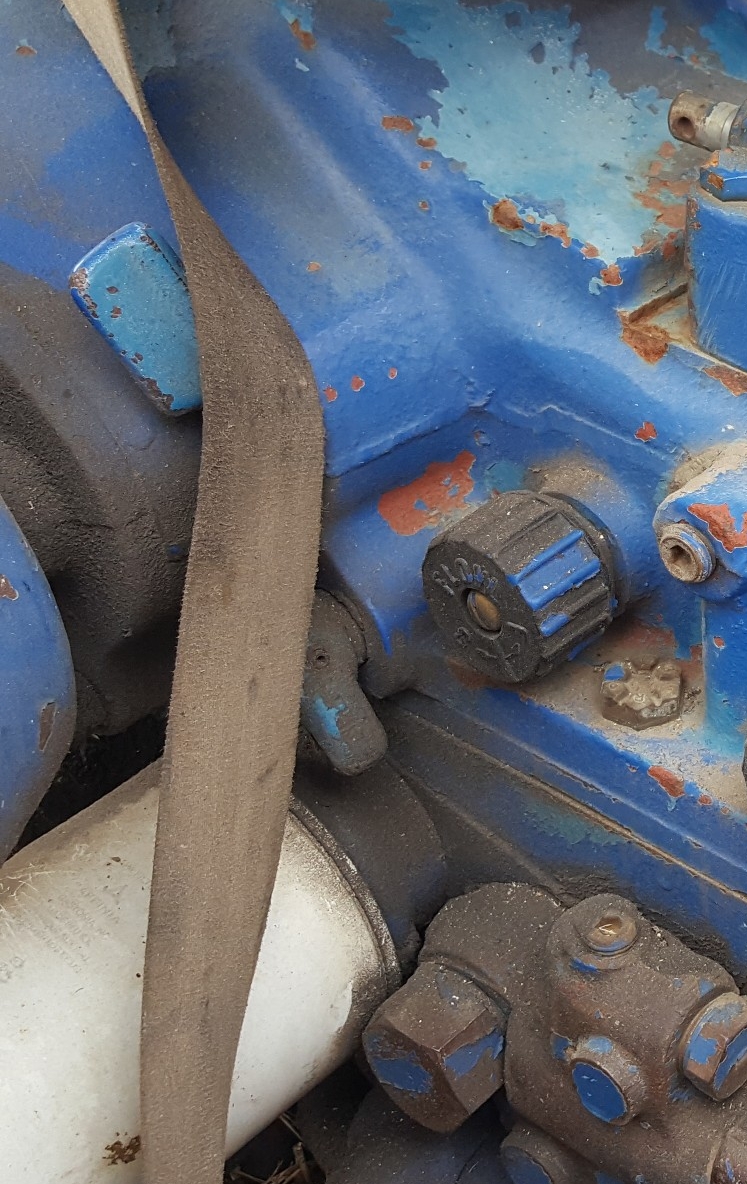

Does it have a lever or knob to adjust the rate of decent for your 3 point hitch? If so it may have gotten closed, hitch would go up but not come down.
   / 5600 Ford... I got it up, but I can't get it to go down? #4
