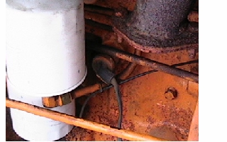

Hey all,
Well we came home late last night to find that the dealer had dropped off the 580 backhoe right in front of the house. Got to move it to a better spot. It has been below zero, F. She wouldn't start last night so I plugged her in [see photo] at 7pm. Today, she still won't start. The block is slightly warm around the plug you see but ofcourse the rest is like cold. The electric is flowing, tested that. She cranks real slow, almost like the battery was going dead. Tried jumping from 4x4 battery, still same slow turning, cranking. Gave a couple of shots of starter spray [did not like doing that] into the air intake "mushroom", nothing but same slow whirl turn. At the dealer, ofcourse she started just perfect everytime. This week it is supposed to get around 20 F, yeah right.
Can I use any engine block magnetic heater on the engine?
Any ideas? Thanks all /forums/images/graemlins/confused.gif

Re: 580c won\'t start & it\'s only -10F
yes, use your magnetic heater on it, and i'd hook your truck, or car to the battery, and let it run for awhile ( or a charger). then, if yours has manifold heat, hook your booster cables directly to the heater on the manifold ( carefull to only get the stud the cable hooks to). and let the truck run ( or not if your really worried about your alt. didn't hurt ours). this will give you heat the entire time your cranking, w/o draining your tractor battery. /forums/images/graemlins/cool.gif

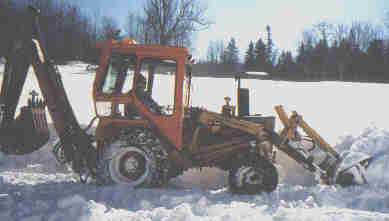

ok. here's a pic of our old hoe, after that 36" snow storm we had a couple weeks ago
