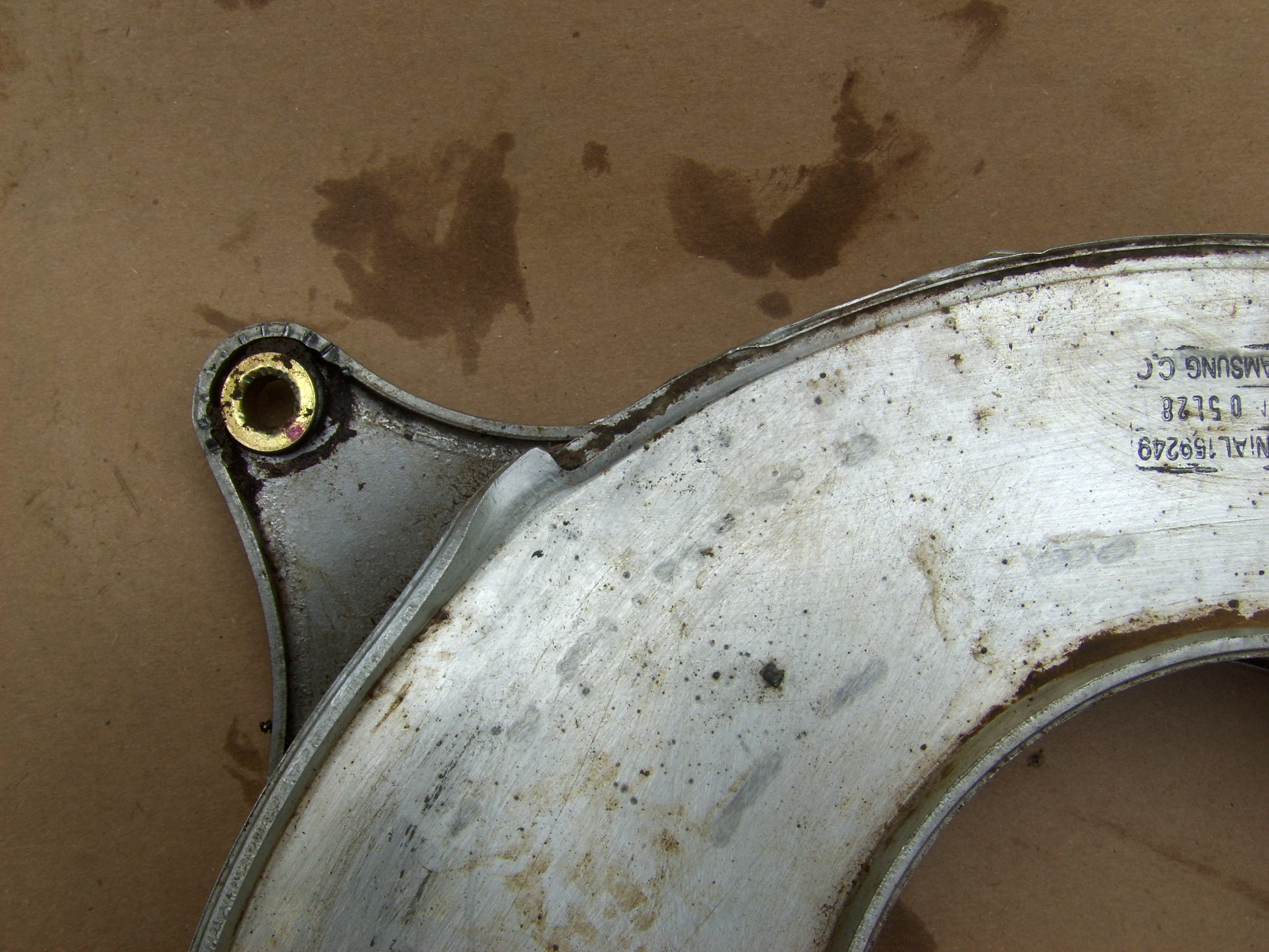

switches cooler 006.JPGswitches cooler 007.JPGswitches cooler 008.JPGUpdate; I got the cooler out. It does have the part number stamped on it. It is the one for the Power Quad. It did not look bad from the fittings side...............but the engine side was real bad. It had been pushed in the engine damper and it won. So no fixing this one.
I was able to find a new cooler on ebay, but it was in the U.K. I contacted the seller to see if he would ship to the United States. I am waiting for a reply.
