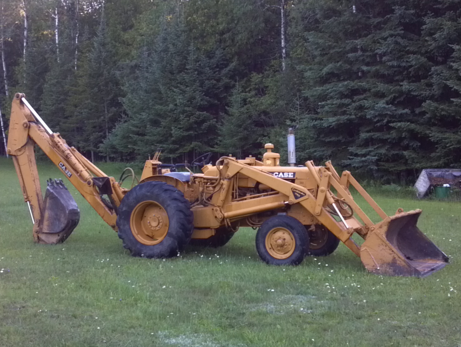

Hi All. here is my "new to me" 67' Case 580CK backhoe.
2012-06-22_20-24-53_915.jpg :D
I have a lot to learn about this Machine. This is the first piece of heavy equipment I have ever owned (I have used skid-steers and such before). I'm planning on using it to build trails at my property in the UP. Thanks in advance for all your help:thumbsup:

Wow, that 580 looks really clean for its age! Looks a lot like my 1970 580CK, except mine has a gannon instead of a backhoe. Did yours not come with a ROPS? Not sure if they had that in the late 60's? Also, it is gas or diesel?

HA, it looks good from a distance but shes been worked HARD. I see some welded cracks in the loader frame than when I raise the loader in the air water leaks out :rolleyes: .. No power supply but a generator where the machine is atm so I can't grind and re-weld yet.. The upper bushings for the loader are shot BAD. It also has a ton of Hyd leaks. After sitting the clutch likes to "stick".. I just bought the steering cylinder rebuild kit for both sides. Many of the other cylinders need to be rebuilt too.. I had a chewed up O-ring in the filter awhile ago.:rolleyes: .. No ROPS or any provision for it :laughing: .. It is the diesel version:thumbsup: Runs like a champ but when it warms up it looses oil psi :mad: The guy I bought it from had the heads rebuilt but didn't mess with the bottom end. . Right now I have the Hoe off due to a hose leak on the swing cyl. What a mess. I replace that hose last weekend.. I'm now replacing the supply hoses and quick connect fittings seeing how easy it was to remove the hoe. Might build a hyd. log splitter or some thing to fit the frame mounts.. Time will tell........
Thanks for listening.. :thumbsup:
