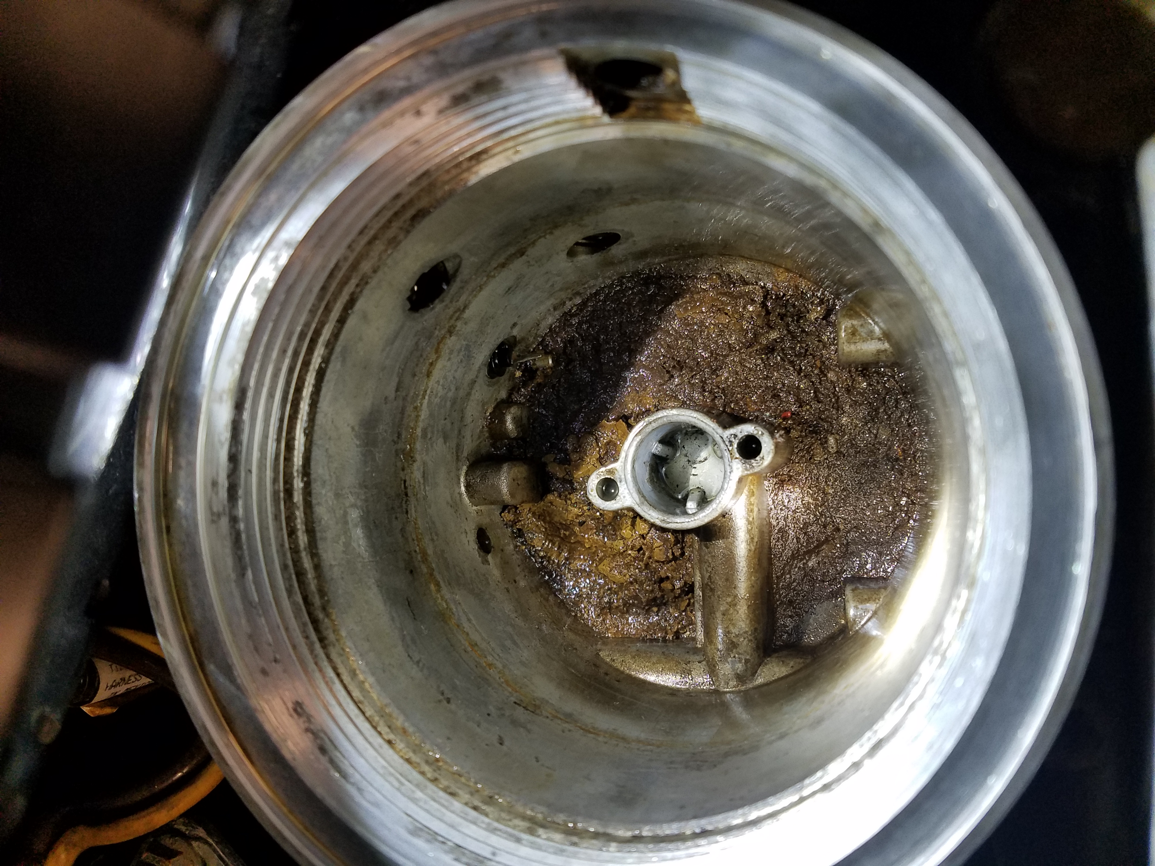

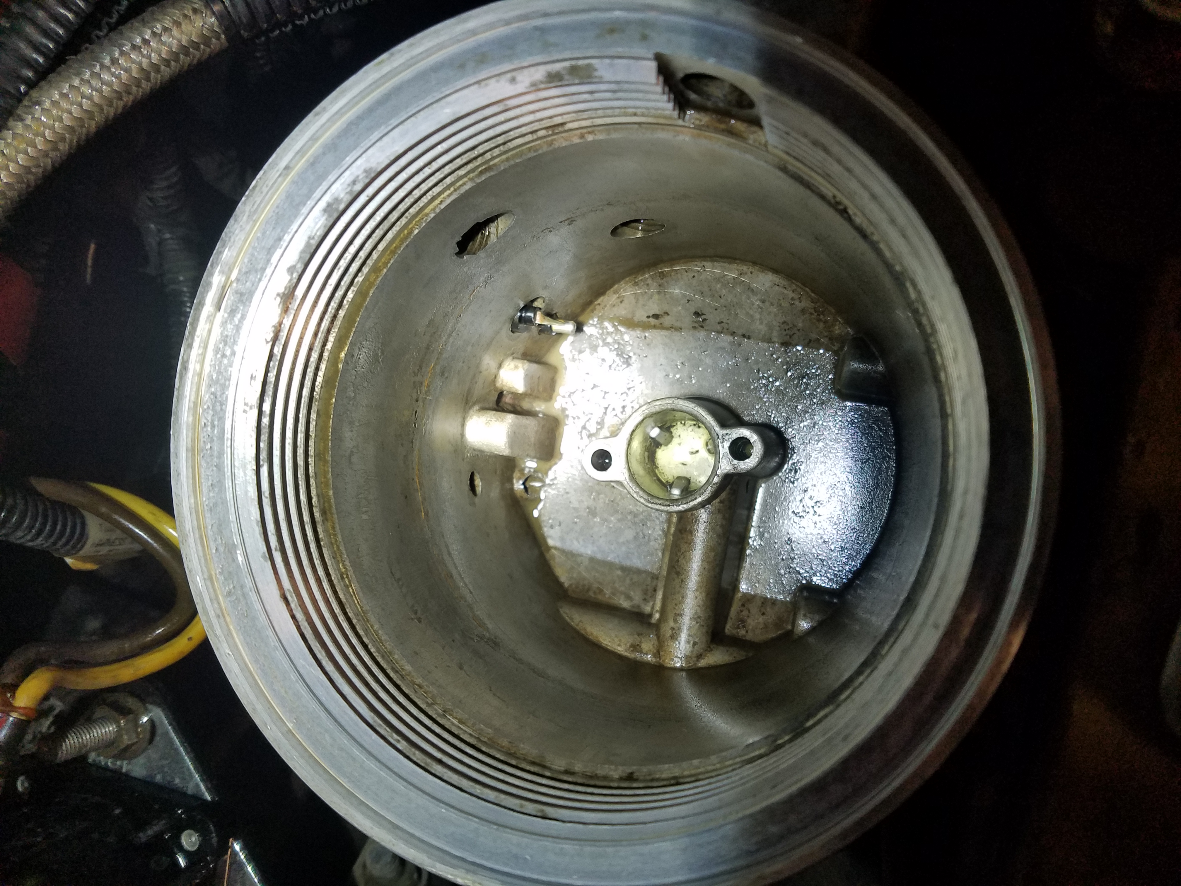

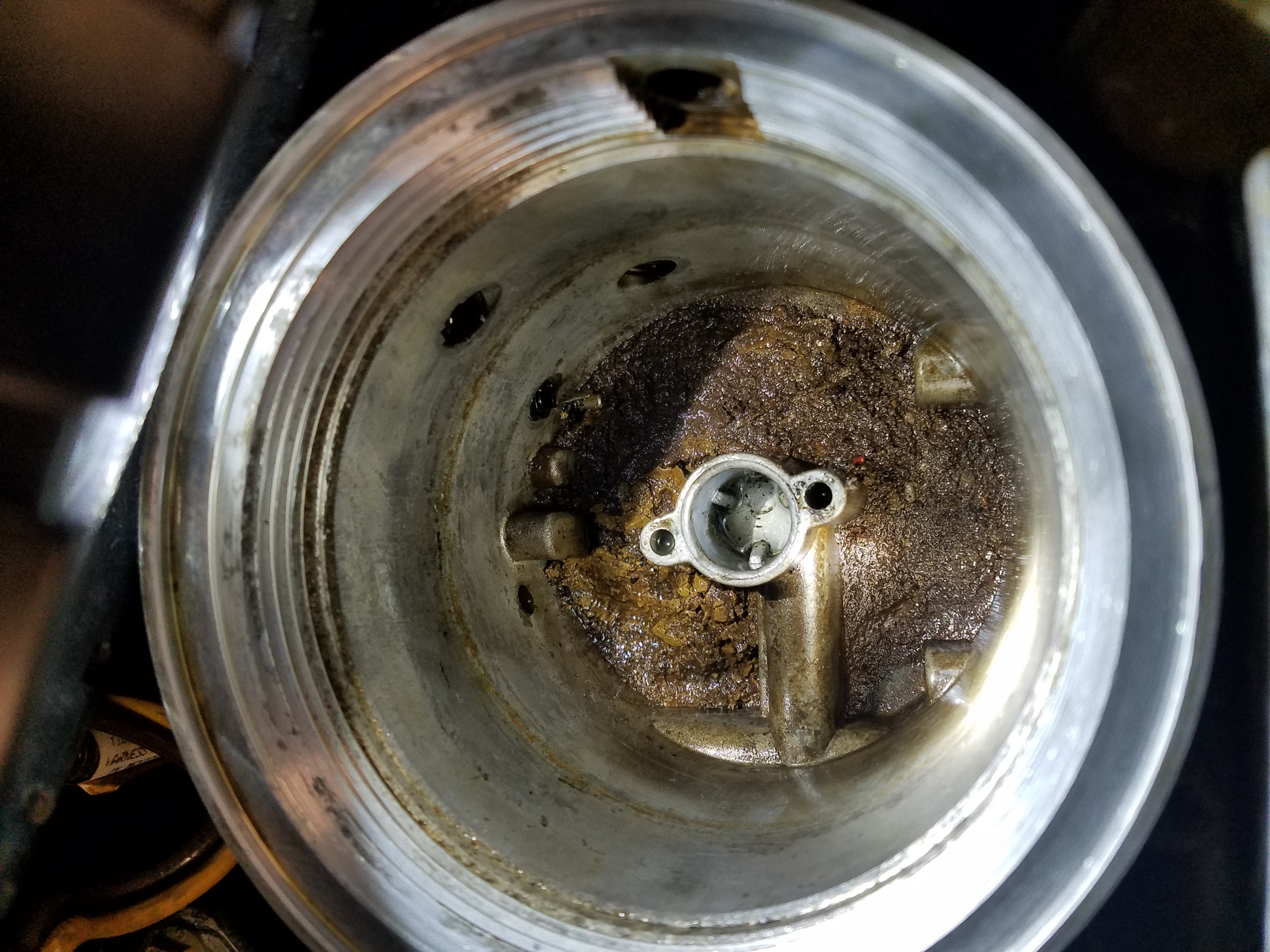

I think I found out where my miss came from fuel bowl was pretty bad, about a quarter inch of sediment in the bottom also rendered my line for my water separator useless.
I was beginning to wonder why the drain didn't work.. 20161204_224944.jpg 20161204_225715.jpg 20161204_235142.jpg
I'm guessing the diesel extreme was breaking some of it loose, the O-ring on the bottom of the inlet tube that the filter rides on wasn't in very good shape I replaced it.
The fuel bowl heater was unplugged in the bowl and the plug in on the outside of the bowl was off too.. I plugged them both back up. Haven't noticed it being hard to crank..
Does this fuel bowl heater just assist the glow plugs? Is it really an important thing incase it wasn't working. There was also three metal pieces little smaller than a dime mixed in with the sediment. Would that indicate that the fuel bowl heater is burnt out? Thanks

Fuel bowl heater only needed in areas cold enough to have gel issues. I left my buddys unhooked, and removed the AIH.

I agree the fuel bowl heater and air heater element are not needed in warmer climates. It looks like the
truck you have might be neglected in the maintenance area. Keep an eye on the fuel quality. If you have
trash in the tank then schedule tank drop and clean. Keep an eye on the antifreeze and watch for engine
oil in the coolant. I replaced the seals in my oil cooler a couple of months ago. It is a nasty job and I spent
lot of time trying to flush oil out of the coolant system.

You'll want to do the hutch and harpoon mods anyway (if they haven't been done already) and I can guarantee you that the pickup umbrella has broken apart by now. Two ways to get at the fuel tank, one is to remove the bed and the other is to drop the tank. If you have equipment to lift it, pulling the bed off is easier.
