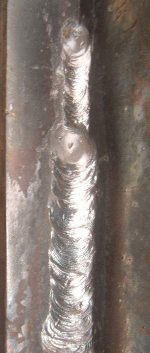

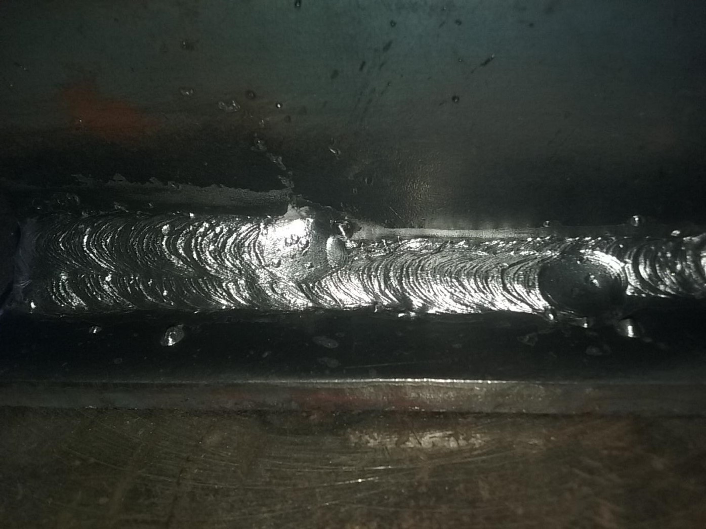

7018 weld advise. Pics.

I think you did good, you can't expect to get to the bottom with no bevel. You've got your heat better than before

When I was welding pipe in younger days; always bevel with a flat land width of rod diameter and gap same as rod diameter. Do root pass with 6010 DCR or 6011 AC/DCS. All the low hydrogen (7018 and others) or the 6013/14/7014 rods do not fast freeze enough to make a properly gapped root weld. If you root pass does not show a definite bead above the surface on the reverse of a single side bevel you have a weak weld that will not pass inspection of any type. On a double sided bevel it is very important to clean (with a thin grinding wheel) to remove any slag leaving bright metal. Guaranteed weak joint. I never use lo- hydrogen rods as I have no rod oven to keep dry. 6014 and 7014 are good multiple pass fillers. On A36/A54 steel, 70K PSI and higher of any type is a waste. 6010 and 6014 produce a weld strength equal or > the pipe strength. My opinion, there are many weld procedures that would refute that.

I have a thread on tbn somewhere asking about 6013/7014/7018 comparisons for filler/top pass, and I came away with the opinion that for most hack welders like myself, it's all the same except 7018 is also a prima-donna when it comes to storage. BTW outside of the US, 6013 is used for root passes. Here's a quick article: E613 Welding Rod, What Can You Do With It? | Everlast Generators

After finding a fixing a leak on my new excavator i did some passes. Heated the plate up and warped the crap out of it. Just burning mindlessly. Back and forth 6011 and 7018.
