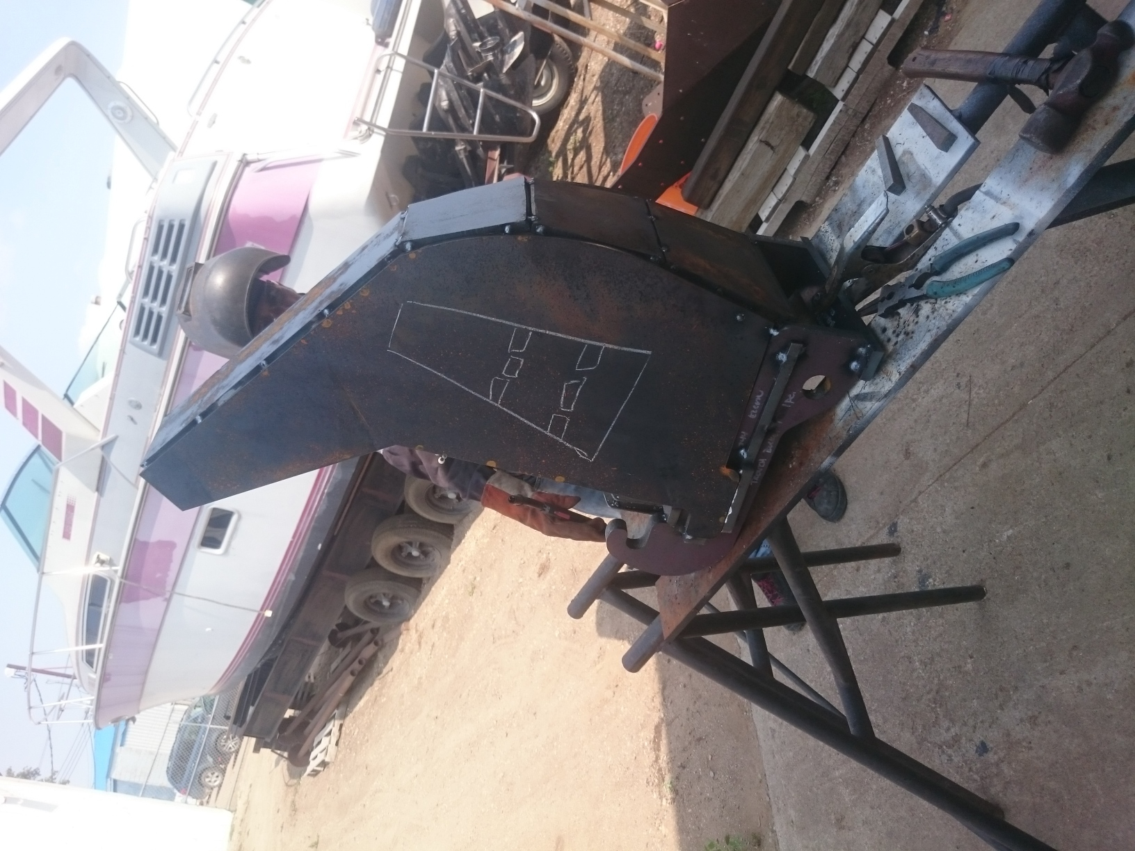

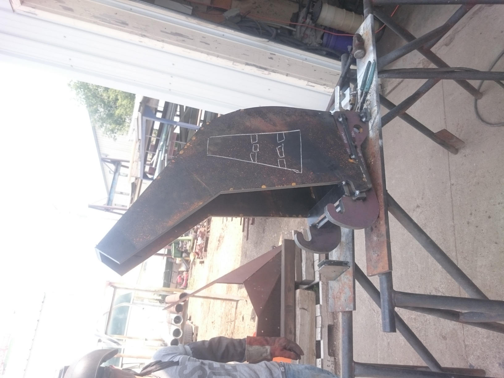

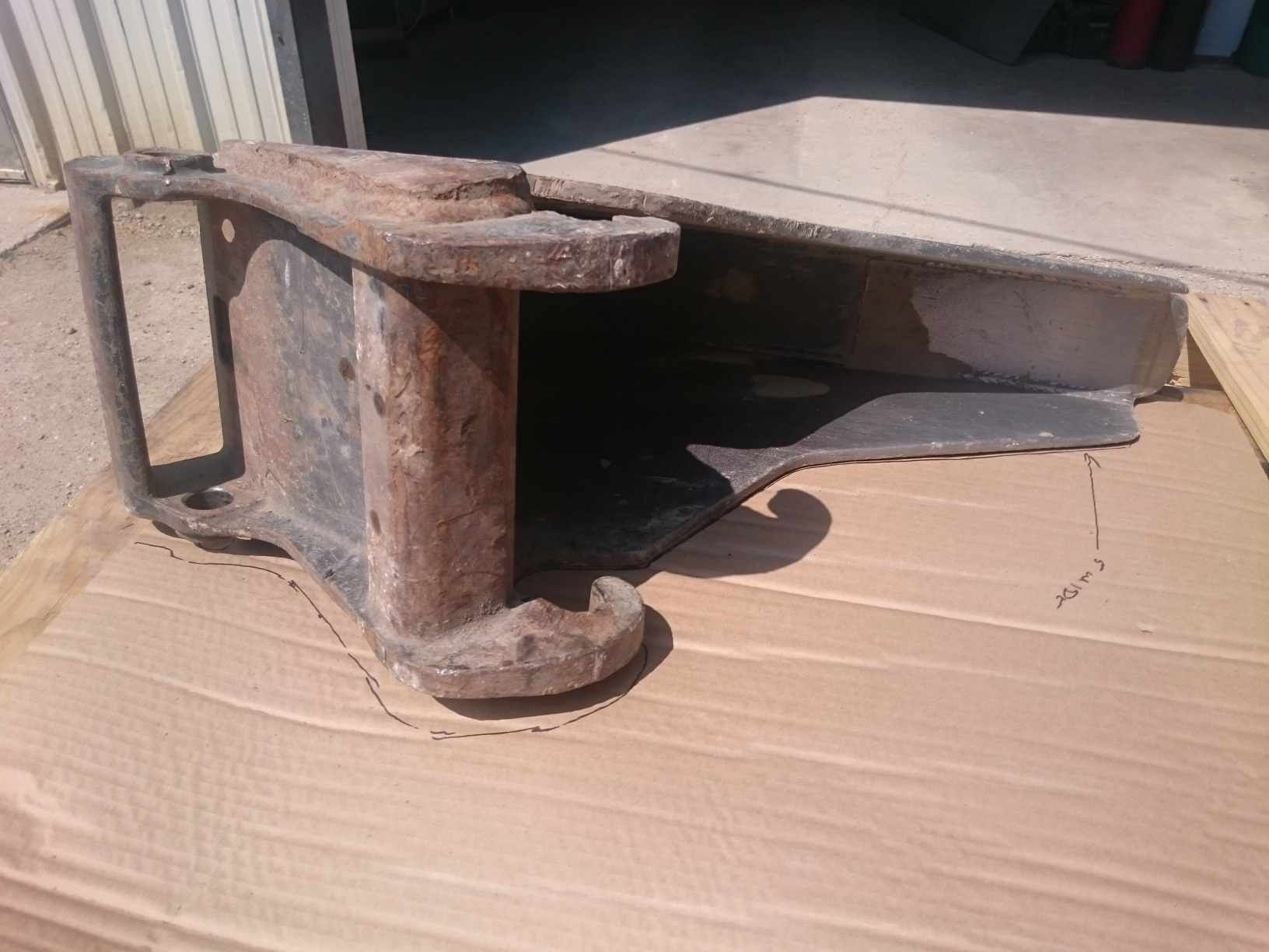

narrow buckets are a pain, depending on depth I built a sort of duck bill bucket for my E32, it will dig a 5 inch trench deepest to date was 3 feet though it could go deeper the trick is have little to no sides and not dig so aggressively you pack the clay into the bucket
the trencher on the skidsteer does a nice job but I have lots of boulders and it does stall out many times on long trenches
here is the bucket I built for the E32

the one I welded up the bottom is 5 inch the top same as the machine width. the picture is on the older machine the grapple is defiantly wider, never put on on the e32 so no issues, with such a taper on width plus length it does not clog unless one totally fills the bucket and compresses it, dug all my irrigation lines for the yard, power and gas to my shop and a few larger 4 inch polly pipe I can push wires, coax and 1 inch water when needed to specific locations around the acreage
trencher would be faster problem I have the ground under the topsoil of 6 to 8 inches is gravel and large boulders, the trencher would stall out and we either move direction or dig the boulder out, the backhoe works way better, in these conditions
   / 8" or 6" Trenching Bucket For JD 26G #10
What is the thickness of the steel you used? Did you end up putting a tooth on it?
