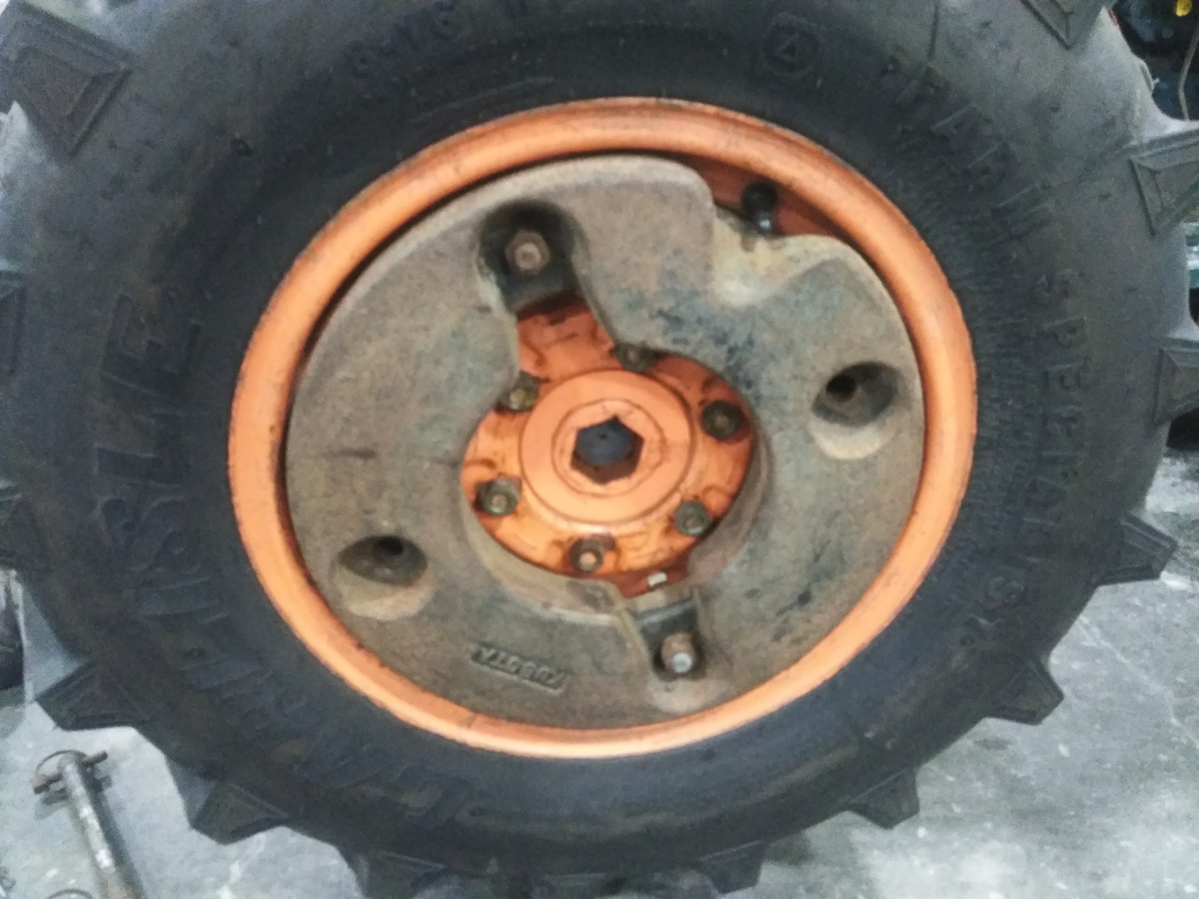

I have factory wheel weights, they are held on with incorrect hardware, makes it difficult to remove as Im assuming the original hardware was a carriage bolt of some type, Ive asked at the dealer, they were not able to find a part number, can anyone offer a suggestion?
A standard carriage bolt will not work cause of clearance issued with the head to rim. I can modify but Id rather just buy the correct hardware. 058.jpg057.jpg056.jpg

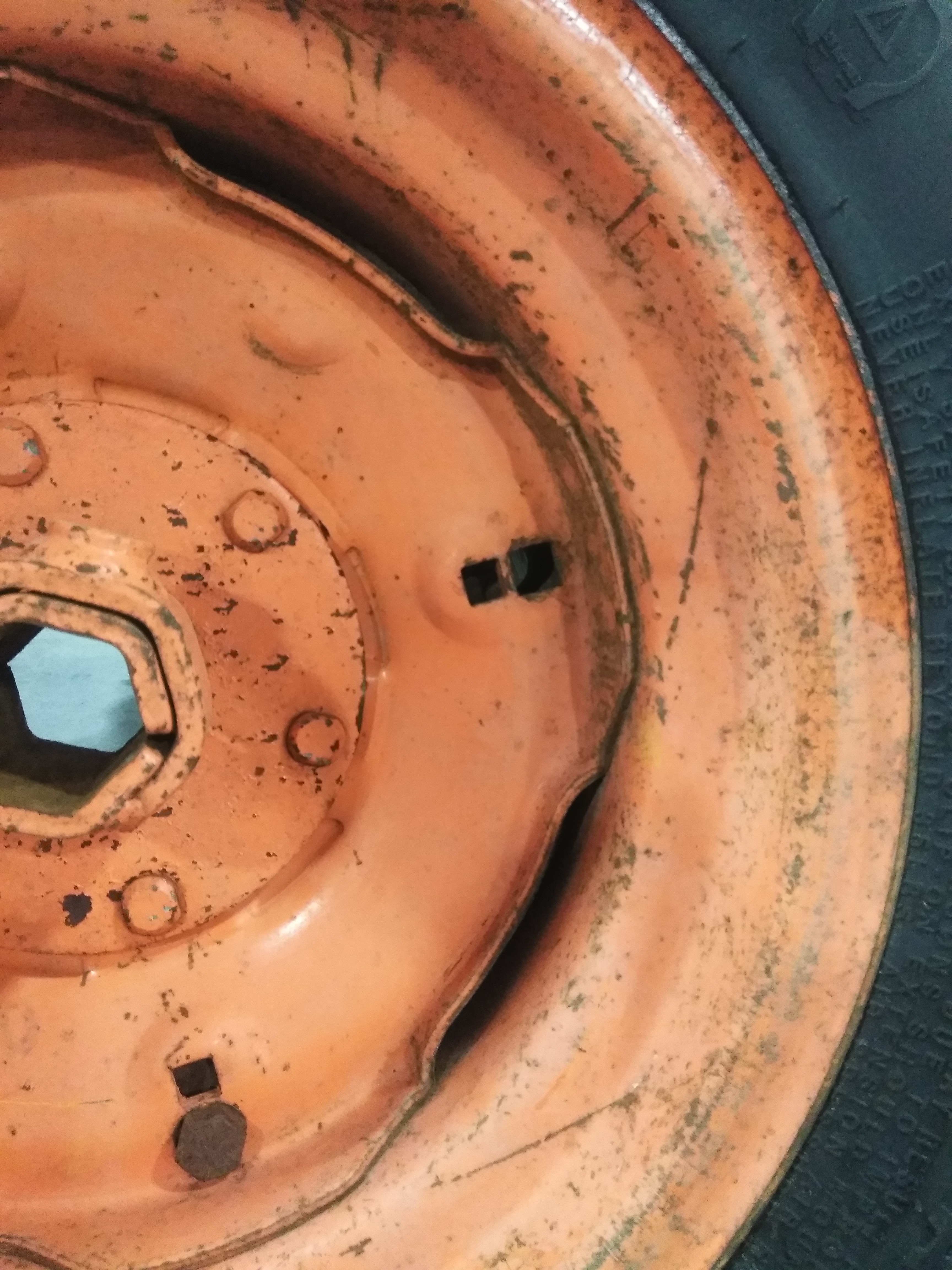

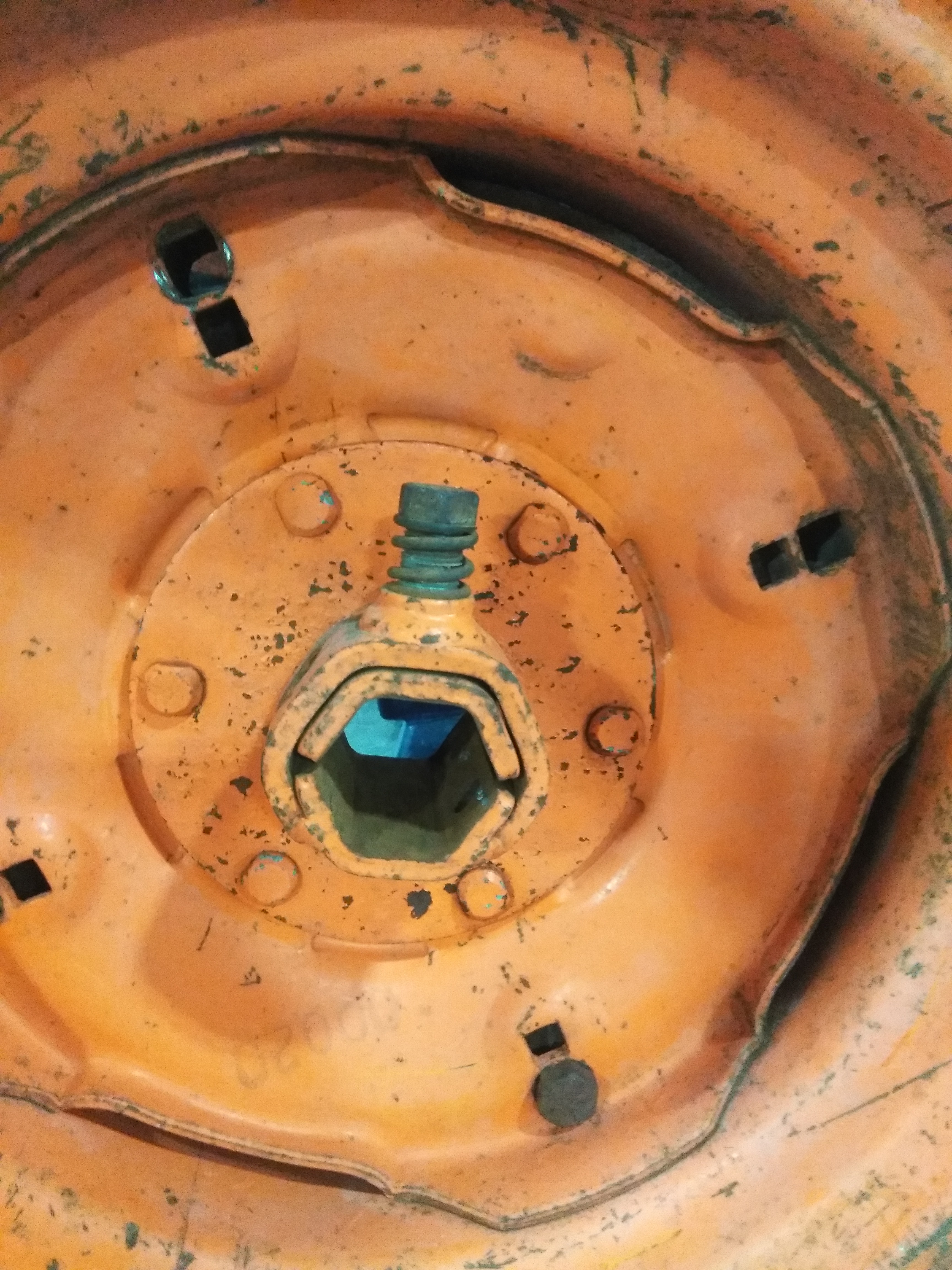

Can someone tell me the purpose of the large bolt with the spring in the center as seen in this picture, Id assumed that the center of the rim that comes in contact would be crushed slightly by tightneing the bolt but not in my case, it seems to still be loose on my axle regardless of how much I tighten.
Any why the058.jpg spring?

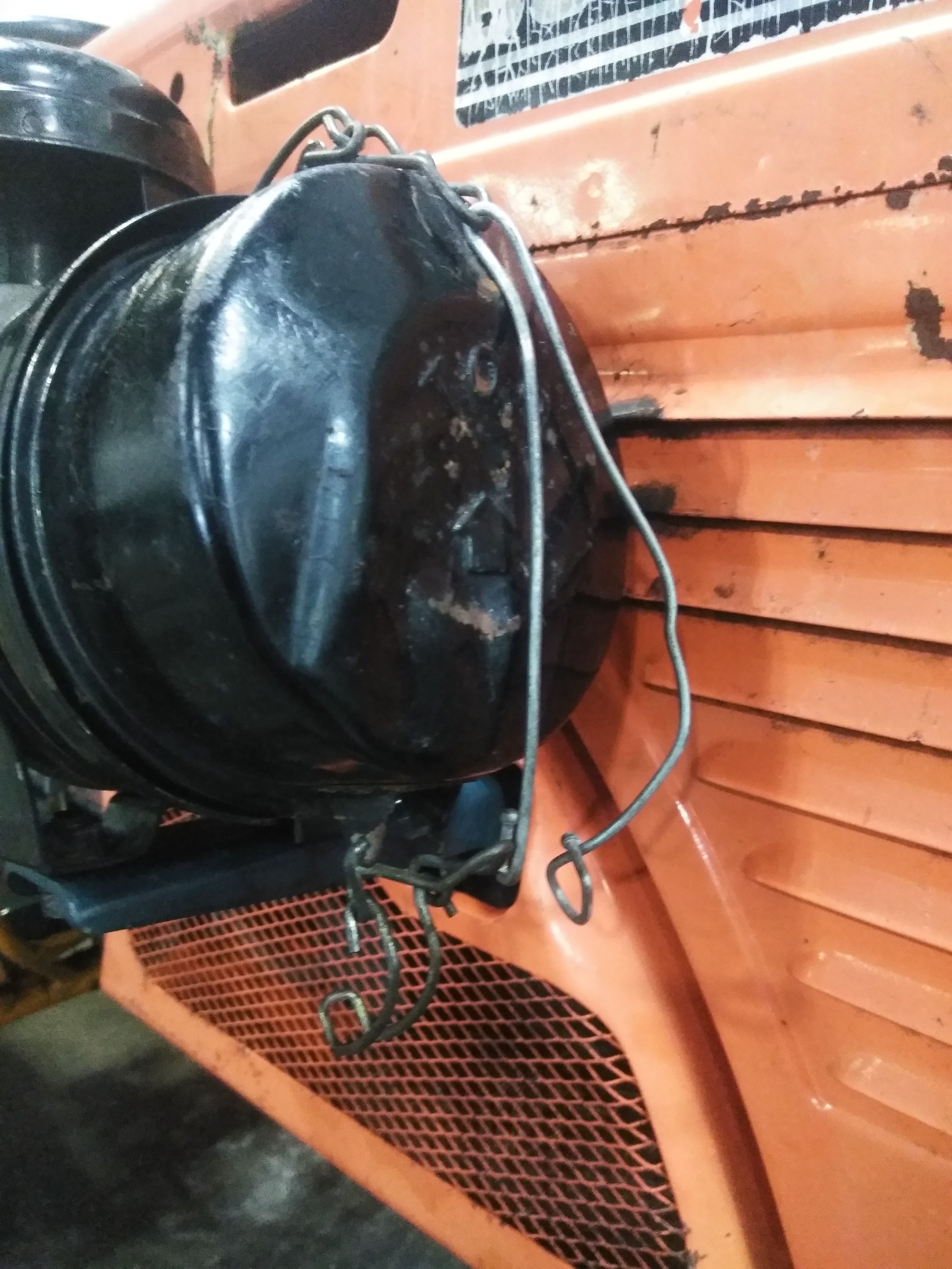

My air cleaner cap was jury rigged at one point to stay on, one of the clips apparently went missing partially.
I thought I was lucky in that the dealer is still able to supply a new cap with spring clips for 42 dollars which I have ordered just for that one spring clip but Im gonna guess now that I could have bought the clip from an aftermarket source.
Ive asked the dealer to go ahead and order for me so I cant go back, Im just wondering if someone does know of a source for an identical part?

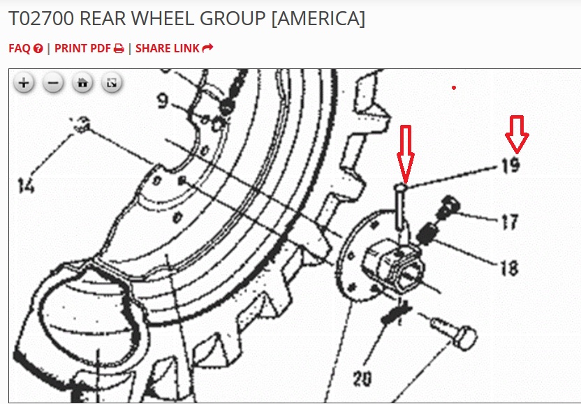

Study the portion of the Owner's manual dealing with the Hex axle.
Look at the parts illustration.
I think you are missing the pin which goes through one of 3 holes in the axle to set the track width
Part Number 66621-17160 for $6.20 from Messicks
Dave

Thanks I have the pins, one per wheel, it seems this pin ( which is all sloopy ) is what holds the wheel assy onto the axles
A standard carriage bolt will not work cause of clearance issued with the head to rim. I can modify but Id rather just buy the correct hardware. View attachment 606882View attachment 606883View attachment 606884
Suggest you look over the Lonestar Wheel Weight web site.
Any why theView attachment 606885 spring?
Are you actually tightening the bolt? (or is it stripped and just spinning?) the spring acts as sort of a lock washer and is supposed to prevent it from vibrating lose...
I suspect with the pins in place ( not all worn) and the securing bolt tightened, the wheel should be secure.
Investing $13 in two new pins would seem wise

The chances of finding OEM wheel weight bolts, for a bizarre set up like you have, is about zero. Myself I would buy long enough normal bolts, You could grind large washers to custom fit the rim, then weld it to the bolt head, and insert them from the inside of the rim. That would make it so you just have to use one wrench to remove the weights.
The pins are typically sloppy even when new. The compression bolt with the spring is what tightens the wheel to the axle. Still, that wheel fixing system wasn't the best system for holding the wheel firmly. It isn't in use on many - if any - modern tractors. And never was popular or much used on tractors much larger than yours.
It's an inexpensive way to hold the wheel on and it won't let the wheel slide along the length of the axle if the pins and their keepers were in place. But they were known to be a bit wobbly. It is what it is. There are ways to shim it to work a bit better, but if you put in the pins and tighten that bolt it will get you by.
BTW, you can buy bolts to mount those weights at any hardware store. Yes, the heads will be too big to fit. That's not a problem, simply grind the heads until they fit.

The system holding on the axle will always be sloppy and break pins. Ordinary bolts work well as a replacement. Duct tape wrapped around the hub will hold the pin pieces in place when they break keeping the wheels in place on the axle. Trying shims helps abit but they will quickly wear out. Kubota has a replacement hub for these type of hold downs.
/ A few more questions B6100 E #13
A lot of those old style hubs broke the safety retaining pins when the compression bolt with the spring either came loose or was lost. Then the hub would wobble on the axle and break the pins. We now know that whole hub wasn't a very good design, endless adjustment and trouble. It just wasn't up to handling the forces a tractor puts on the hub.
A diligent person can make it functional by fitting things carefully, but replacement with an upgraded type of hub to axle fixation would sure be a better answer. Still, if the compression bolt and spring are still there and with good enough threads to tighten down well.... plus pins or bolts as you say - then he could get by for awhile.
