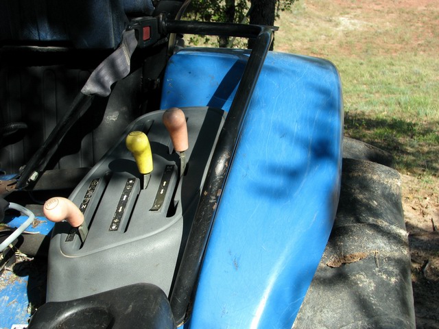

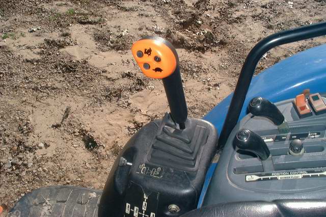

The only option you can add to your tractor is the toolbox with the cupholder on top. That actually sits on the left side operator's platform and bolts up to to the left fender well. The indentions on top of the fenders are for the Deluxe (TC40DA) model tractors. On these consoles you have all your levers and switches needed for the HST transmission models. You would gain nothing by having these consoles. See the photos attached of my tractor with these consoles.

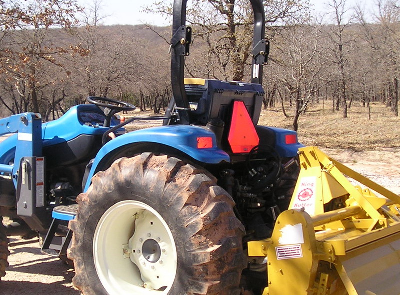

I think the safest place to mount a chainsaw is the area between the ROPS and right behind the operator's seat. That is the most protected area and gives you easy access from on the tractor or off the tractor. Several people have mounted a toolbox there. I had one there, but removed it because it was too big and obstructed my view of the 3PH area. I think a bracket and mounting a chainsaw there would be fine. The third picture below is my toolbox before I removed it. You can see it's a monster. I used u-bolts to attach it to the ROPS. If was very secure, but I just couldn't see over it from the seat.

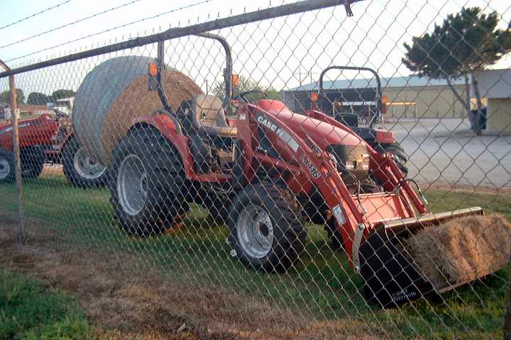

Here is a photo of the Case equivalent of our New Hollands. It is essentially the same tractor as yours. This round bale was on the 3PH for about 2 weeks and never dropped. Your arms should not drop also. You have a leak in your lift cylinder or the HPL valve that controls the 3PH is leaking. Sorry to give you the bad news, but you need a repair. The good part is that this is a relatively simple job, especially on a TC40A model.

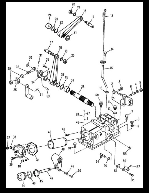

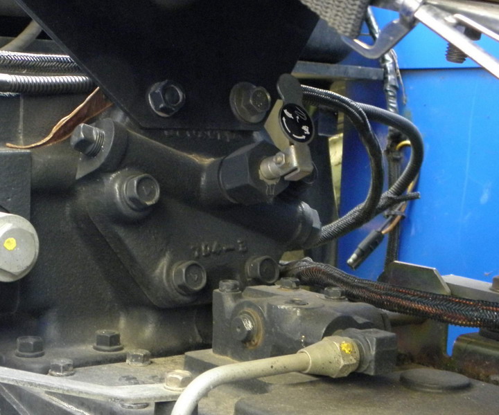

To determine what is bad, with the engine running, lift the 3PH all the way to the top with some weight on it (boxblade, cutter, etc). When the lift gets to the top, close the drop speed control valve under the seat. It's a metal lever with a rabbit and turtle on it (see photo below). Turn it all the way towards turtle. Now, shut off the engine. If the lift drops, it is the cylinder seals that need replaced. If the lift does not drop, it is the HPL valve or something else. Don't forget to return the drop speed control back to where it was before ending this test.
As far as cost, if you do the job yourself, this will probably be less than $50 to repair. You will have to buy a gasket and two piston seals (items 41, 45, 46 below). The piston itself is item 44. When you remove the cover as seen in the photo, you will have access to the piston. Of course, if you have to repair the HPL valve, that would be much more expensive. The great thng is if you have this done at a dealer, it will also be fairly inexpensive. If you are not sure of yourself on this repair, that's what I'd recommend.
