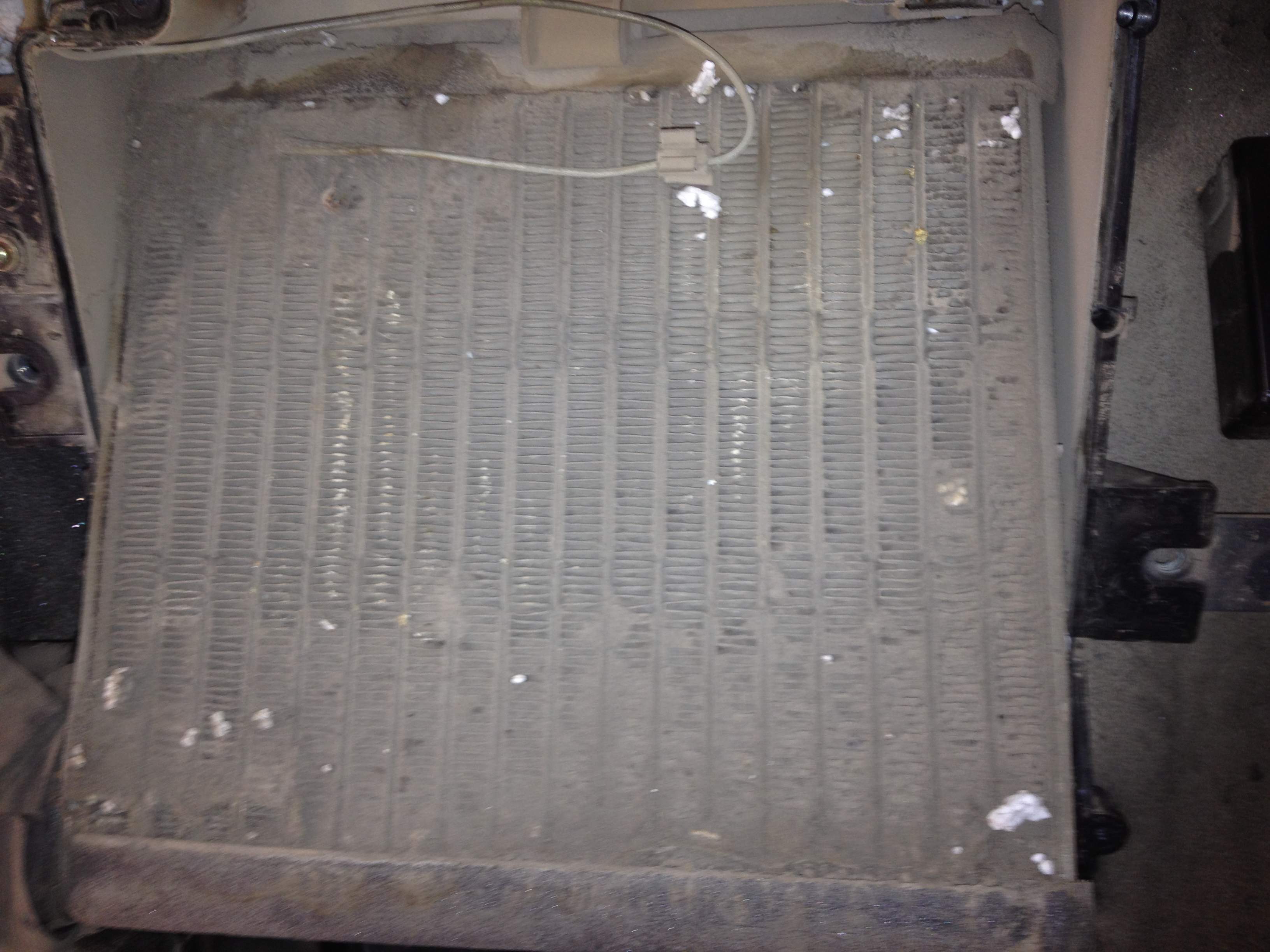

I have a Kubota L4610 ac is not working fan is blowing,compressor clutch is working. Have put freon with tracer in shows no leaks. haven't ck the cab. How do you get it off

I'll bet the filter,condenser &/or evaporator is stopped up with dirt/chaff. To access evaporator one needs to remove cab roof and then remove an access cover to see evaporator.

I'm not familiar with your tractor, but my M6800 had a similar problem. It would blow only a small volume of cool air from the ducts.
First check the radiator and if you have one the transmission cooler. make sure they are very clean. If not it will not cool and tractor will run hot and AC will not work correctly. If you have a good volume of air from the interior AC ducts in cab, the evaporator is likely not stopped up and the problem is elsewhere.
Second go to Messick's Tractor web page and download the parts diagram for the cab and HVAC and what other areas you might need.
This will give you an idea of where things, are and what is needed to open the cab roof. There are 4 to 6 bolts that need to be removed at the edge of the cab interior. Once these are removed the top lifts off. There is a gasket between the top and bottom of the roof and it may be stuck. Try to not damage it as you remove the top. Once the top is off, you can see the HVAC unit. There will be wiring, controls, bolts and snap plugs that have to be removed to open the AC unit. Take photos so you know how all wiring and controls are placed so you can reassemble them correctly. Buy a can of radiator cleaner and have a water hose nearby to wash it off after its applied. Be careful you do not puncture the radiator/evaporator while cleaning it. Be sure to open any stopped up drain holes/hoses from AC unit, so it will drain properly. Good Luck!
I'm attempting to insert a photo of my evaporator prior to its being cleaned.
